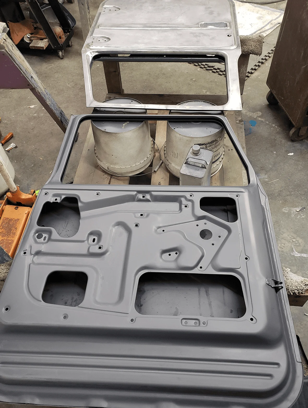

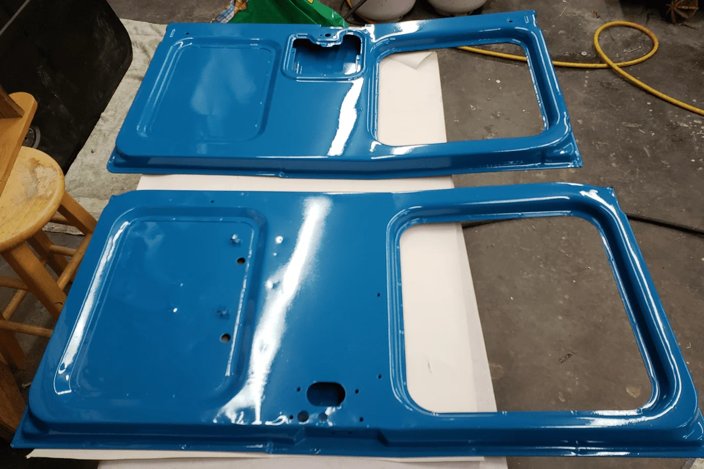

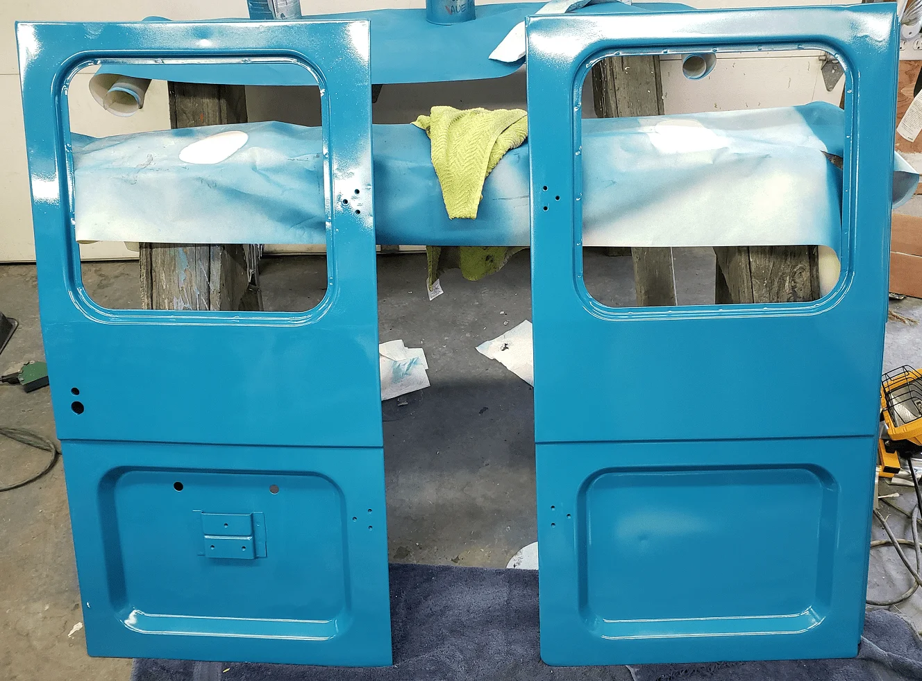

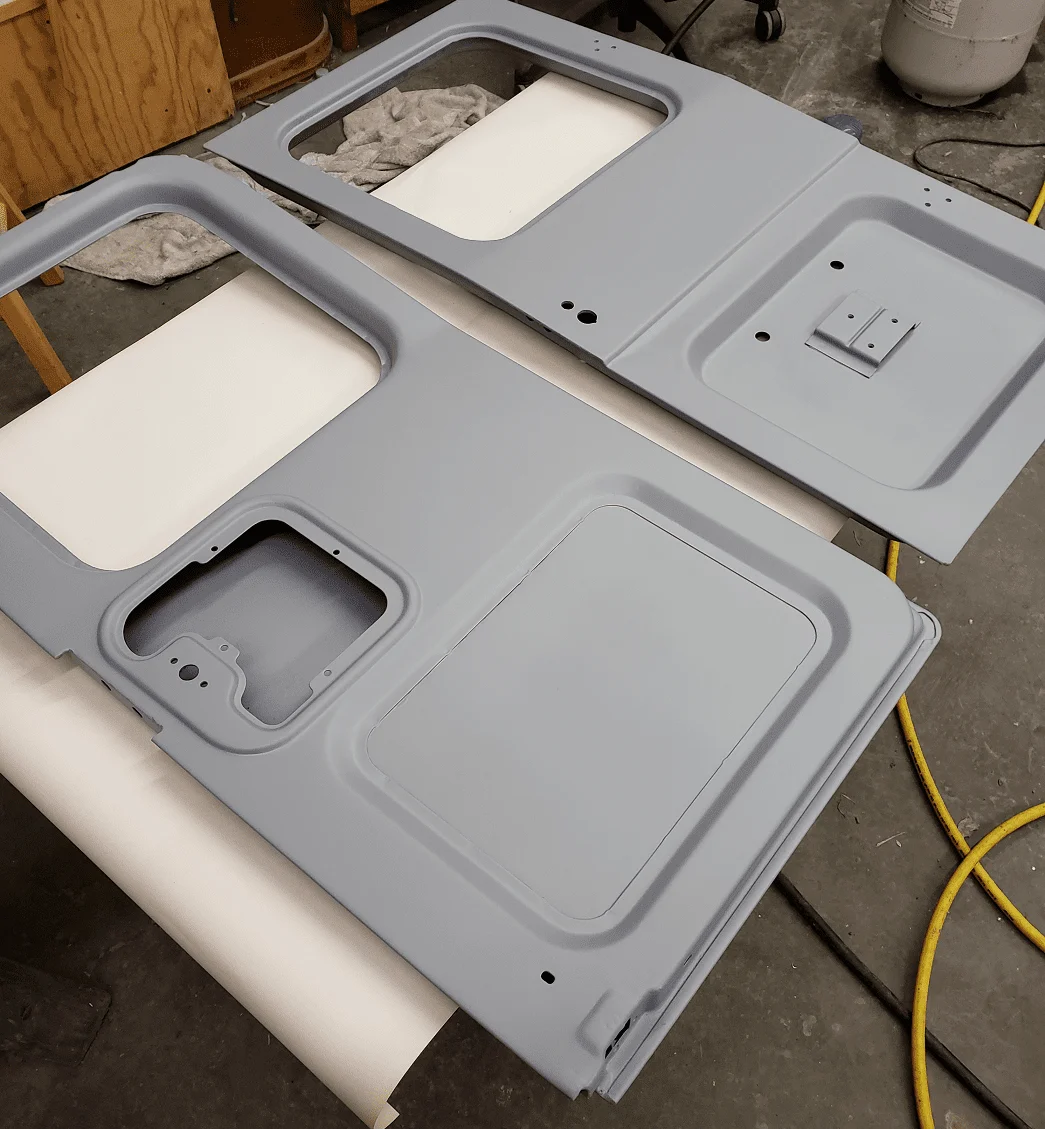

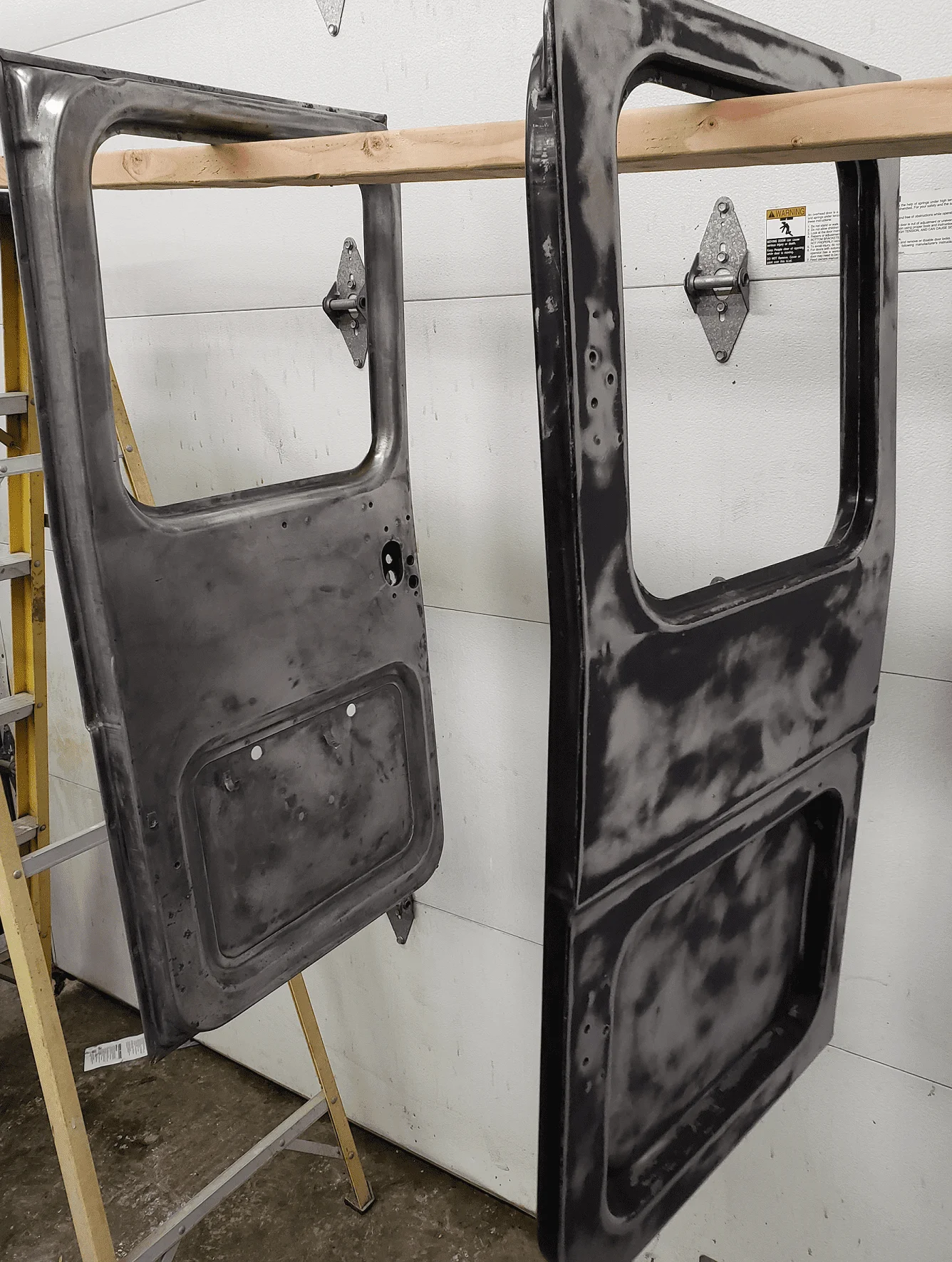

The back ambulance doors are ready for primer and paint.
My air compressor is from home depot or lowes about 15 years ago, I don't remember, and is a 60 gallon tank with a 10.3 scfm @90 psi single stage compressor. It won't keep up with continuous use of a DA but painting isn't an issue.
Gun is a hvlp gun from eastwood, a 'finish line' brand IIRC and is an ok gun. I do have a siphon gun and a uber cheap harbor freight hvlp gun, both of which are basically useless. I use disposable paint cups I found at HF which makes clean up much easier.
I try to keep my tank drained daily but the drop or two I might get I run thru a inline paper disposable dryer filter. Seems to work ok.
All in all though, I consider my painting skills more utilitarian than, umm, prize winning.

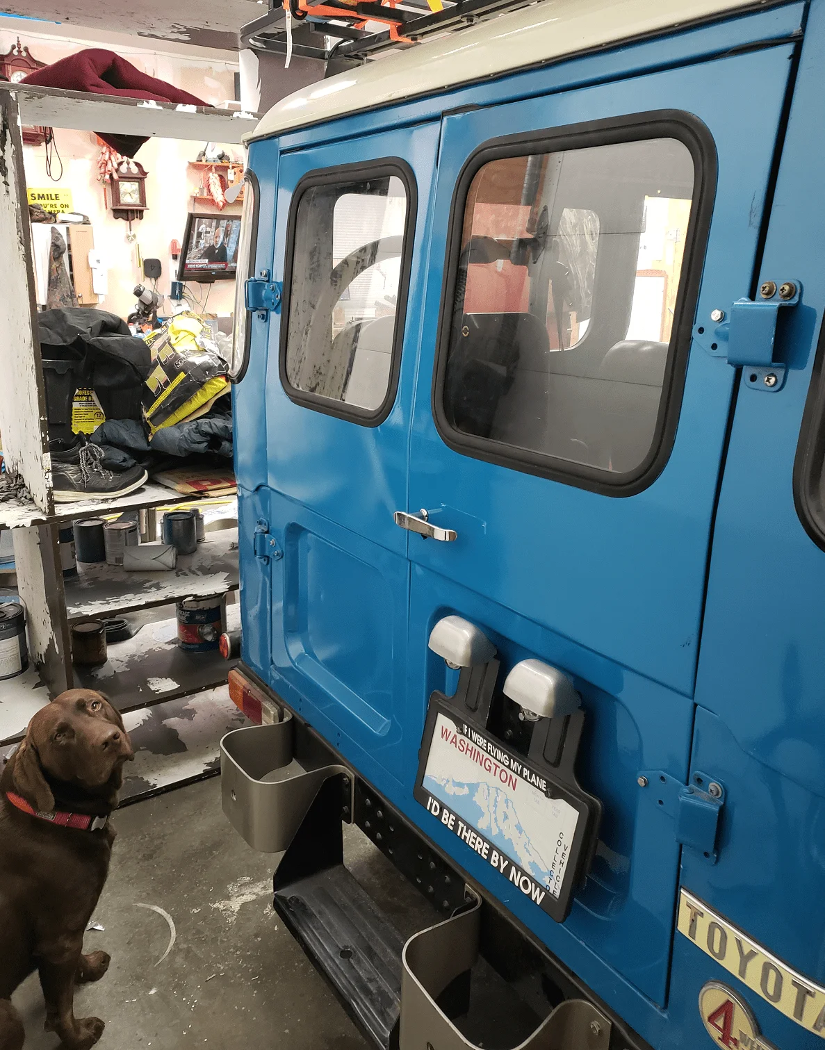

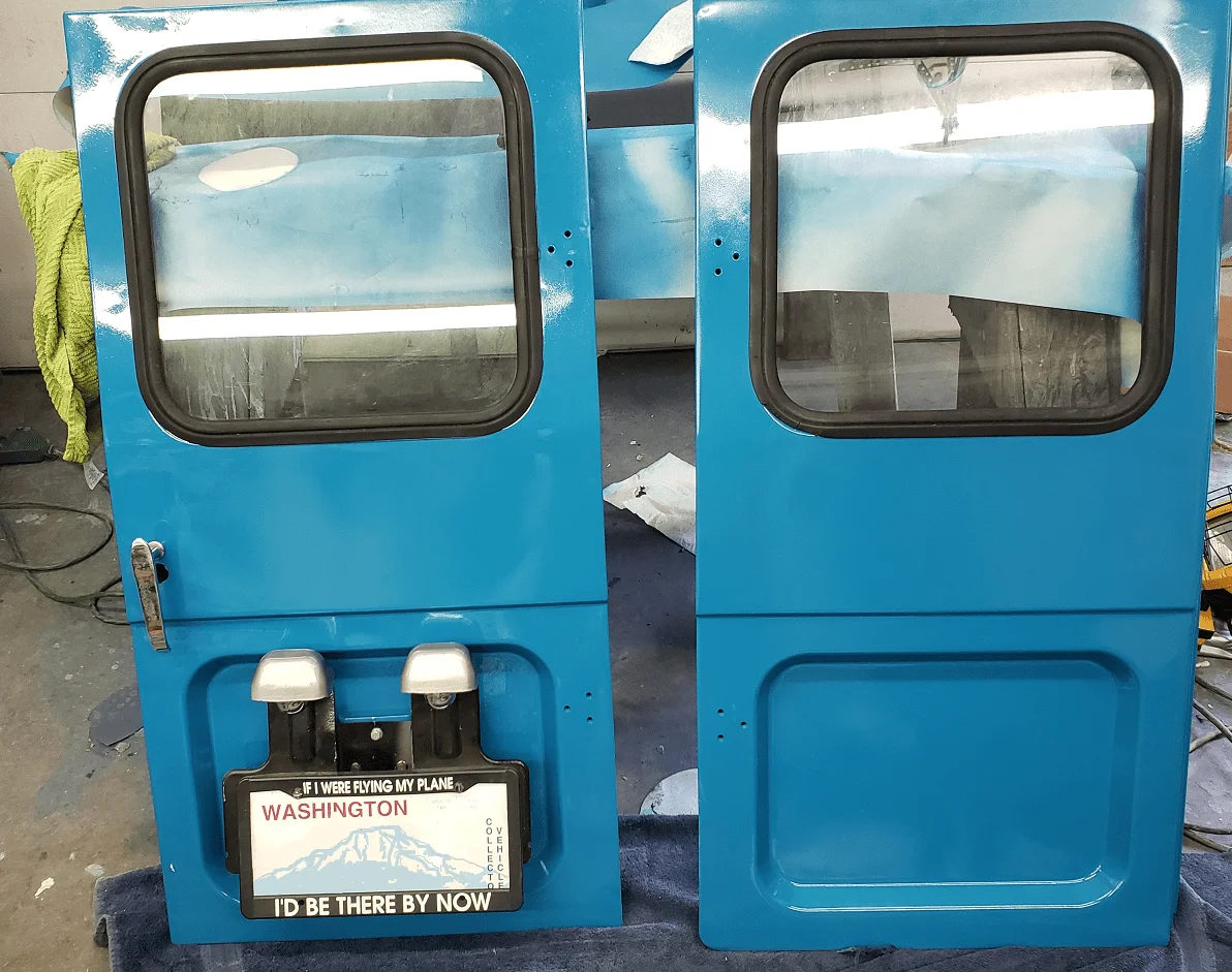

Painting on the back doors is done and I've started to reassemble. I have some stainless steel fasteners and I am trying to decide if I want to paint them or let them be shiny.
I am reusing the window weather stripping but I have all new stuff for the seals.

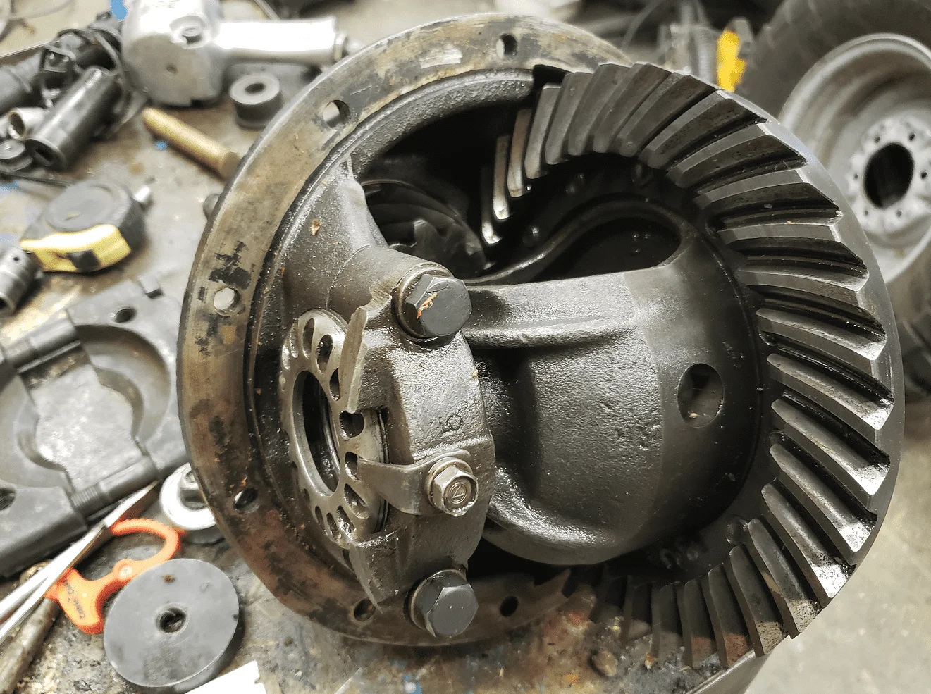

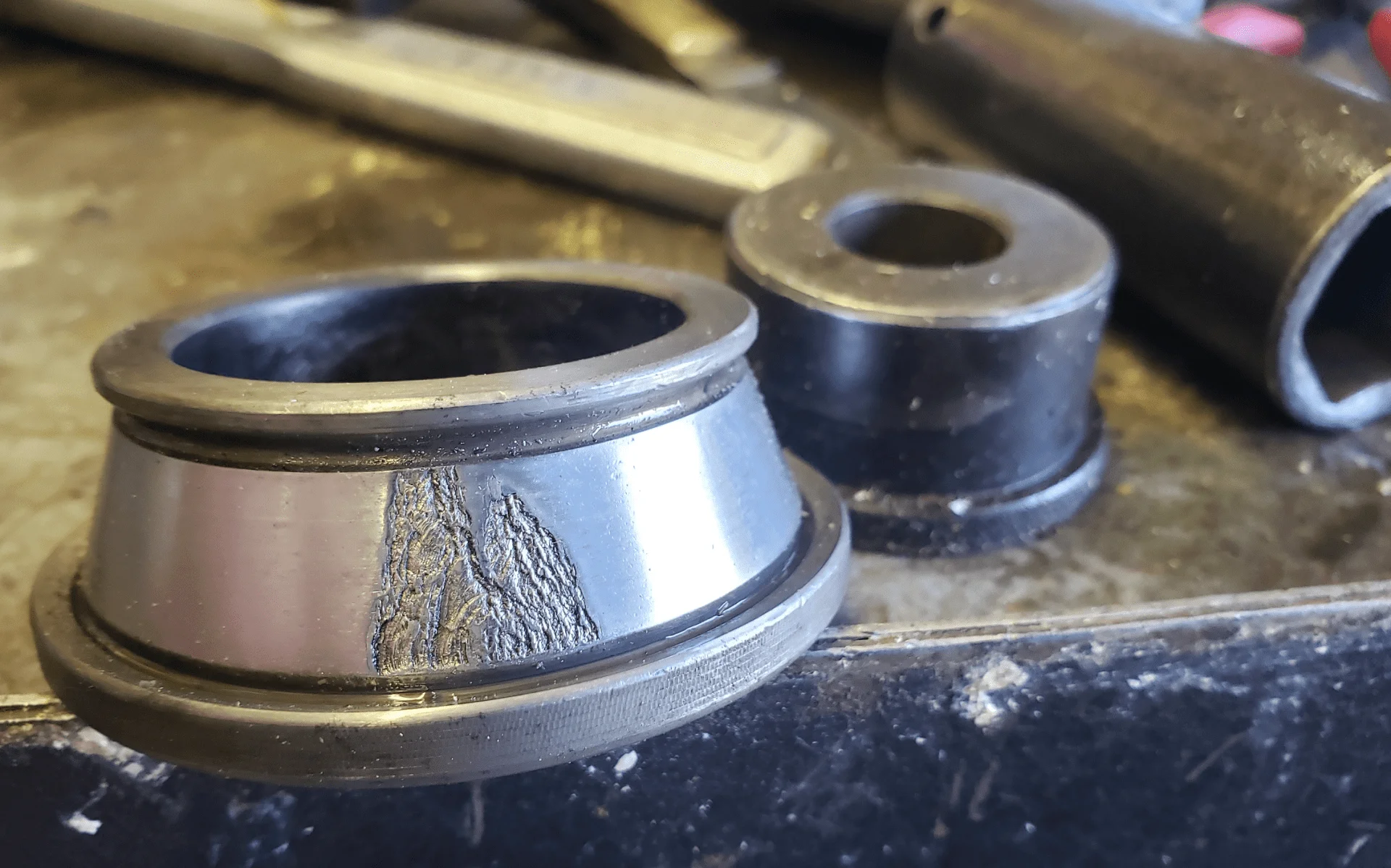

To paraphrase Winnie the Pooh, its had a growing rumbly in it's tumbly, to be specific, a loud whine only while under power above 35 mph. I replaced the axle bearings at the start of my rebuild but not the pinion and ring bearings. The troubleshooting matrix says a probably ring to pinion misalignment.
When I cut the larger inner pinion bearing's cage off, I think I found the issue.
