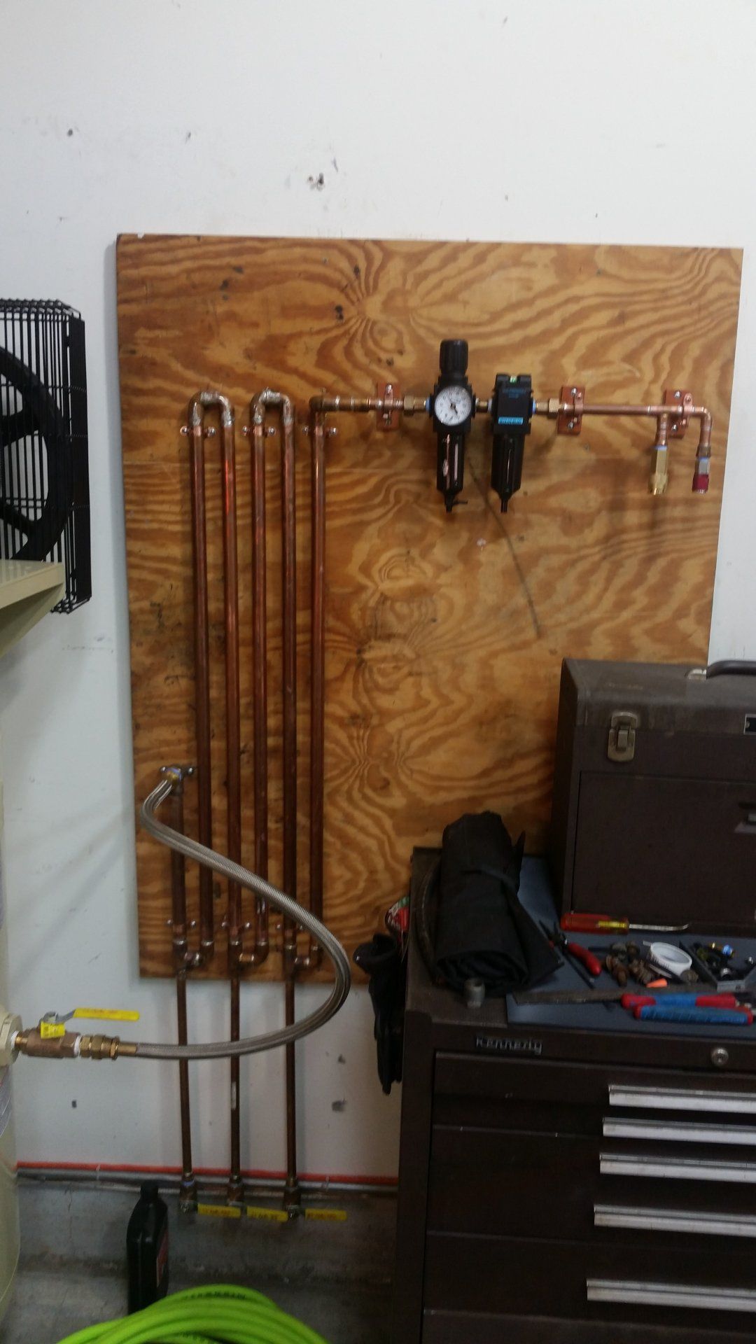

I’ve got an air dryer setup similar to the one posted above - I’ll try to snap some pictures of it tomorrow. Basically several drip legs with valves at the bottom to drain each leg, and a final filter/water trap. It keeps things dry enough for me tools, even in humid MD, but if I was going to paint, I’d probably add a large desiccant filter as well.
