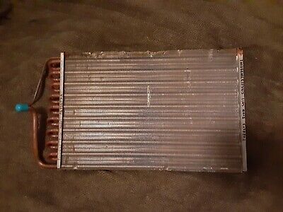

For $32, I would imagine that this is way more effective than any amount of tubing could dream of being, and it doesn’t take up wall space. Just put a small collection tank after it for the air to stagnate in and let the water fall out. (As someone sharing a 2 car garage with 3 other guys, that’s kind of an issue)
