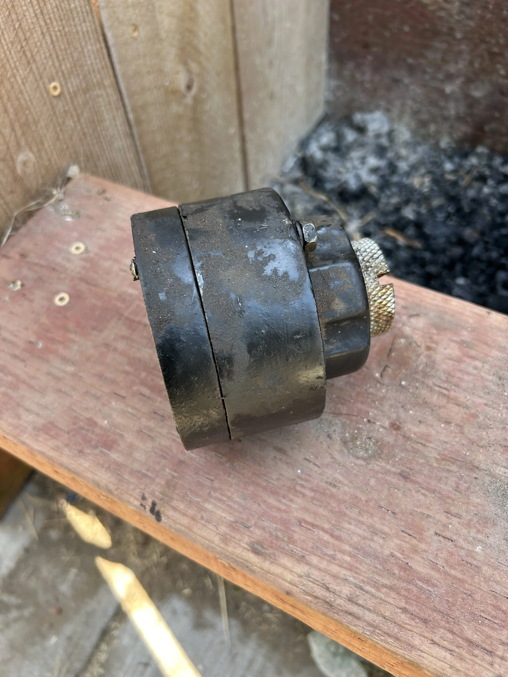

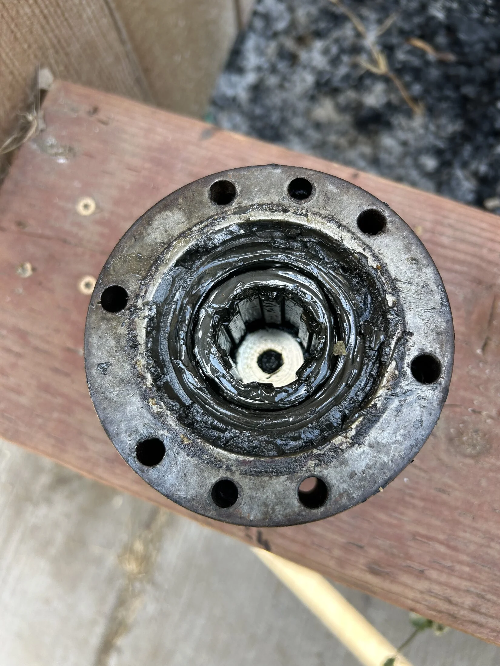

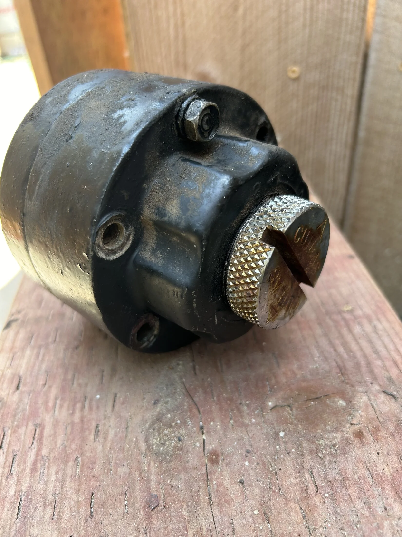

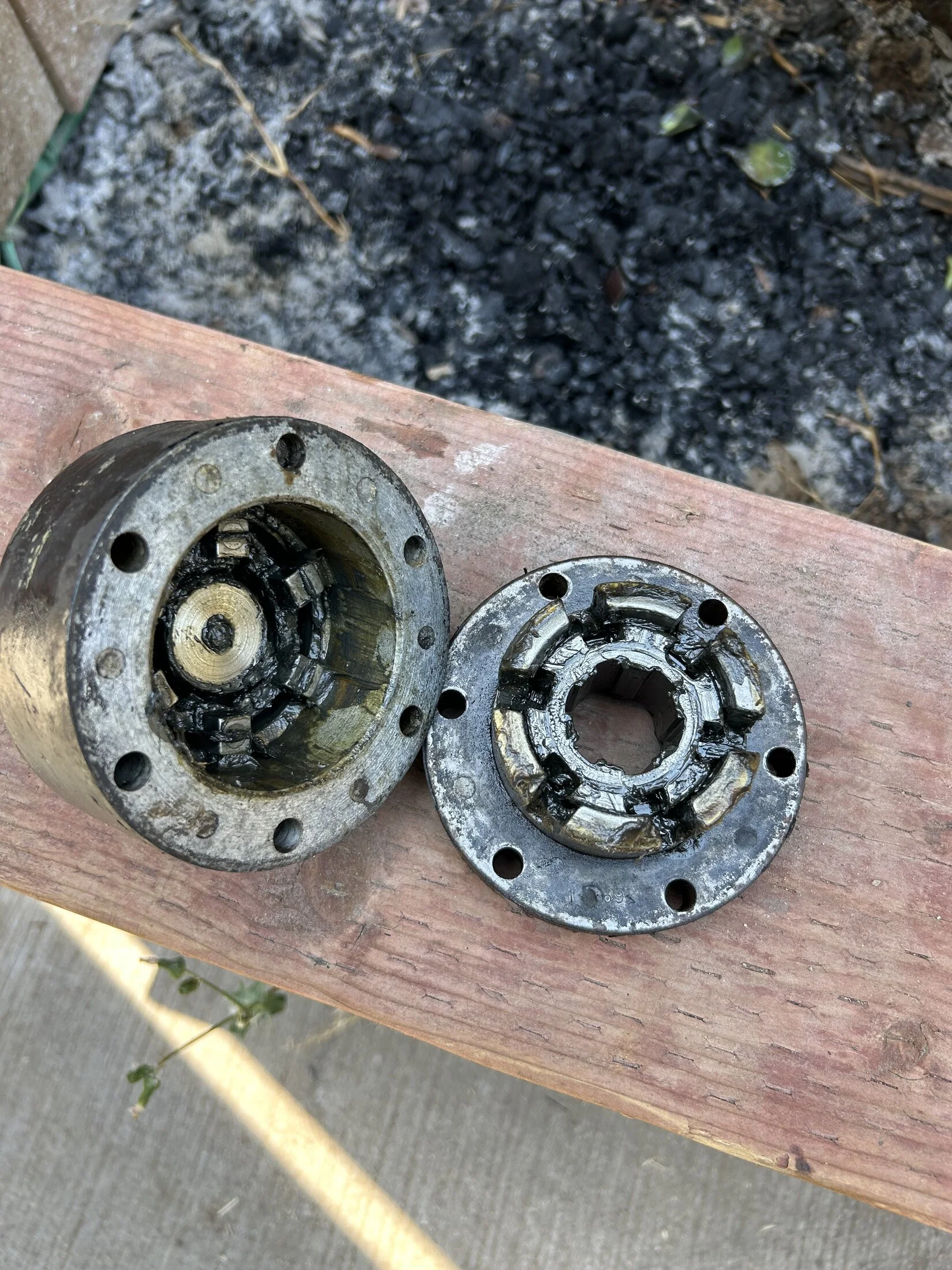

This is what I am replacing with the city racer version. It was mounted by long bolts.

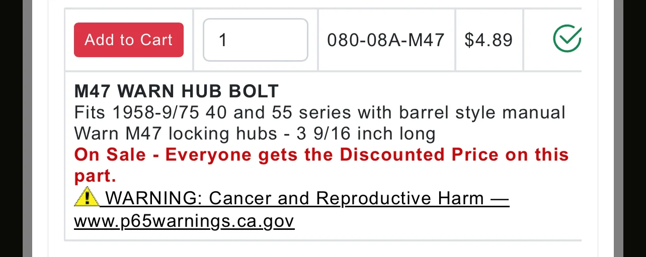

Correct me if I’m wrong but the city racer version I linked is a “barrel” or warn style locking hub?
Which would use this bolt?
You could probably use that bolt, probably been done before. Not everyone loves cone washers like I do.

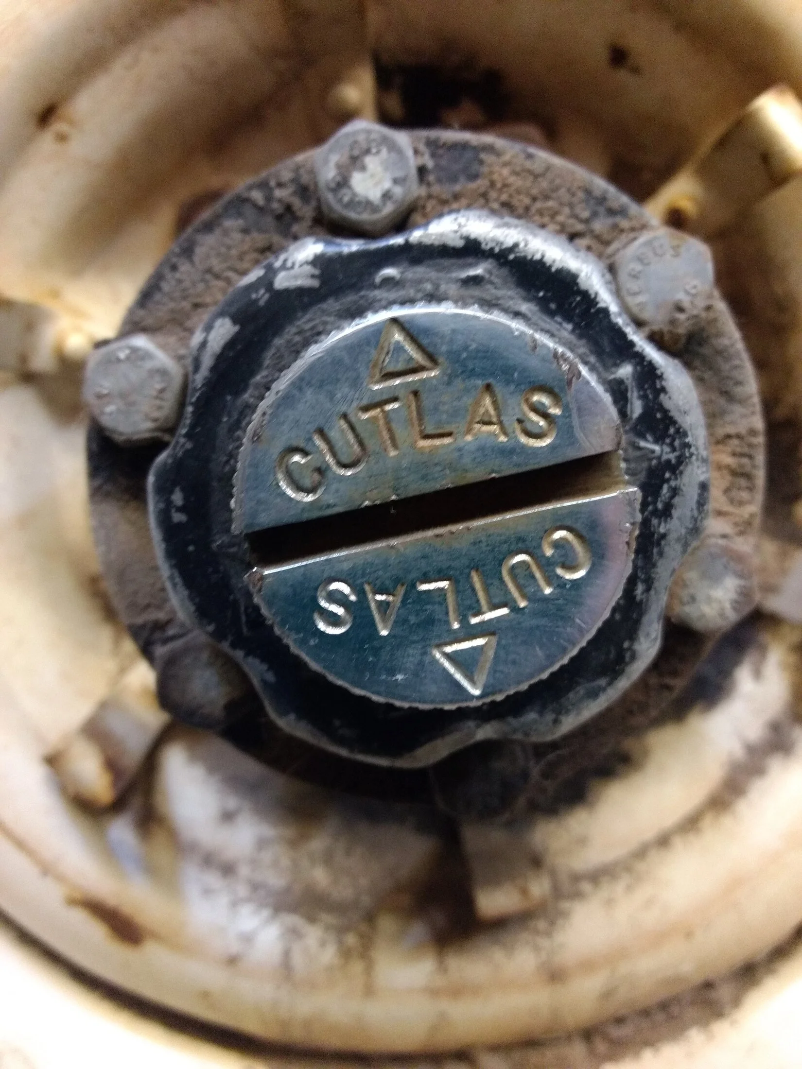

Hmmm...they look very similar to the factory hubs. i thought the knob was a PO mod because the original knobs that came on mine did not work very well.
I stand corrected.
