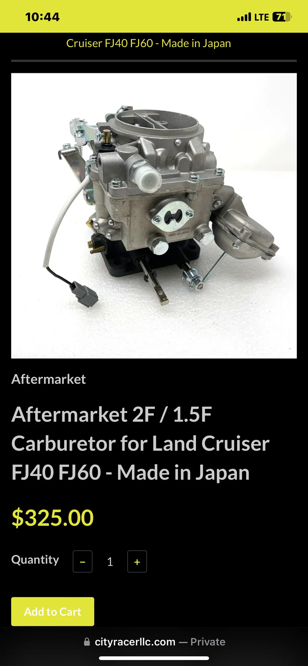

Thinking about buying this carb instead of dealing with my carb that has been sitting in a box 10+ years. That’s how I bought the truck. I have read it’s a good carb. Just wanted to see if I need anything else with it or will it just bolt right up and adjust? Engine has not run in 10+ years and will get a new fuel tank also.
Good carb. Bolts right on assuming you bought the right version for your application. It'll run right out of the box, but you'll want to tweak your idle and mixture, adjust timing, etc.

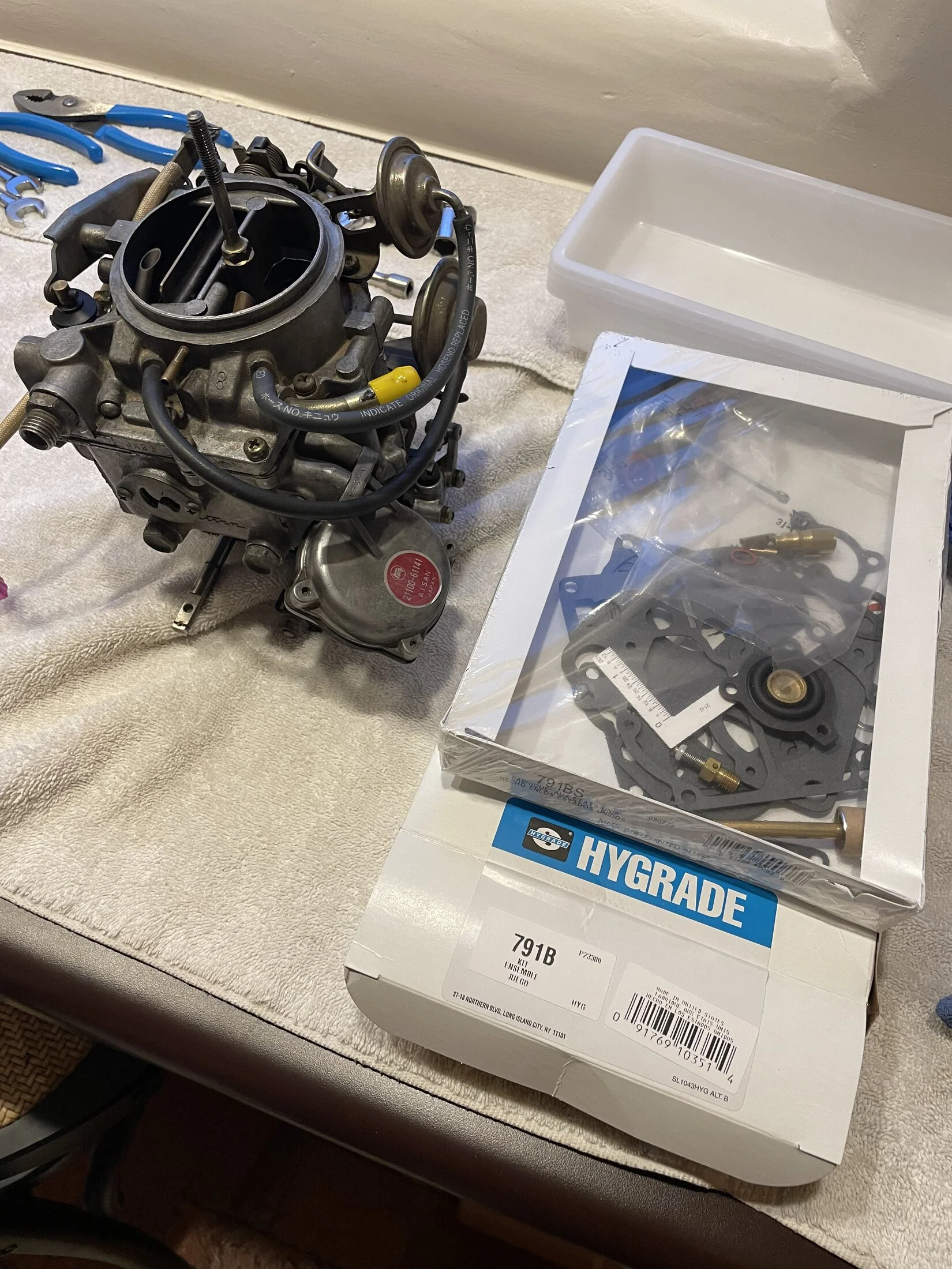

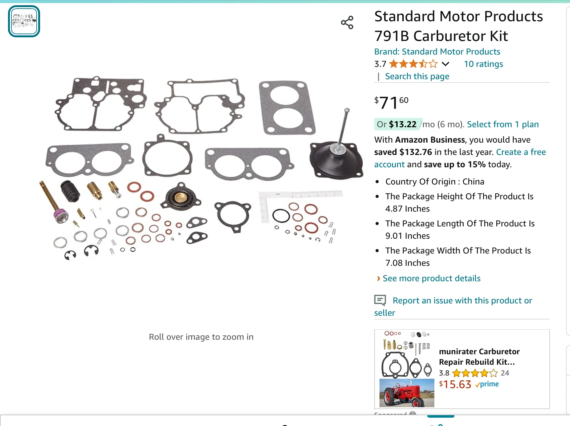

I couldn’t get a complete OEM kit. There are other kits out there. Cruiser Outfitters sells one. But I found this one to be most complete, no replacement jets, but it worked perfectly on this 1983 carb. I believe it’s the same manufacturer of the kit featured in the famous PinHead videos?
Seems reasonable priced.

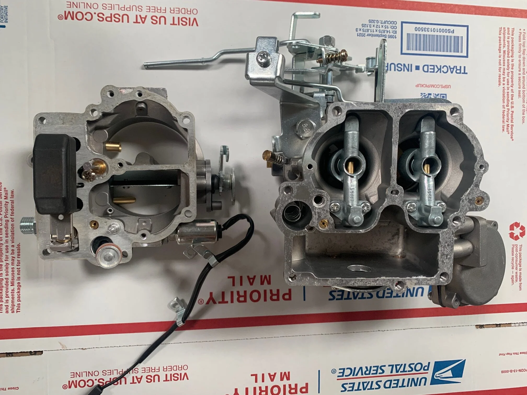

Great advice. One of the challenges of selling carburetors is that some buyers don't see it as part of a system. They just drop it in; if the car doesn't run right, they point to the carb as defective. The root cause can in fact be any number of things, such as a dirty tank, vacuum leaks or even an issue with the ignition system.
One thing you can safely rule out is the factory having left some debris or metal shavings in the passageways. The inside of a new Fuji carb is always squeaky clean:
