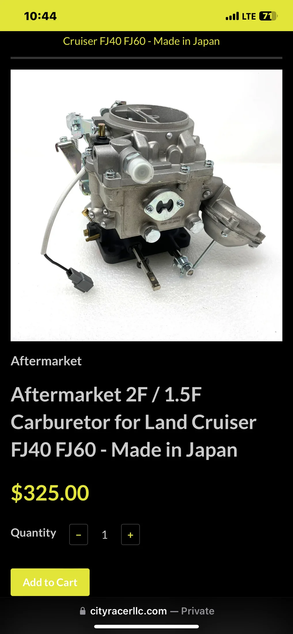

Thinking about buying this carb instead of dealing with my carb that has been sitting in a box 10+ years. That’s how I bought the truck. I have read it’s a good carb. Just wanted to see if I need anything else with it or will it just bolt right up and adjust? Engine has not run in 10+ years and will get a new fuel tank also.
Hey Fj80Oregon, did you end up going with the city racer carb. The one I order for my 84’ 60 showed up today. Before I installed it, I figured I would comb threads. Being an 84’ I don’t think I need it do anything with linkage. I’m disappointed to hear others have had issues.
I Did not.
You can still buy a new desmogged Toyota carbs, part No. 21100-61012
Installed one on my 60 with no regrets, 16,000 miles within 13 months of usage, still running perfectly.
Hey @carlosfj80 did you end up installing the carb? Did you end up having issues? How's it working? I'm trying do decide which route I should go, Weber 38/38 or City racer.
I did use it. It’s been running great after some tuning and allowing it to warm up for 5-10 minutes depending on the day. I would follow their instructions and install the bigger jets prior to install. When I do pull it, I will install the larger stock jets.
