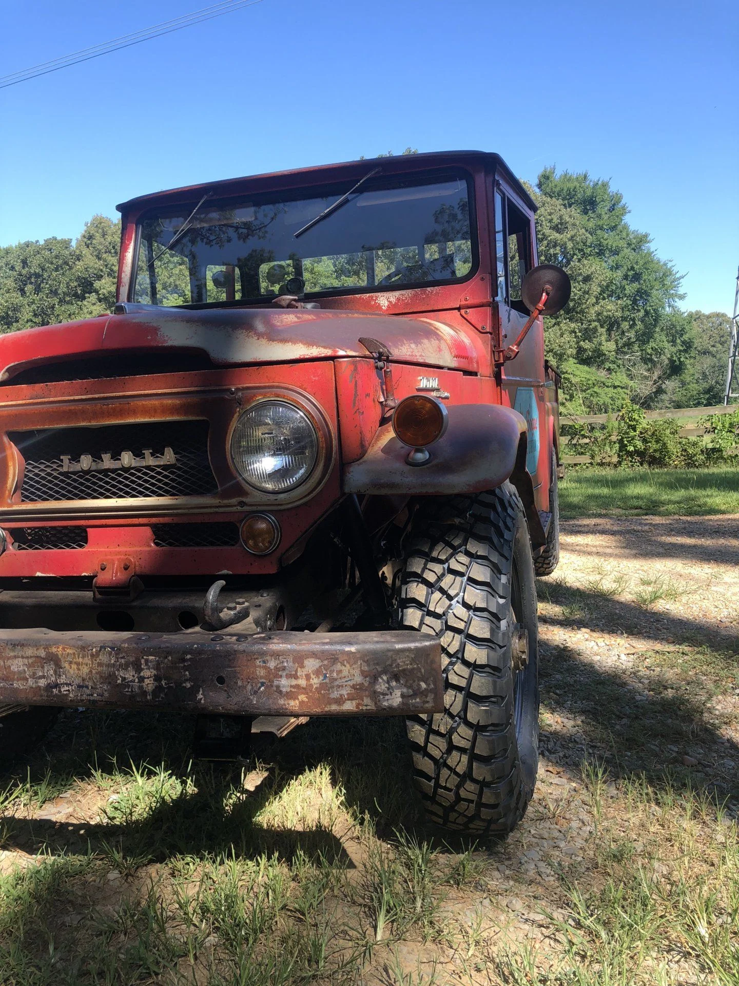

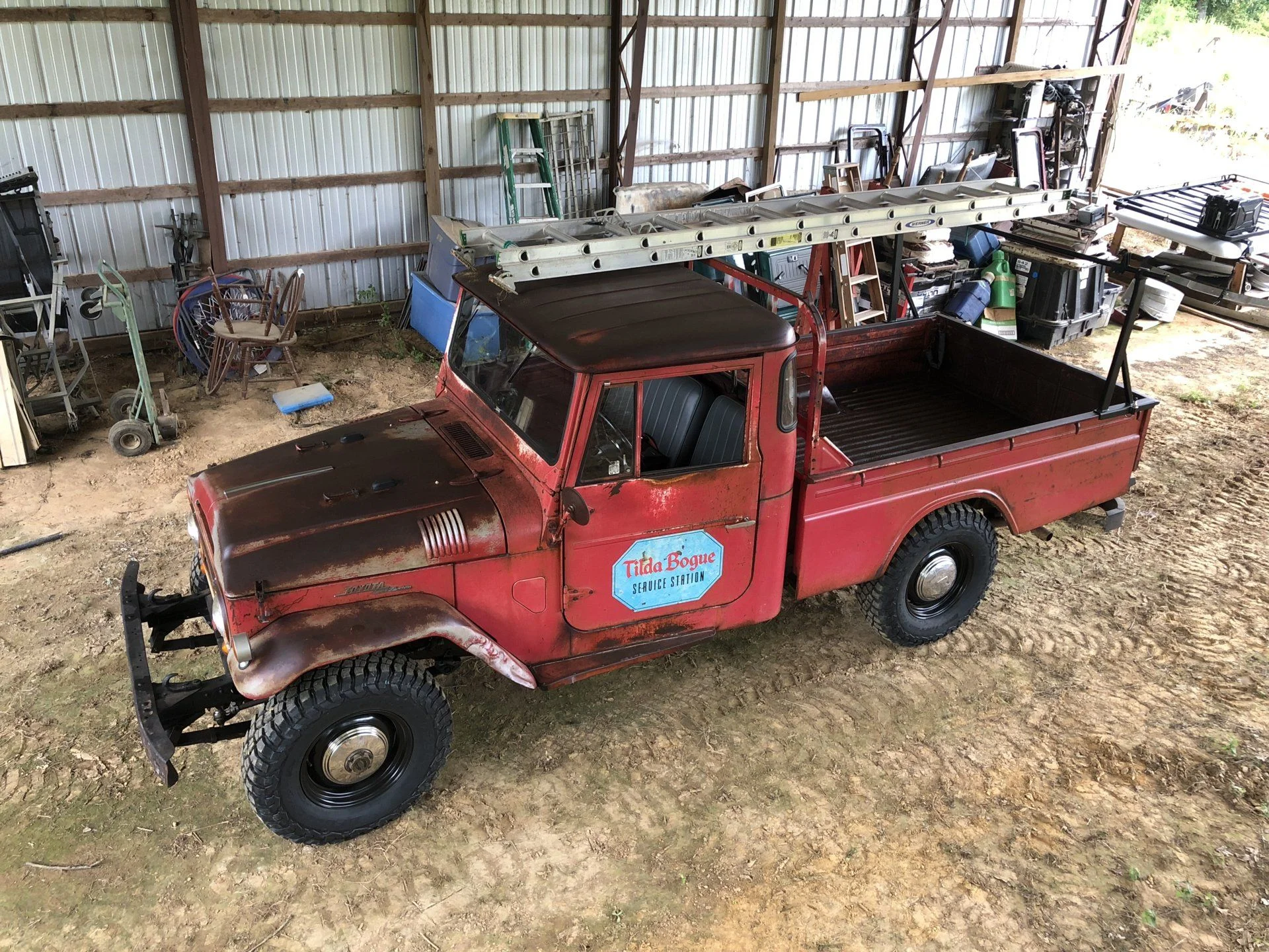

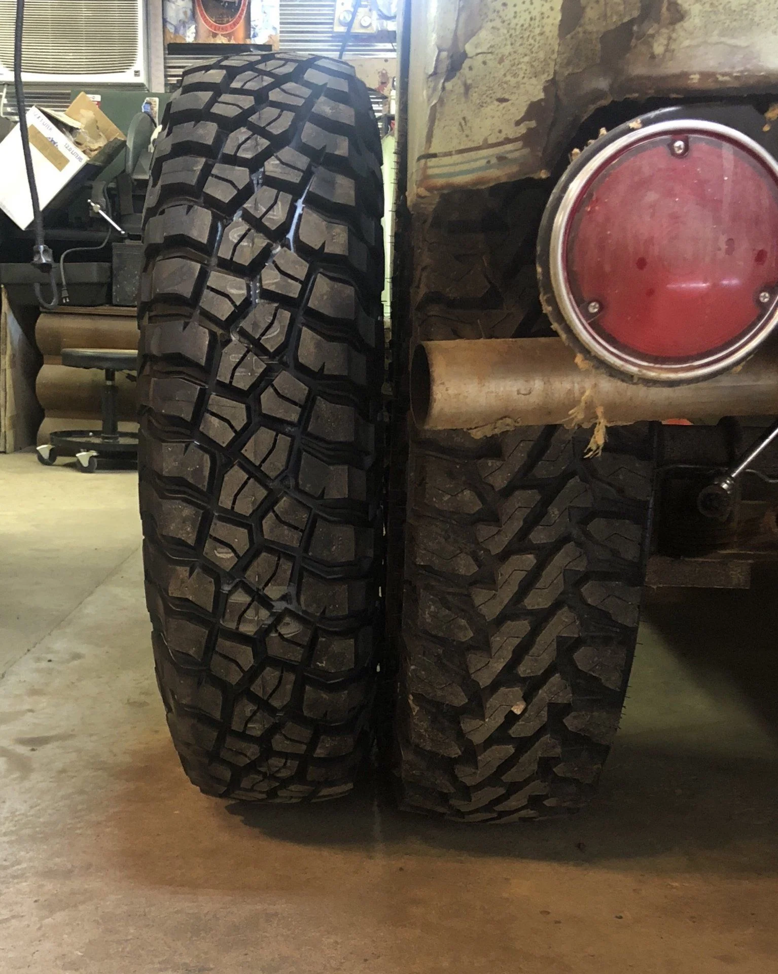

Keeping with the City Racer theme in this thread, for comparison I also now have the BFG KM3 equivalent for my FJ45
BFG decided to release their tire in a 750r-16 variant.
I was expecting it to be bigger than their 235/85-16 KO2 but was not expecting it to be as big as the Yokohama’s.
They are very close to the Yokohama’s in dimension
15” to hub center from ground
8.5” wide but the contact patch is about 7”....the Yokohama thread comes out further for what it’s worth
They fit just fine with no rubbing on my throughly hammered 51 year old FJ45 Springs.
Nice and narrow so the truck still steers and tracks excellent
Looking forward to a long term comparison.

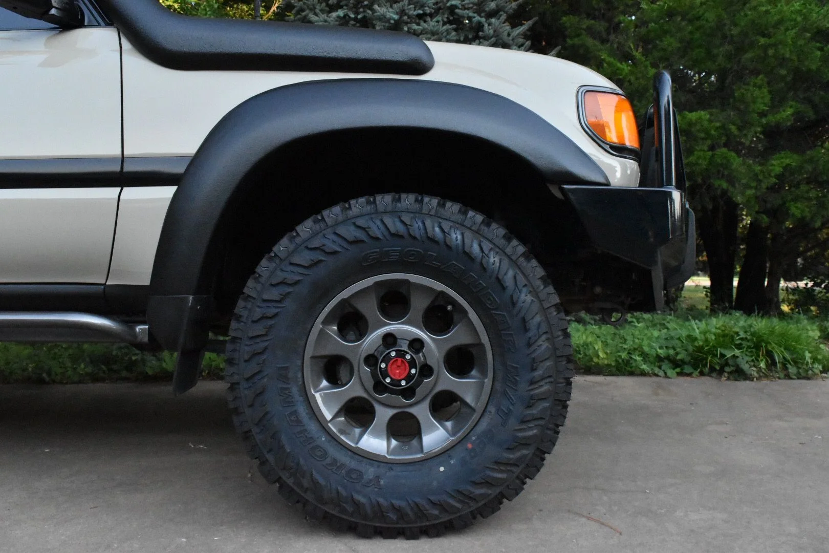

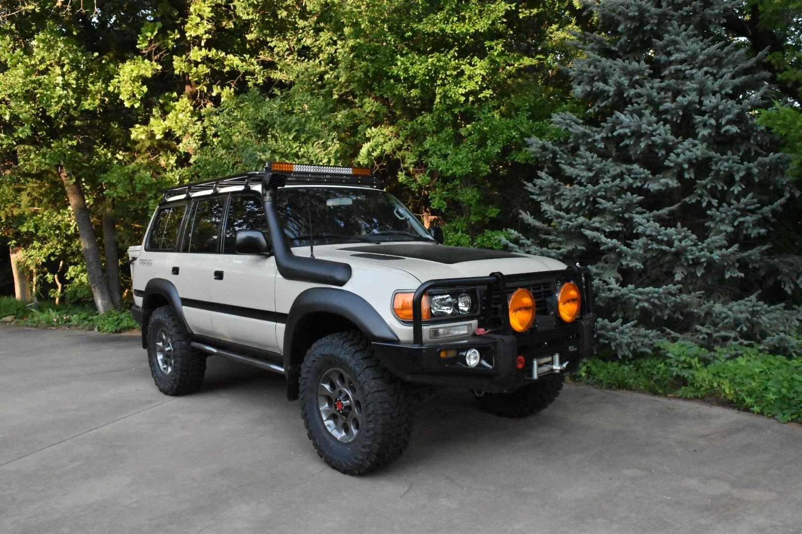

I just put the Yokohamas on my cruiser after hearing about them and then stumbling onto this thread.
In the short distance I have driven them, they have been very quiet and smooth. I’m leaving for a 600 mile round trip to Arkansas today for the weekend and then out to Colorado on Monday so I will quickly be getting some miles on these.
My previous set of tires, Kenda Klevers (stay away), didn’t seem loud or rough, but it’s night and day with these new Yokohamas. The Kendas also had a lot of chunking and cracking going on along with some internal sidewall damage so it will be interesting to see how these Yokohamas hold up. I would expect the rubber used in these to be much nicer than the Kendas.

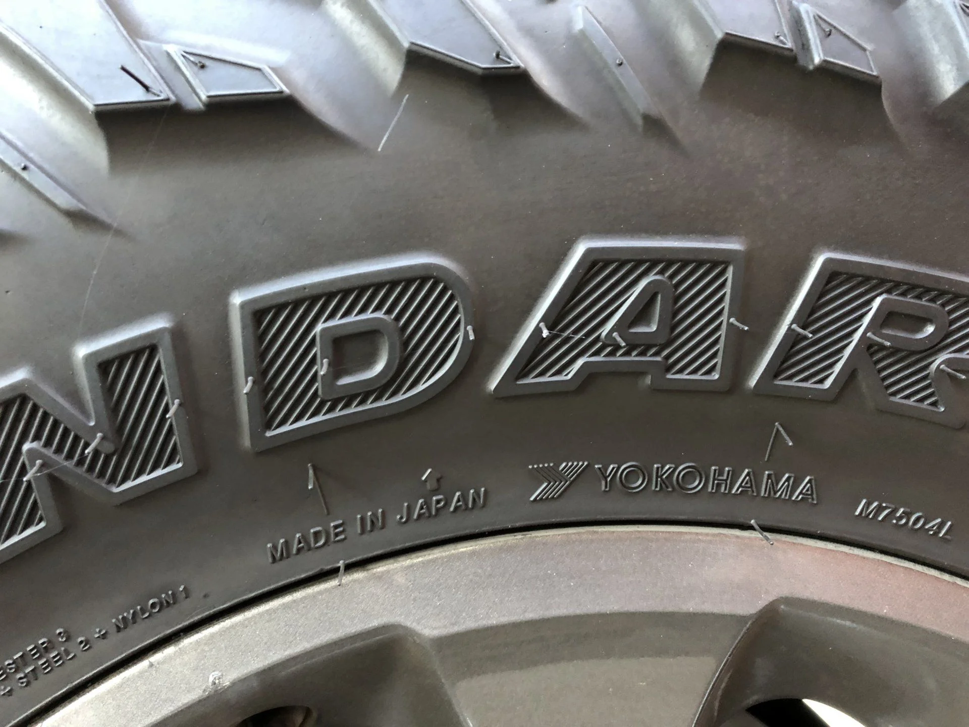

Sorry for the massive delay, but I just measured the top tread cross section of my 35x12.5r17 on a 7.5” rim. From outside of lug to outside of lug, the max width is 10.5”.
Side note, while rotating I caught myself reading the tires and saw that they were made in Japan. I didn’t know that and thought that was interesting.
With nearly 4K miles on them, a lot highway but several hundred alone of rocks and gravel, they’re a little scarred up but nothing deep. Just superficial little spots.
