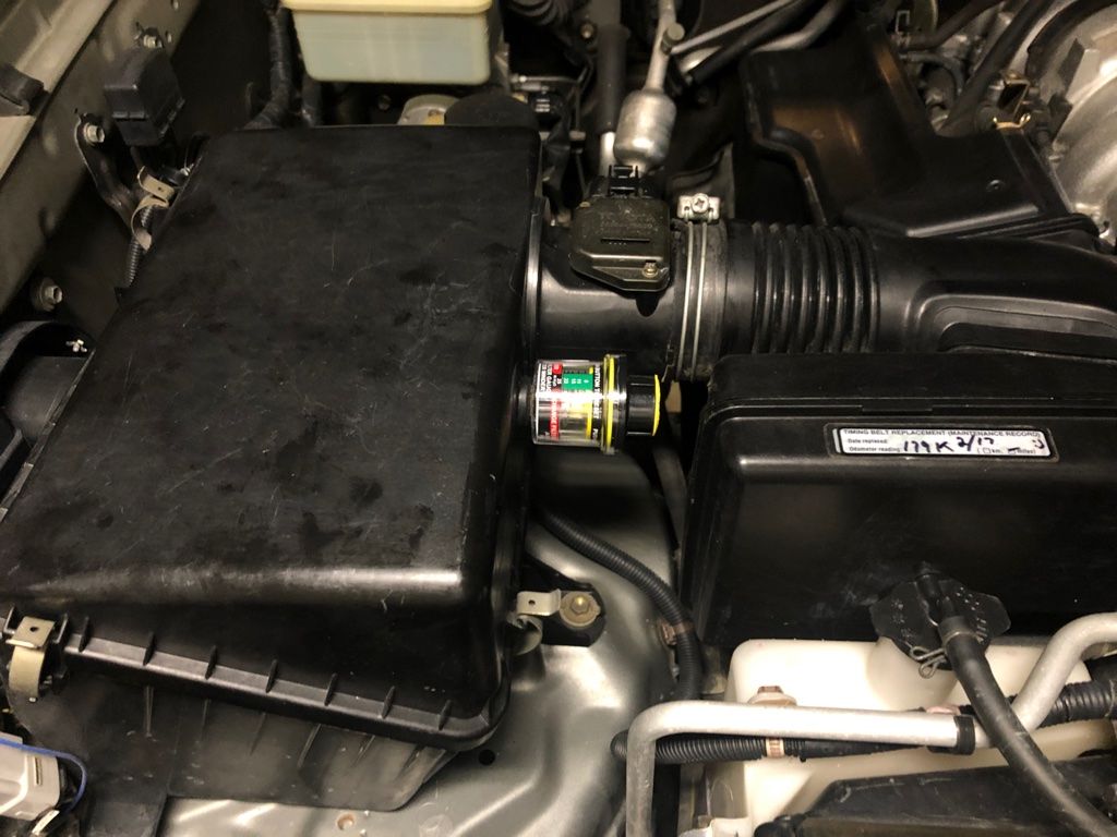

Got a Wix air filter monitor installed inspired by @spressomon and @gaijin. Have a new air filter and don't do much Mad Max sort of driving, so not really sure it's telling me much yet.

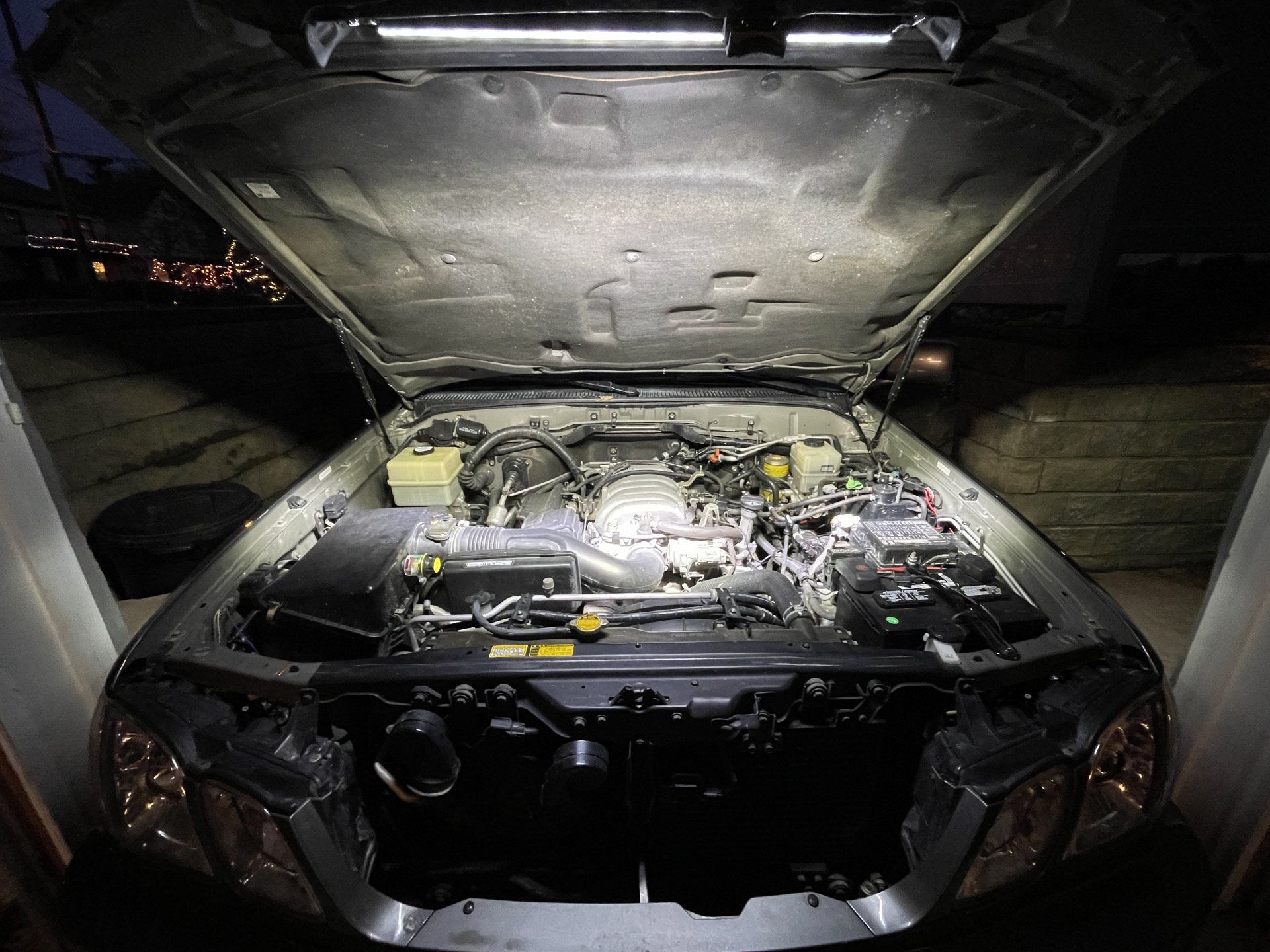

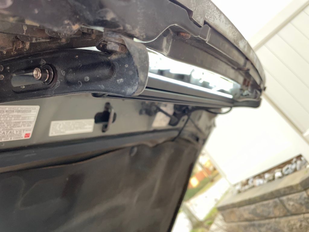

My buddy also helped me install a light bar behind the grill. It fits perfectly in the slotted parts of the grille supports on the LX. Since the grille goes up with the hood, we also were able to make it swivel and function as an underhood light! Love dual-purpose things...

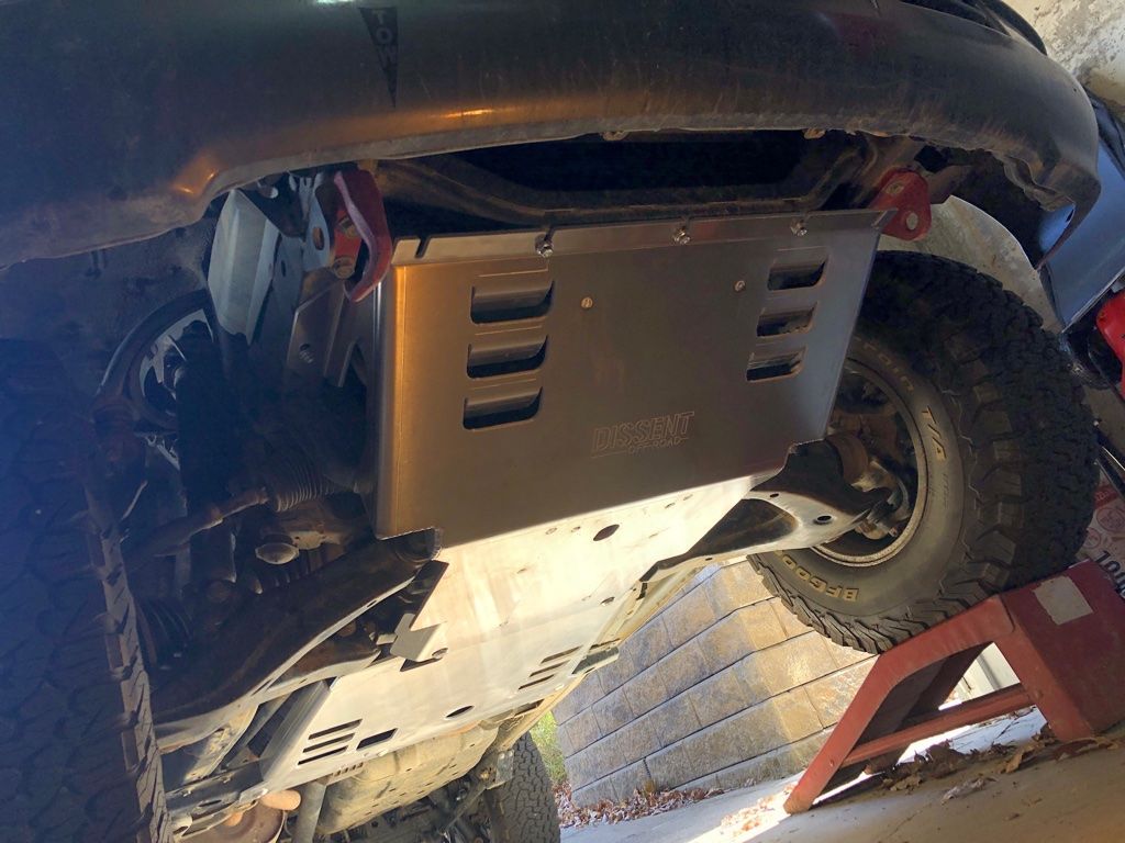

These came in a while back, totally forgot to throw some pics up here. DISSENT OFF ROAD SKIDS! Easily the finest armor around. You Asfir fans are missing out. Thanks @benc for the fine crafstmanship!
