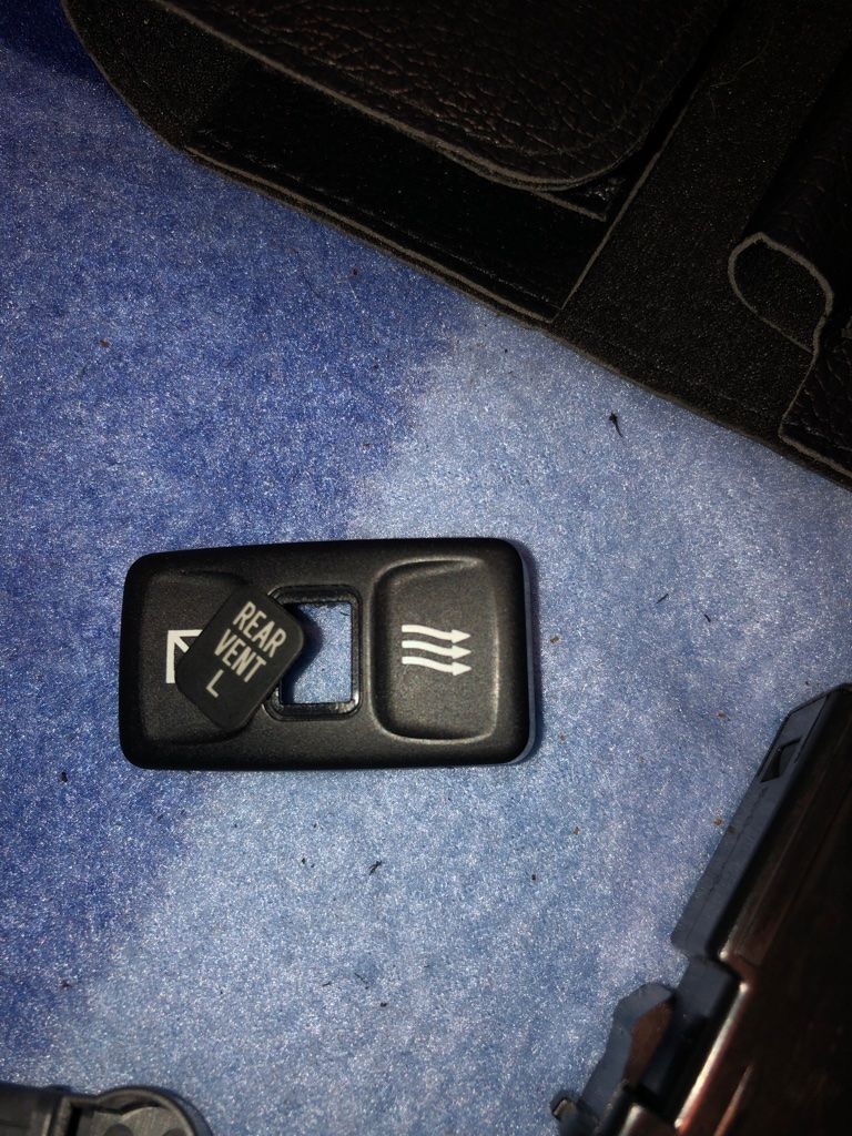

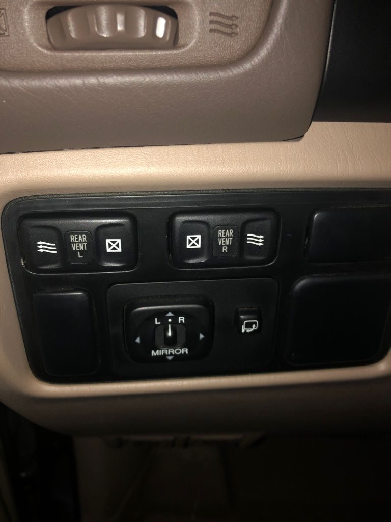

So the factory switches for the quarter window or vent window or whatever you want to call them never made sense to me. You should push "outward" on the switches to open and "inward" to close, same motion as the windows themselves. I was going to settle for simply flipping the right switch upside down, but it ended up being a good bit more elaborate than that.
After pulling the switch, I realized Toyota annoyingly (smartly?) put special grooves in the dash and switch body to prevent putting them in the wrong way/on the wrong side. I didn't want to file down my dash panel, so I decided I'd flip the faceplate part itself while leaving the body in its original orientation. You can pop the faceplate off, and also pop the writing part off to keep that upright.

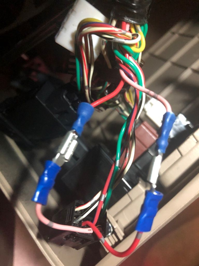

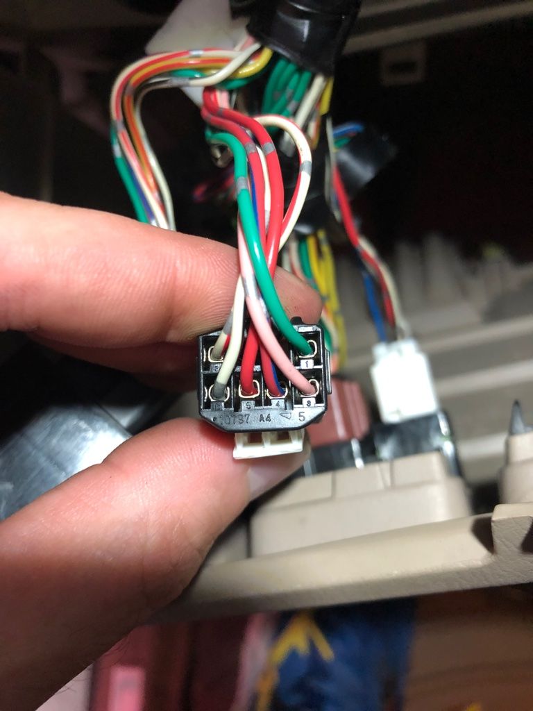

Problem is that flipping the faceplate doesn't change what the switch itself does. It just makes the open/close labels wrong. So I got my multimeter out and figured out which pins do the actual motoring. After numerous failed attempts to pull the pins and swap 3 and 5, I simply cut them and put spades terminals on. Really upset I couldn't get the pins out, but I tried every manner of pin and screwdriver and couldn't get the damn things to release. I did put a nice puncture wound in the pad of my thumb...
Viola! Switches make sense now!

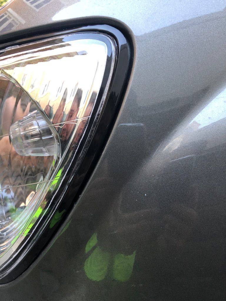

Popped in some Depo clear corners, which feel like they have a decent build quality and overall good fitment. Gotta use those chrome bulbs...no egg-yolks here.
