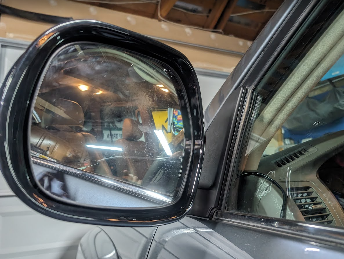

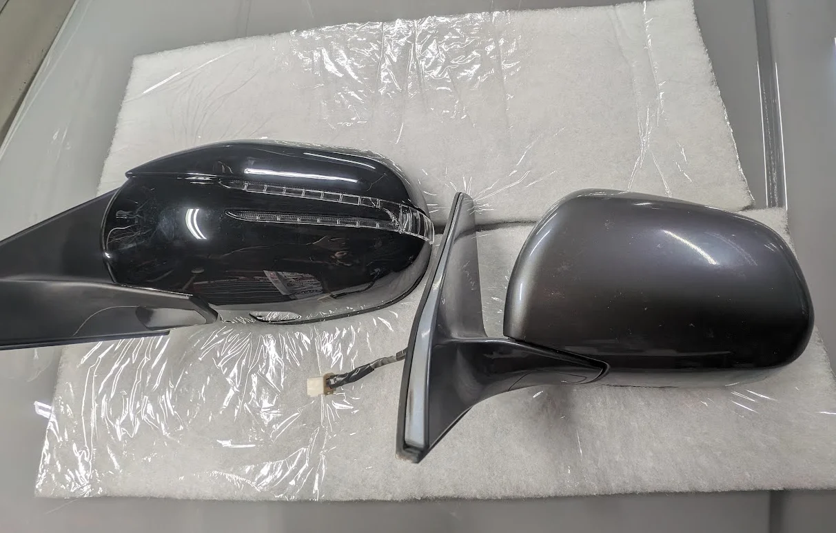

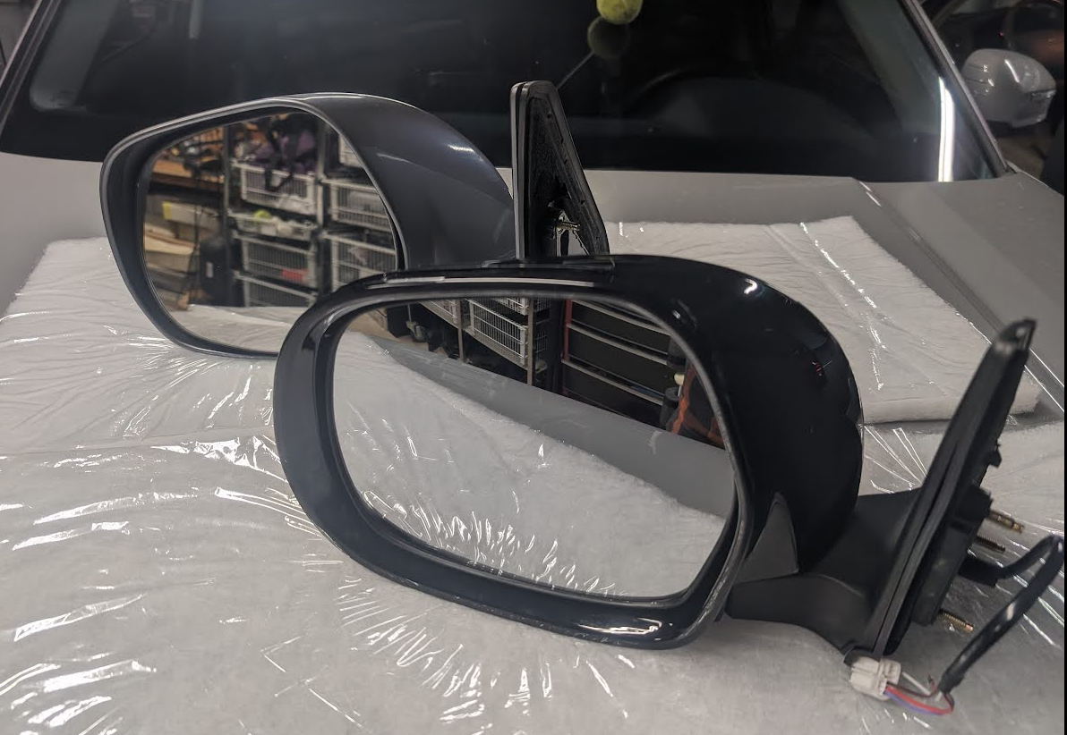

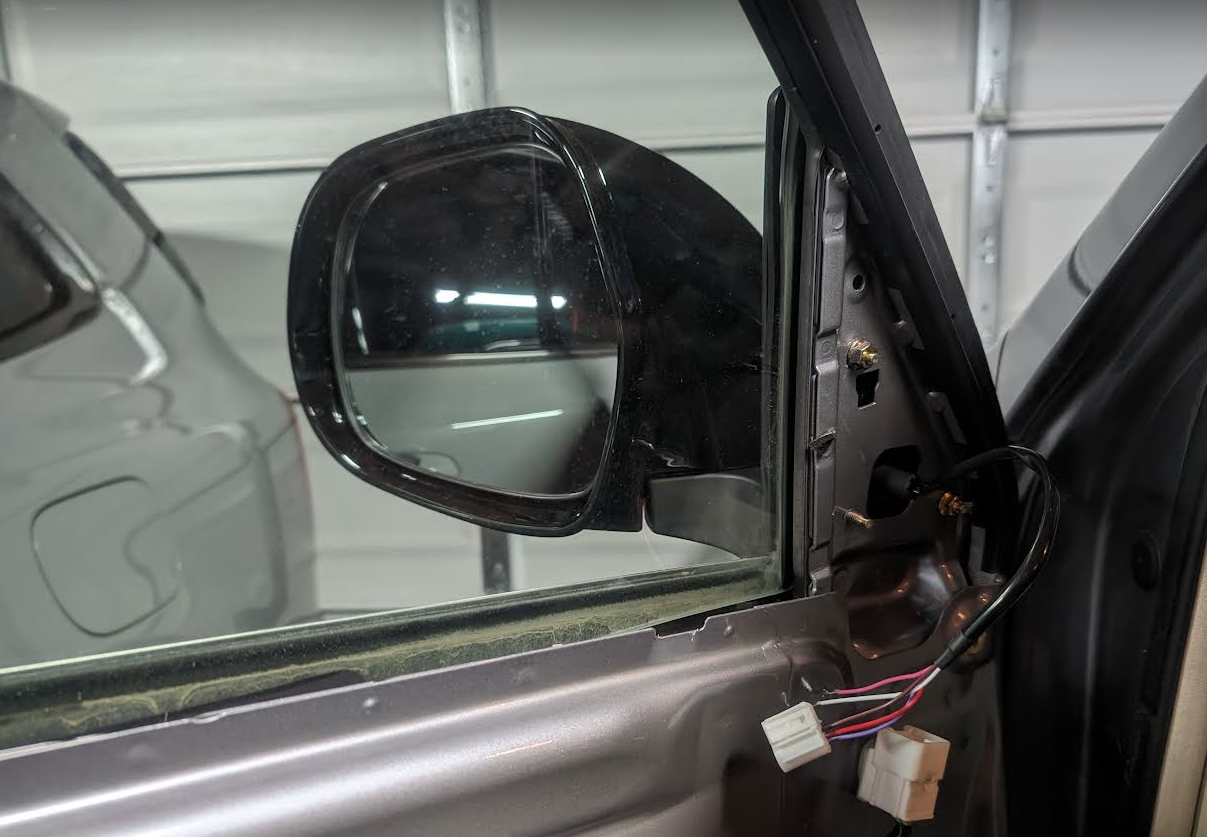

main bummer.. they screwed up their listing description.. these are NOT power folding... lame.

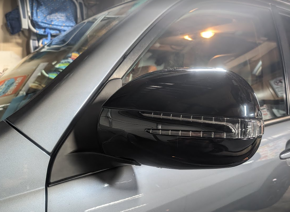

In talks with the company, they do have power folding ones, but ONLY in chrome/silver (gross). So I asked if I could buy the chrome (at a discount) and swap all internals into the black housing (i dont really see why not), waiting to hear back from them.

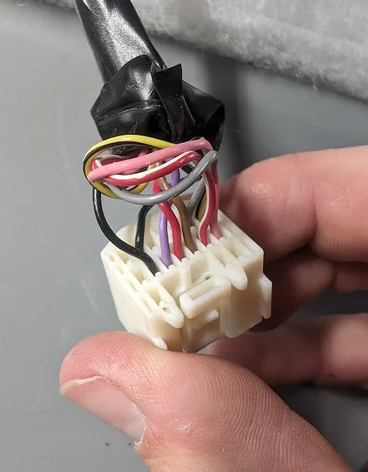

They aftermarket also do not come plug-n-play.. so now I want to try and source the male connector end that the OEM mirror harness uses:
Figure buy a couple of those to pin everything together and have them plug into the factory harness without having to sacrifice my OEM ones.

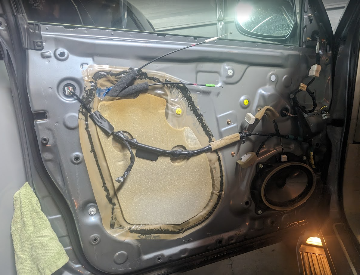

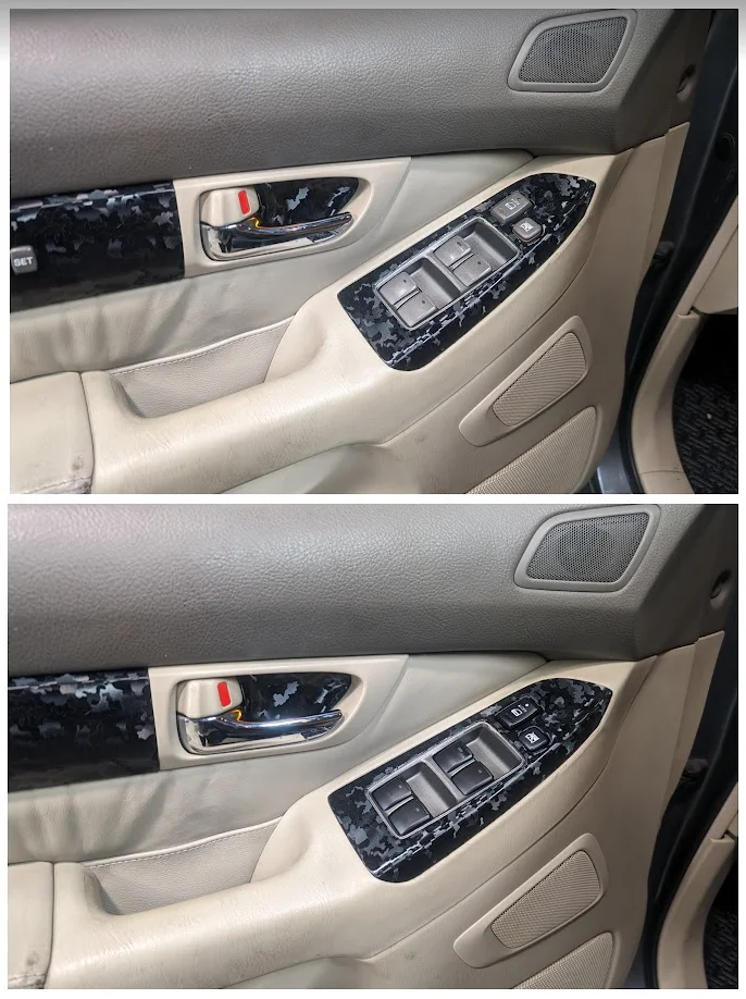

At least with all this, it made me pull the door card off.. so I pulled the drivers wood trim off of the door card and should get that wrapped tonight lol

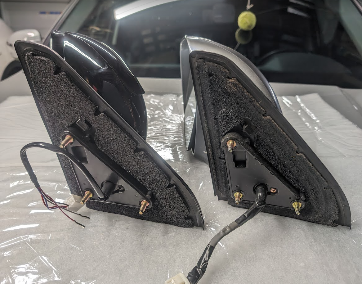

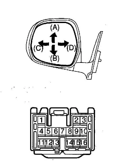

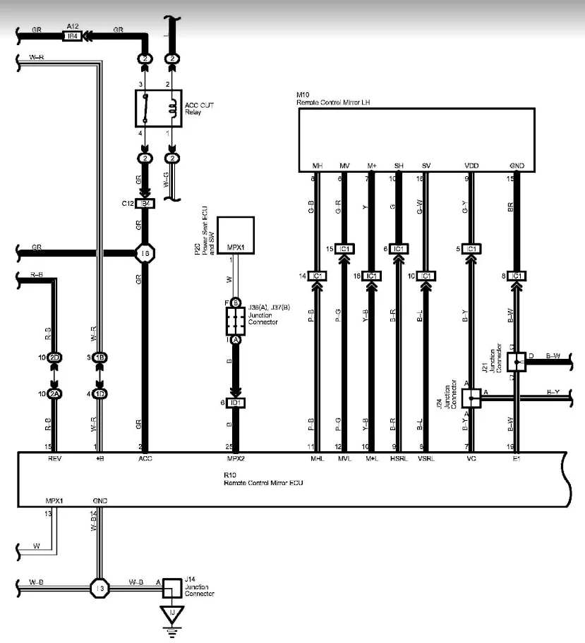

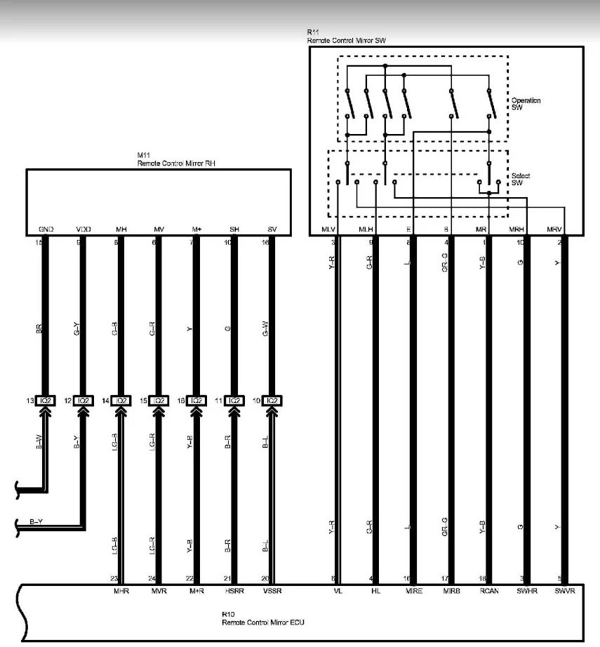

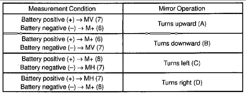

I was helped on the GXOF FB group and got the wiring diagram for the side mirrors and found the plug connectors, ill probably order a few to have on hand whenever I find mirrors that will work for what I want to do.
mirror side connector:

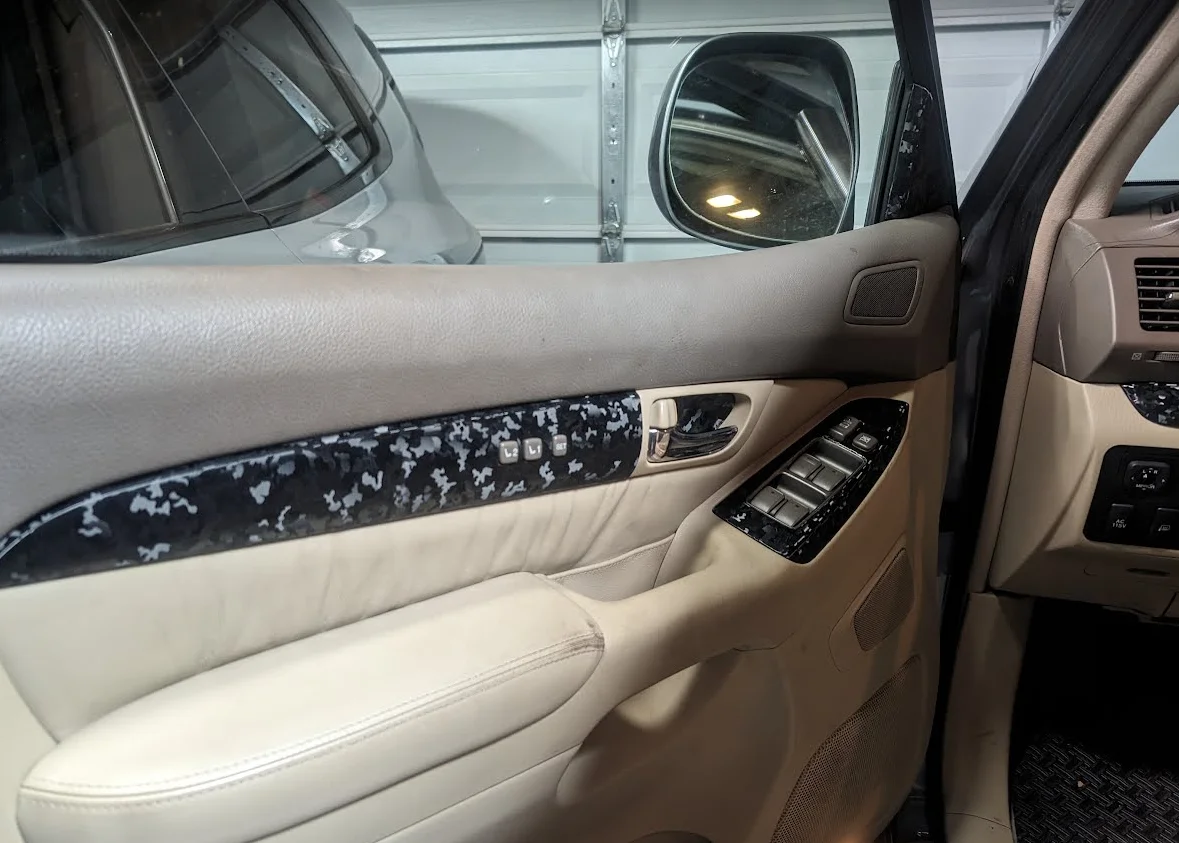

FYI - I take back what I said about the wood earlier. My GX looks much more modern/refreshed with less wood in it, including the Loncky wheel cover (which turned out awesome). I'm just going to keep the horizontal pieces under the top of the dash and on the door cards. Wish I had looked more at wrapping some of the center console/switch panels instead of painting them.

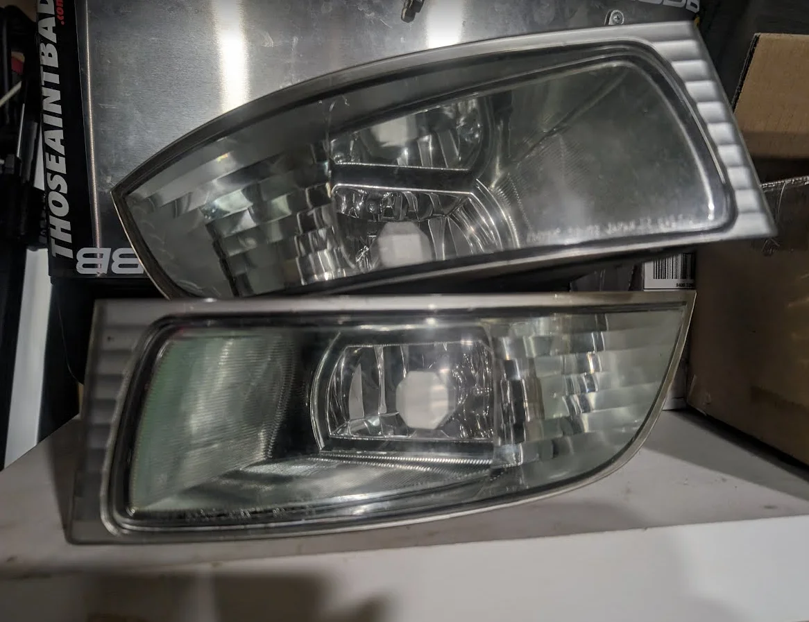

I did though, pickup some OEM foglamps for dirt cheap locally. No condensation, and bulbs inside for $40. I plan on trying the "fog light mod" placing some LED pods inside and see how the output is... if I dont like it, no real loss from modifying my OEM ones.
Small world... I bought them from a guy who literally lives 4-5 houses from my parents house (the house I was raised in). He is also friends with a guy I know, who owns a local fab/off-road shop - Stellar Built (anyone in the Sacramento area should always check them out Home - Stellar Built - Off-Road & 4x4 Fabrication Sacramento, CA - https://stellarbuilt.com/). I told him that when I was in the market looking to buy a GX, I had thought about knocking on his door to see if he had every thought of selling hahhaha.

The black drivers side switches arrived, so i swapped those in
I think it was worth the $26 or whatever they were to get haha.

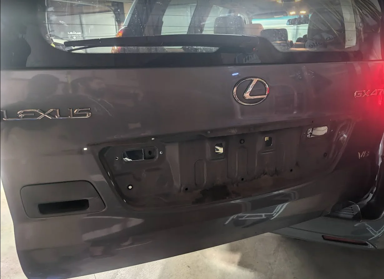

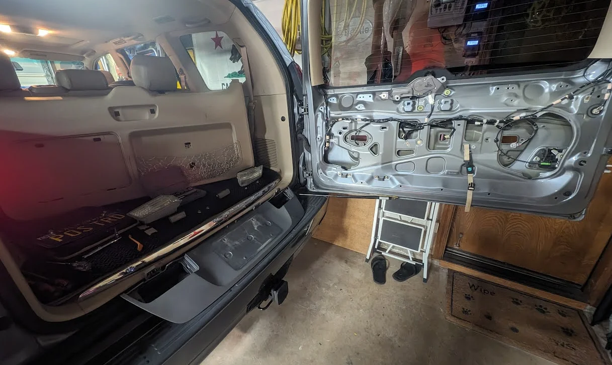

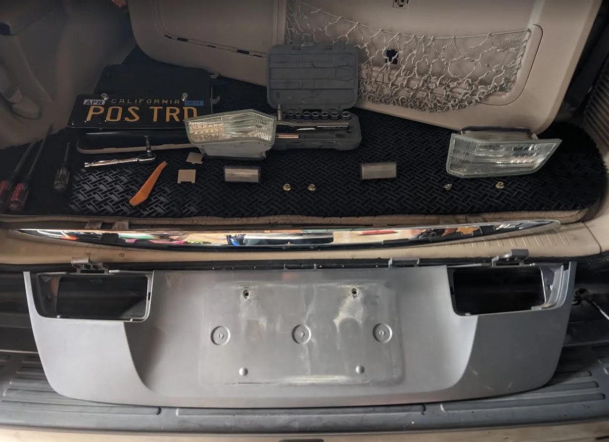

Decided I wanted to wrap the chrome strip over the rear license plate. That was a lot of tearing things apart just to get it out, basically the whole center license plate piece has to come out, to get the chrome out..
For a second, I thought about wrapping the whole section behind the license plate.. but changed my mind.

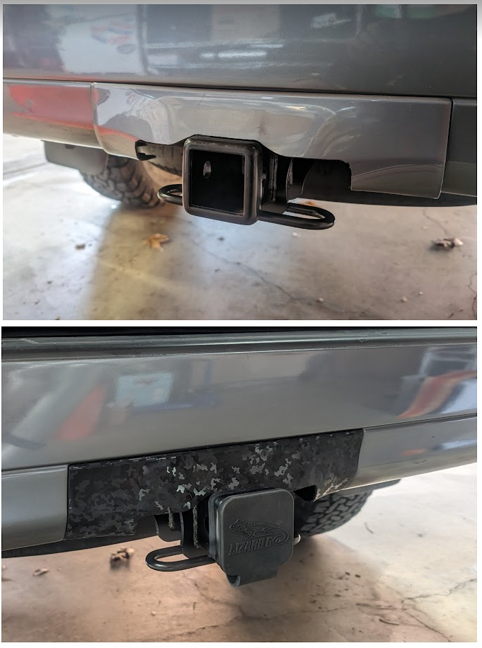

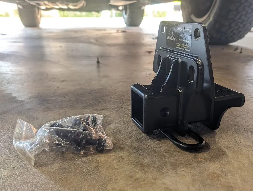

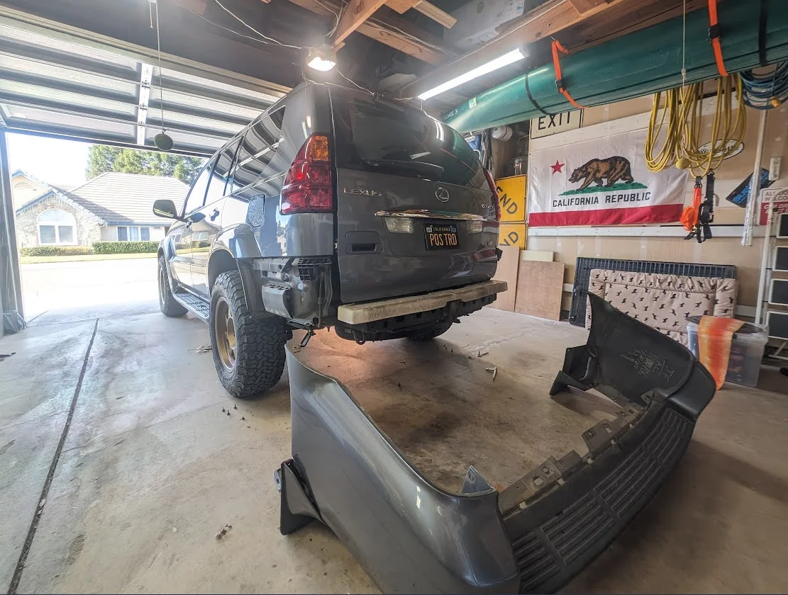

I also got my hitch receiver installed
Went with this guy: https://www.amazon.com/dp/B09NNMLKQF?tag=ihco-20
installed and ready for a ride lol

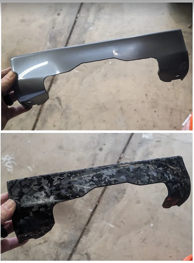

I had to cut up the plastic trim that goes in front of the hitch, then guess what, I wrapped it hahaha
I also removed the 3rd row seats.. put them in heavy duty trash bags and put them up in storage. Figured Ive got 5+ years before the nugget and friends are old enough to ride back there. So more room for activities and more room for the dog when shes back there.

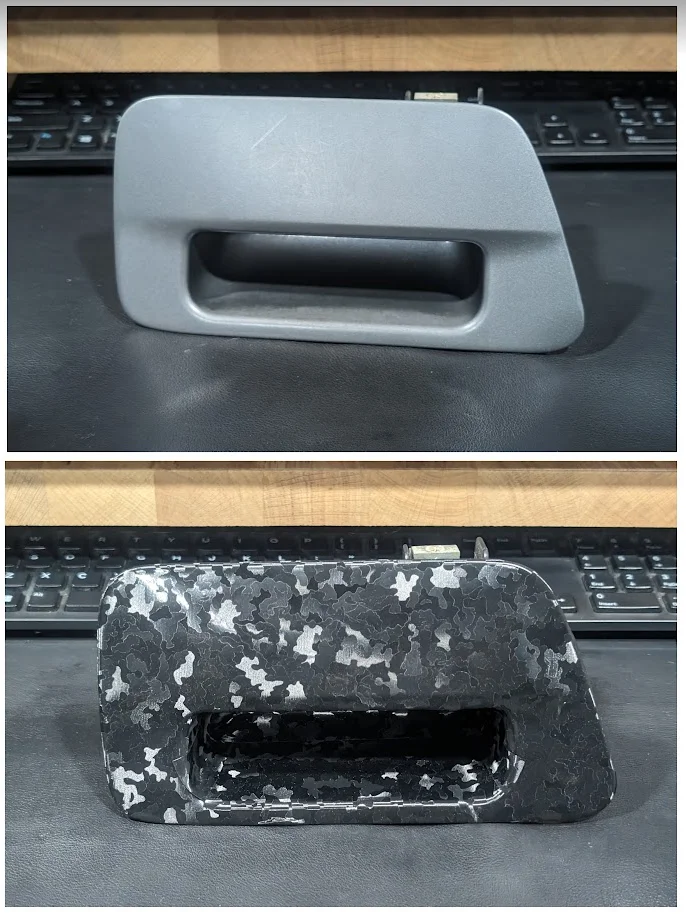

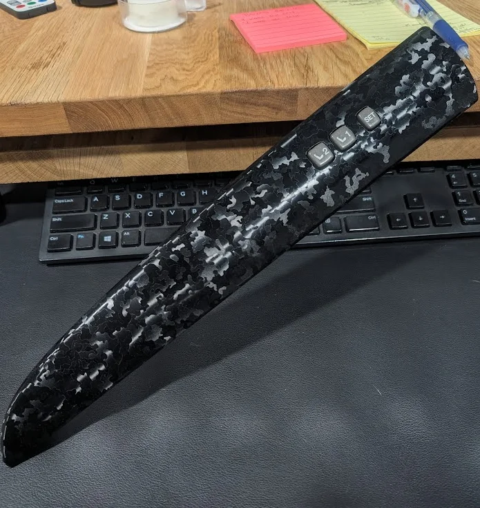

Going to attempt to wrap the rear hatch door handle tonight, we'll see how that goes.

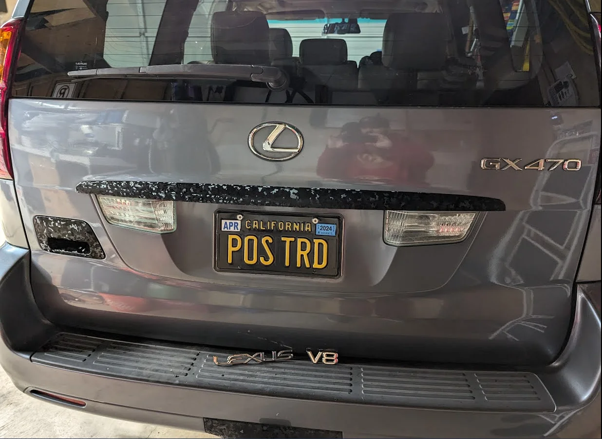

Forgot to snap a pic of the license plate trim and latch handle installed, I also debadged the "Lexus" and "V8" badge. Ill remove the "GX 470" badge as well, but I have a black one coming to replace it.
I would like to replace the center L, with a black one, but cheapest one I could find was still $74 or something silly. May just end up painting the current one.
