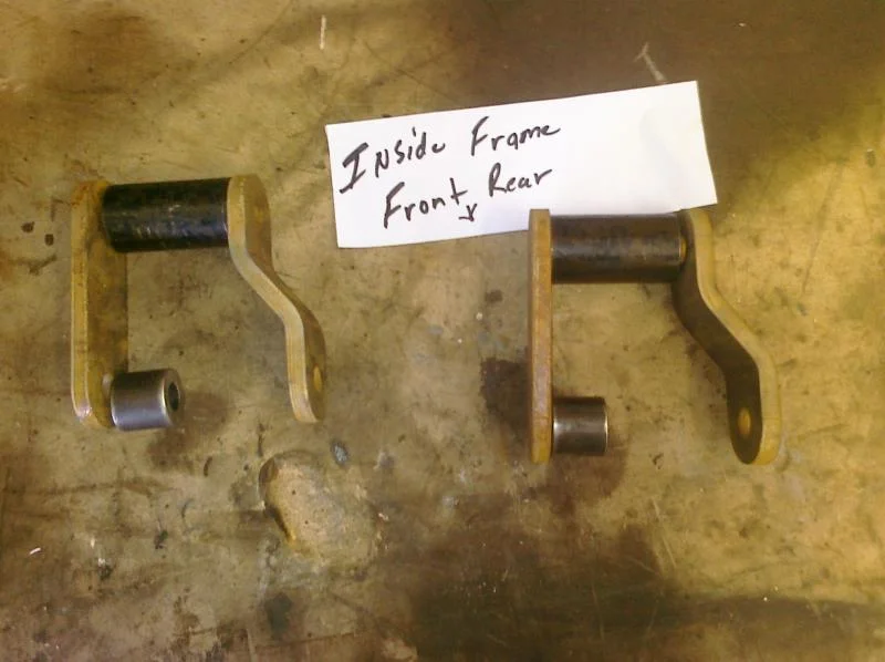

I ordered a pair of these from Proffitt's today and I picked up my front axle from the shipper. You'd better hurry. I'm catching up. :)
attachment.php
attachment.php
SHIIIIIIT....Im pretty sure youll be done WAAAAAY before me!
Good luck with the offset hangers.
Seems like a good way to go.
