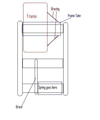

I thought I invented that. I certainly thought of it before I heard it hear just now. I've been planning to leave the side plates straight and use a bushing on the bottom and a wide, reinforced frame tube at the top. I drew a quick picture for another thread. More recently I've been thinking about leaving out the braces; both the one labeled and the side-to-side shackle brace. The "bushing" on the bottom and the bolts will be welded to the inboard side to help lessen the tendency for the spring to torque the whole assembly.
attachment.php
I'd love to have one of you guys post up some pictures. Even better if you had a picture while your suspension was all twisted up.
After a year of wheeling, I would inspect the frame bushings, check for wear and rotate them around so they last longer. There is definitely some torque there.
