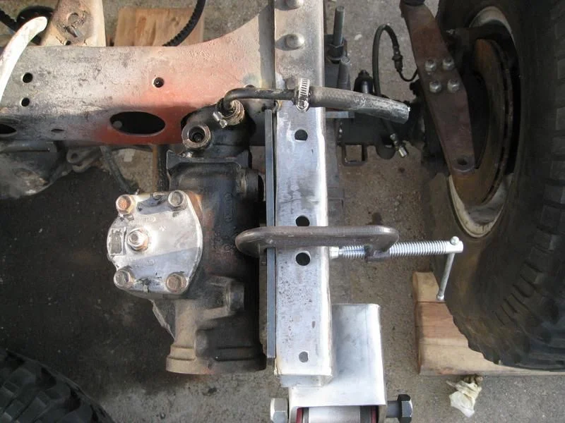

Im on a limited comp access here in Chicago, but did that hanger in the front interfere with the PS conversion?
Cant quickly access the pic right now.
K
K
No problems here because of the outboarding. I have uploaded a few pics for your viewing pleasure once you leave the Chity. :flipoff2:
Edit: I plated the drivers side frame horn before I welded on the plate. I bought the plates from Georg.
Thanks for the pics brotha!
Do you have any of the plates welded in?
Did you end up sleeving the hole in the x member?
Any way to re enforce the lower part of the plate, or do you see it as an issue? Seems those 2 lower bolts are kinda hangin out in sort of a limbo stat.
I got the plate set up from Georg as well.

I guess you could add a 45 plate in there if you feel the need.
It looks like out boarding the springs actually helps you out compared to mine
Sleeve the frame. Seriously.
I was planning on that...
What dia./ ga. tube is that?
Seems that would be the best thing to do!
