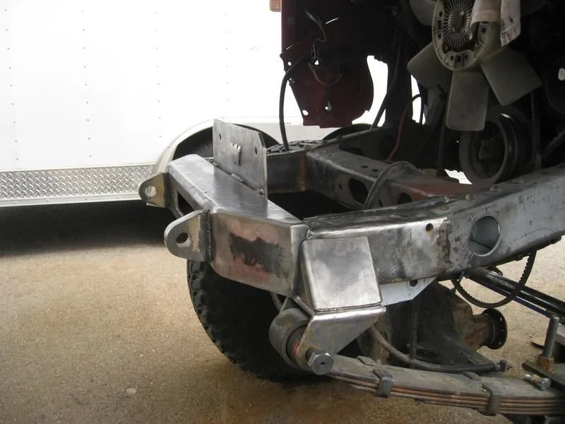

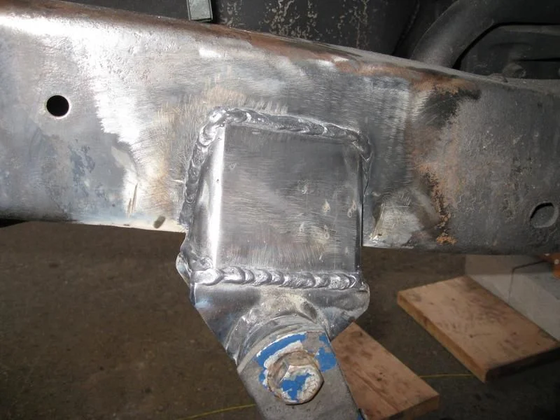

Here is what I did, doesn't mean it's right, just an example.
1. Outboarded front spring hanger. I recall 1.25-1.5" on each side. Measure the stock 60 perches and go from there. Hopefully you got the custom Ruffstuff perch for the 60 series as it will make things easier on the passenger side of the front axle. (I just ordered one myself as I suspect I have a bent housing and wish I would have used one the first time around)

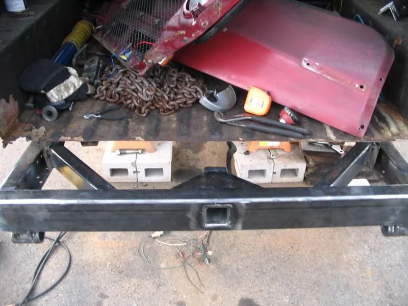

2. Rear angled crossmembers. 1.5x3x.125 box tubing.
3. Outboarded shackle hanger for the front.

Thanks for the pics! Nice job! Like the way you gusseted the hangers.
I did get the diff side perch with the kit that ordered. I thought that it was supposed to come with different angles, but I guess not as I had only gotten one? How does that work? Do you set the diff side plate on there, then cut the top down and weld it together? That is the only thing that really makes sense? What caster are you guyz end up at?

So its a good idea to have those braces in place for the purpose of towing/ tugging? That is a good point. Ill be replacing the rear x member with some 2x3...not quite sure how to I wanna do that just yet. Ive GOTTA incorporate a swing out somehow.
I will be running a full cage as well. It probably wont happen by the time I get her up and running, but it will happen soon after that.
As far as the swing out is concerned, Ive obviously gotta be able to clear the tub... I was half way thinking about using some c channel back there, then using some 2x2 and some gussets for the swing out. Sort of like the MAF bumper set up. OR...using some3x3 square, welding it to the end of the frame. That should be pleanty to clear, and I could also do like E wheeler did and run tubing from the bumper to the frame, much like the stock x member set up...
