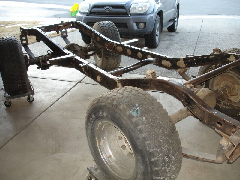

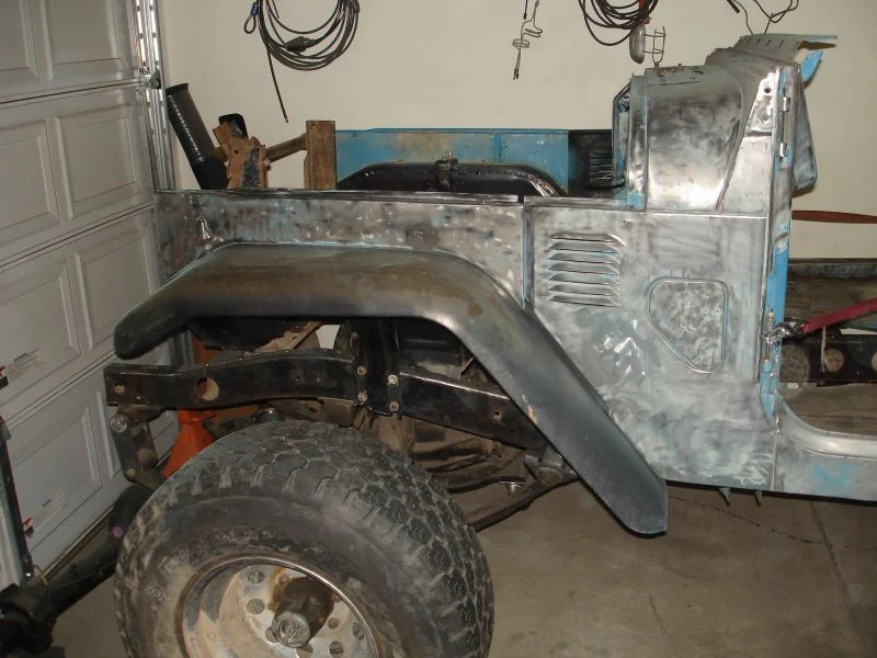

Here are a couple of pics!
SEE, the fender/ bib is just kinda supported by 4 bolts ONLY. There are two down lower of the slope of the fender, but it seems that it'll kind flop around where the bib meets the cab...

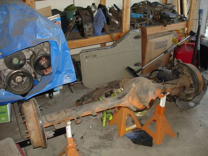

The other two pics are just some shots of the various parts piles that I have layin around. I cant believe what a MESS my shop is right now...Its KILLING ME!:bang:
Those pieces are called aprons and yes, they only bolt down to the fender and the bib (headlight frame) up front. When everything is bolted together up front it is very solid.
Don
Nice pictures, I was looking for my other half door last week.

I was out in the garage today, and it seems that the fenders themselves may have the holes off...If I sort of bend the fender and line the apron up, the holes are off. It could be just as simple as re drilling the holes...
