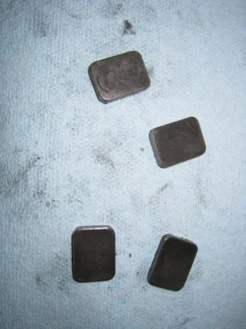

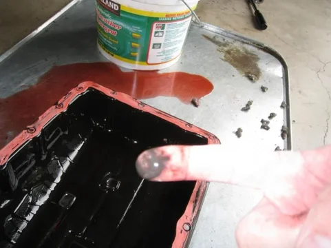

A real MONSTER metal shaving was on one of the plugs. It looks solid, but it's so thin it disintegrates upon touching (or so I was told).
Enjoy!
My cruiser shop recommended I just wait until it blows up / he wasn't even sure he should have shown me these pics.
Those look furry! How many miles? At 90k I had only a slight bit of metallic paste on mine.
I don't suppose you have enough fluid left that you'd can get a sample to send off to Blackstone? I'd really like to get more samples posted up here so that we can see if there are any common traces preceding a failure (not saying yours will or will not).
So is that clutch material or something else?
wow, that is a lot... how many miles on it?
Those plates in the pan are magnets. The frass clumped on the magnets is steel, even the monster chunks that look big enough to have part numbers on them. Worn clutch material is dispersed in the fluid.

FWIW, oil analysis is very helpful as an early warning system for wear that liberates metals into the oil. The frass in this pan might be stronger evidence than an oil analysis. Just sayin'.

Those plates in the pan are magnets. The frass clumped on the magnets is steel, even the monster chunks that look big enough to have a part numbers on them. Worn clutch material is dispersed in the fluid.

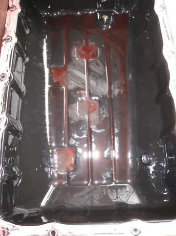

I'm not convinced that there aren't thousands of us driving around with pans that look like this. You could drain and full and never know. Why is everyone sure this is the precursor to the infamous MY 2000 tranny failure mode? I'd still drive the heck out of it.

Just for reference, this is what mine looked like at around 90k. No metal bits, just a little paste. Don't know if I represent a clean sample or not.
