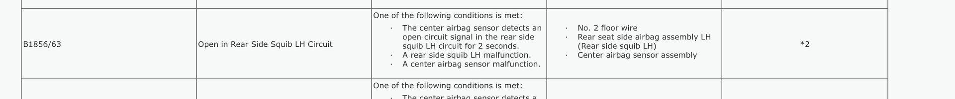

Ok here are the codes. I didnt notice the abs light on at first so that explains the first one, must have stretched the wire.
On that B1856 have you unplugged the second row LH airbag connections or at some time in the past?
I’m curious if original errors on dash stick around once the speed sensor wire is repaired
Ohhhhh I bet that had something to do with the airbag the dealer had to replace. Son just bought this about 3 months ago and had to go back within first week for airbag light and valley plate coolant leak. I ordered a new sensor wire should be here Friday.

New abs wire solved everything except the B1856.
Any idea how to check the 2nd row airbag wiring?
Oh jeez. Popped off the plastic cover on the seat rail and there was the yellow airbag connector just unplugged. Bizarre.
Plugged it in and airbag light is off.
