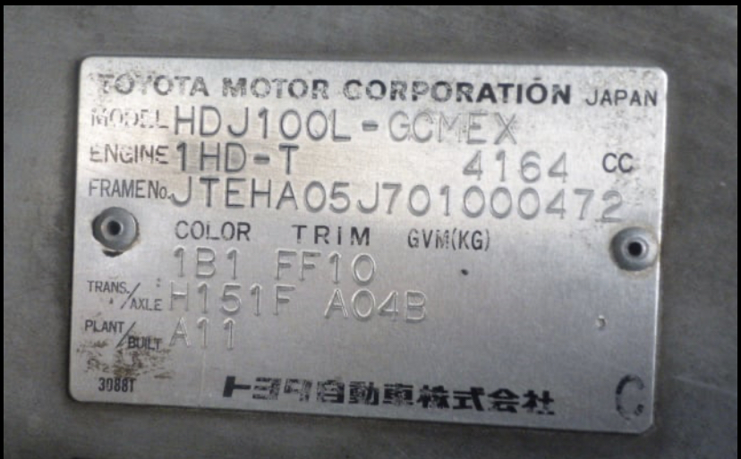

i’m attaching some pics and the plate on engine bay.

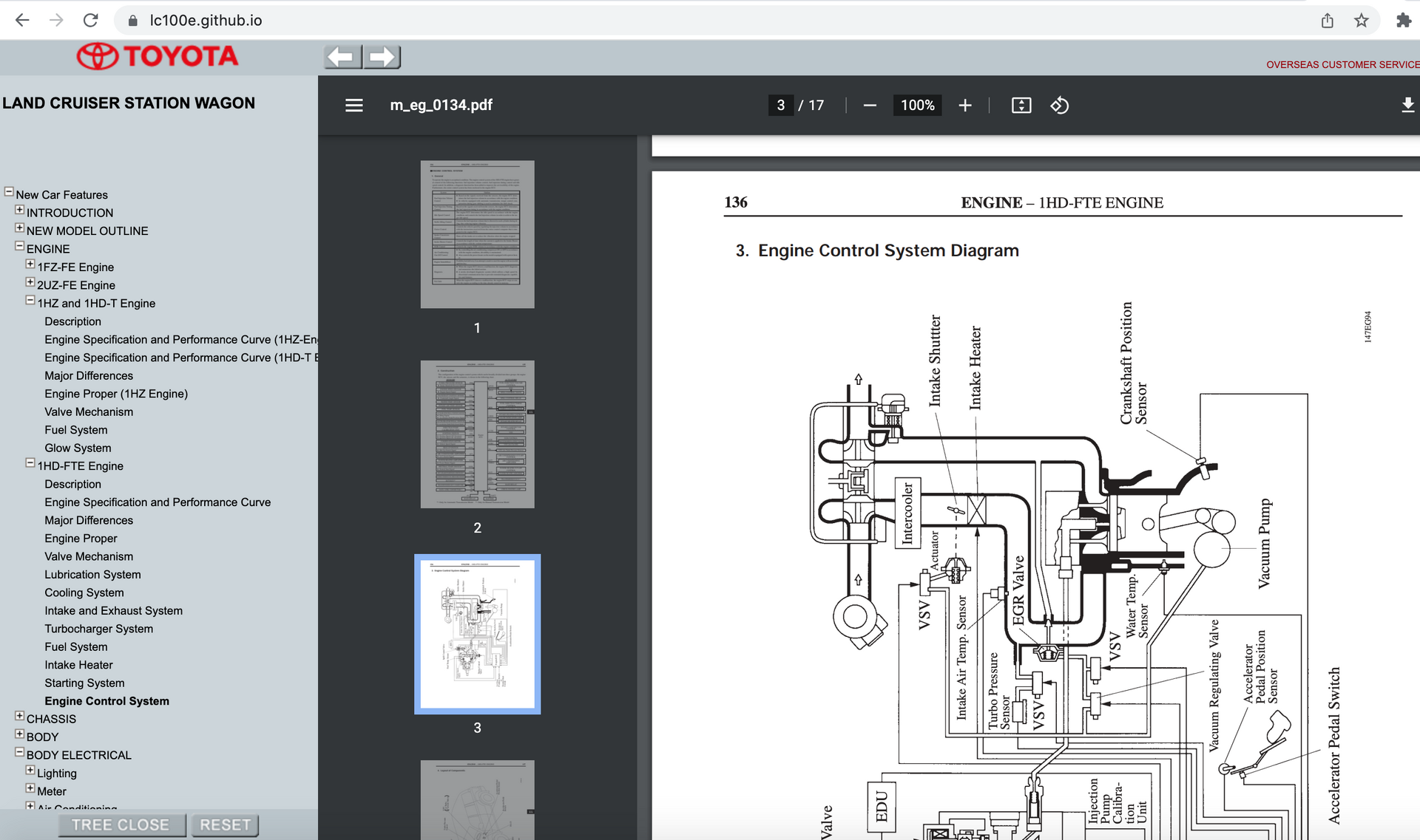

The closest I can think of is to head over LC100 Workshop Manual - https://lc100e.github.io/
Under "New car features" select Engine
If you compare both 1HDT and the FTE you can see the difference and provide the documentation using the FTE as reference, 1HD does not mention Any engine control unit.
Also check and compare the "Major Differences" Section
