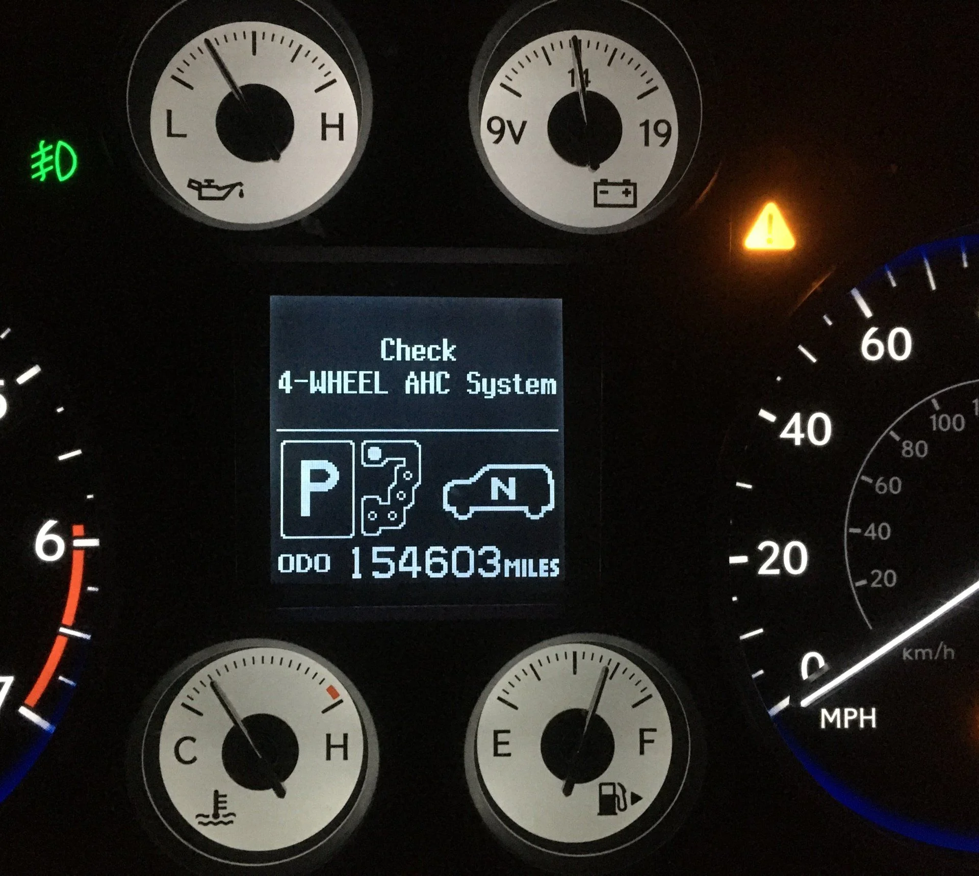

I fired up the truck in 30F weather and the "Check 4-Wheel AHC System" warning displayed.
The warning has not re-appeared after multiple subsequent starts.
I'm hesitant to ask this question as there may be too many possibilities, but is there a "common" thing I should check?
At this point, would a fluid flush be a good move or could that be a potential waste if I need to open the system up for component replacement?
Reading a bunch of threads, I just ordered a Techstream cable.
