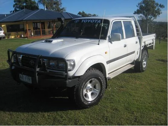

Some pictures:
file.php
file.php
Here the rubber seal is missing but they told me it's included with the kit.
What do you think? should we stick with the 4wdbits one or is this a better alternative?

sounds great .. just want to see the complete 80 picture .. I'm under the impresion that scoop looks a little tiny in the 80 series hood.
I agree, that's what I don't like about it. It's the scoop from the Toyota Hi-Lux.
But in these pictures it looks better:
