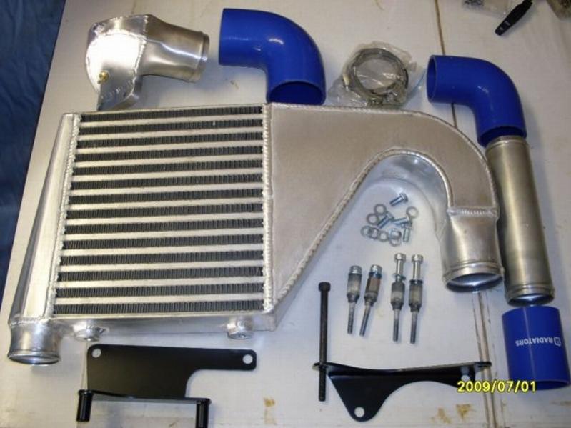

Hi,
No, The improvement is to be done on all the hardware, the brackets did not fit, Holes not inline, M8 taping missing well some small stuff that make you using 3 hours to install it instead of....10mn.
Also the rear bracket is touching the water pipe going to the dash bord. Some small things to fix, but again, you won't find anything else at this price.

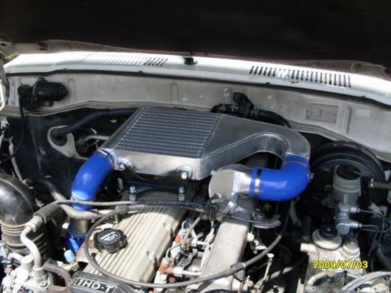

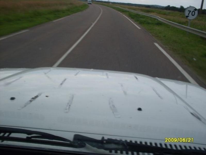

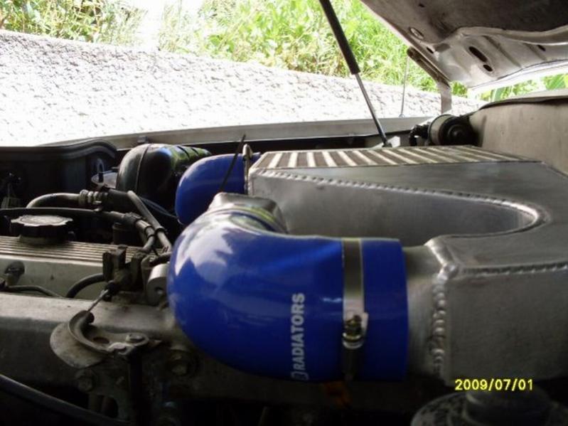

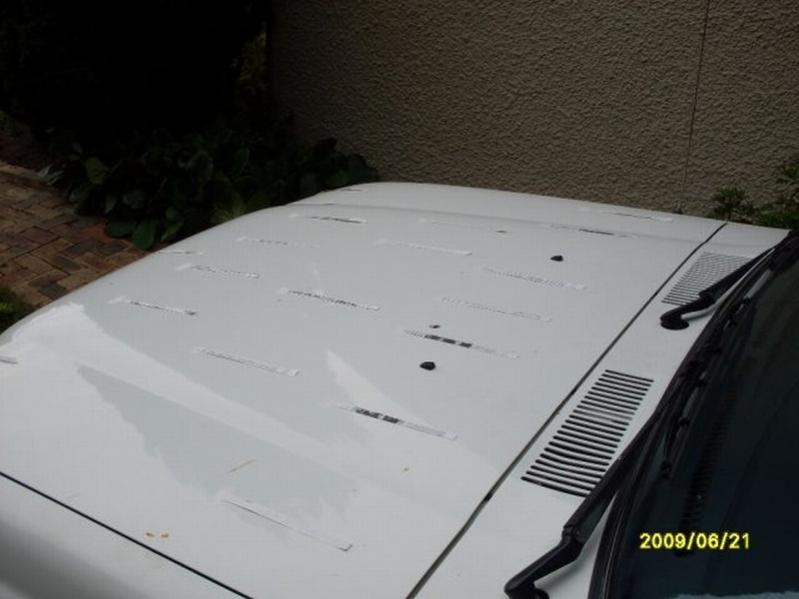

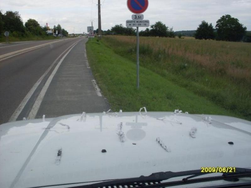

Here are the pics that I've received from syche:
5 or so more posts with pics to follow...
Hi,
Thanks a lot "Mot" for having posting the pics for me:).
Well, as you can see the cooler is just next to the fire wall on the 12v, on the 24v it is almost centered in the engine bay.

So am I understanding this correctly that if you have the 1HD-FT(E) the intercooler will mount in the middle of the engine/hood, but with the lowly 1HD-T it's gonna sit further back, right up against the firewall and that will make it more challenging to have any (decent) airflow??? :frown:
And would the lack of airflow (pressure) be remedied, at least somewhat, if the hood was sloped up a tad more? I've seen some people install spacers/washers at the back of the hood which gives it some grade. I'm wondering if that would make any meaningful difference, especially at speed (not while crawling).
And I guess the last resort would be to install a fan or fabricate some sort of fancy ducting run from the front of the hood/vehicle. (Or just do the front mount intercooler).
Any thoughts???
Yes Mot,
Some spacer in the back of the hood might help to catch more air at the right place as the hood will not be horizontal anymore. But it seriously change the car look. I try to keep it looking at stock as possible. We start to have serious problem with the new cars regulation as soon as something look different, and i don't even say anything regarding tires change and etc witch are.....prohibited now..but..we still try:p
Both engires are pretty close .. I don't see why ( or how ) one intercooler sits further than the other one .. but anycase ..
If I can buy and install one ( very tempted ) I would add a electric fan under it .. with a interior cab switch ..
