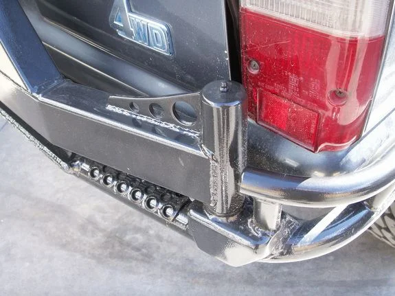

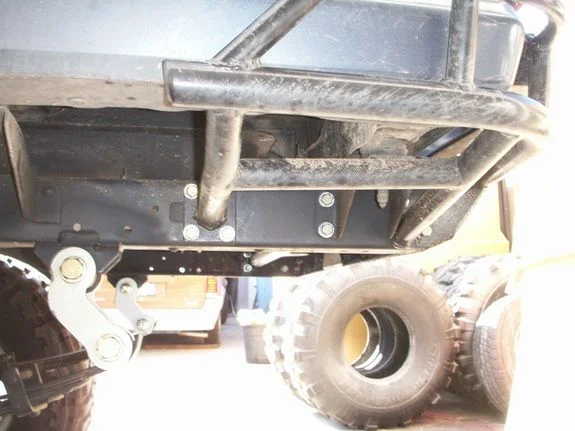

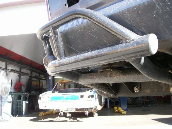

yeah ! In order to make them straight you would have to come out farther anyhow, as the body has a slight curve to it, I put a silght angle to the quarter gaurds and it does'nt seem to wide ? also I too believe that the angle would have less chance to be pressed into the body. Whatever you flavor though - right?

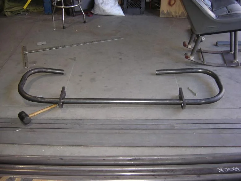

main tube is bent (a pain in the kester i might add) i have to go back and do some re-bending on it monday to square a corner up :eek:

Yeah I know!! My bender does'nt like the big stuff either. I actually bent the main die supports on it.I tried to bend 2" .188 wall DOM. it did it but not willingly.The other tricky part is the corners:mad:

do you use hydro or the manual pulling method?
strong arm for me :crybaby:

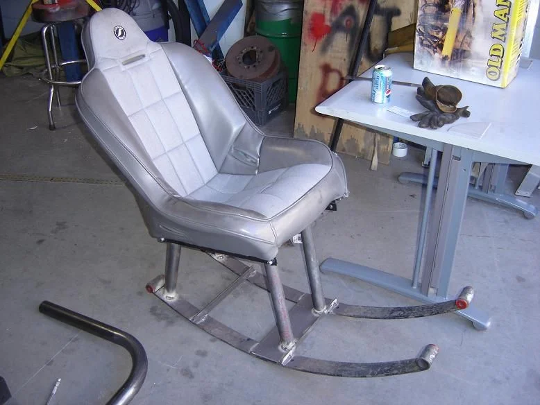

and my "solid rock-ing" chair cause i knew someone would ask about it ;)
it kicks back perfect and the front of the springs makes for exellent foot rest.
:grinpimp:
Bumper is lookin good, and the chair is sick! I'm totally makin one! ;)
THAT IS ONE BITCH'IN BUT PRICEY ROCKER ! i DIG IT !:beer::beer:
i'm thinking it needs some expanded metal on it.
some side protection and a couple cup holders.
red cruiser sat in it and about went over backwards :eek:
a wheelie bar or some stoppers are in line for the next mod ;)
