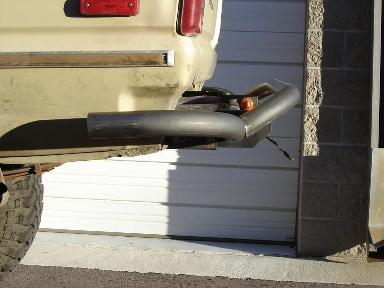

I cut mine off outside the framerails, it looks a lot better than the modern art that was on there.
I love the rear stinger... that's pretty pimp.
attachment.php
This bar I think would be unneeded if the quarters are chopped...
I think you could get the bar to return in these two spots by either back directly to the frame to be welded or back to a piece of flat stock kinda like marlins. You could either weld and/or bolt that flat stock directly to the frame?
I cant even imagine how long it must have taken you to bend this piece:
I would make it alot eaiser on yourself especially if you start mass producing these to do something more like this?
rear 90s?
What do ya think?
attachment.php
correct you are!
this is the plan for yours
it only took a couple minutes to bend.
it took about a half hour to get the angle right on that tube to the lower tube :eek:
rear 90s?
there would have to be a plate from the bottom tube to start the upper, that bend cannot be done with my bender. i don't think that two 90 pieces can be welded and look clean enough.....i'll try ;)
What do ya think?
i think we're on to something :D
