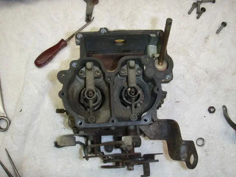

Gents I'm working on a neighbor's 1972 FJ55, feel free to follow along in the Iron Pig Preservation page at https://forum.ih8mud.com/fj55-iron-...ty/577490-elsie-went-wewewe-all-way-home.html
I pulled the carb yesterday for a rebuild and have a few questions since I don't have a 72 FSM.

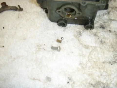

pump inlet ball and retainer?.webpFirst when I removed the air horn and pulled the pump plunger and spring I did not find a retainer clip holding the check ball in place. Did they have a retainer in 72 (Jan 11, 1972)?

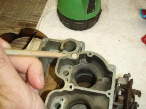

There is not a moving cover to the pump outlet circuit, talking about the piece that comes out on later models and has another small spring and outlet check ball (without the clip). The pencil is pointing to the location.

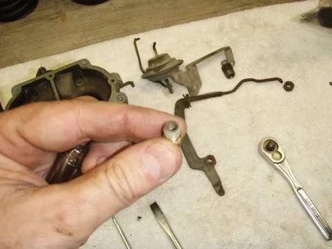

Finally the PV did not have a jet but looks like one may screw into the bottom. I guess I will find out when the rebuild kit shows up.

Thanks for the links, this carb clearly has some issues. I'm going to have to figure out how to get the weight on the pump outlet circuit loose and removed so I can get the spring and second check ball out; also will have to figure out how to fab a retainer clip for the pump inlet check ball.

I would try some PB blaster on top of the cap, let it soak and see if it loosens the cap enough that it will drop out when turned upside down. If that doesn't work, use the straw to shoot PB blaster up the AP pump discharge. Worst case some carefull use of the air compressor should pop that out.
Good call on the PB Blaster, the bowl went into the dip last night so if that doesnt loosen things up then I will progress to that followed by the back pressure suggestions.
Still need to figure out how to find or fab the little metal retainer clip that holds the inlet check ball in place.:hhmm:
77mustard40;7506932 Still need to figure out how to find or fab the little metal retainer clip that holds the inlet check ball in place.:hhmm:[/QUOTE said:
Second Ricardo's advice...also, most people who have been through a few of these carbs have a spare little round retainer clip or two lying around. Like me.
Yep this is only my second time in to a carb and the first time to find it missing. Any ideas where to look for one?

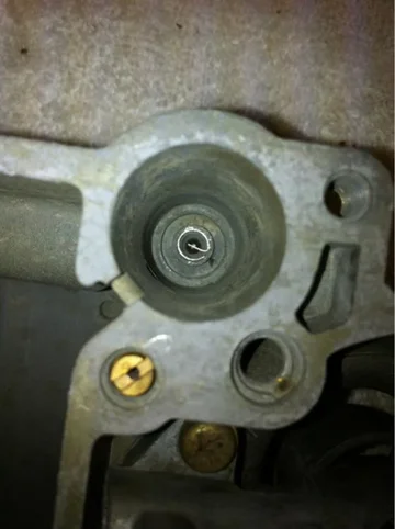

Just pulled the bowl from the boil and was able to get the weight over the pump outlet out and found no spring! Great, just great. Add another little obscure piece to the treasure hunt.

May have to use one of the retaining clips from my last rebuild to make a retainer for the check ball

So if the spring is missing under the weight in the pump exit circuit does that allow the weight to block the brass fuel passage thus preventing the accelerator pump from giving the little squirt coming off idle? Might explain why the jet was removed from the power valve; trying to rig more fuel delivery to compensate, or am I thinking about this too hard?:confused:
I'm always trying figure out why someone did what they did. Maybe they just screwed up.:hillbilly:

The e-ring for the pump check ball is available from the dealer.
21538-31010 RETAINER, BALL CHECK $1.63
Ordered, thanks Jim

Thanks again Jim, local dealership said no but found the e retainers at toyotapartszone.com
