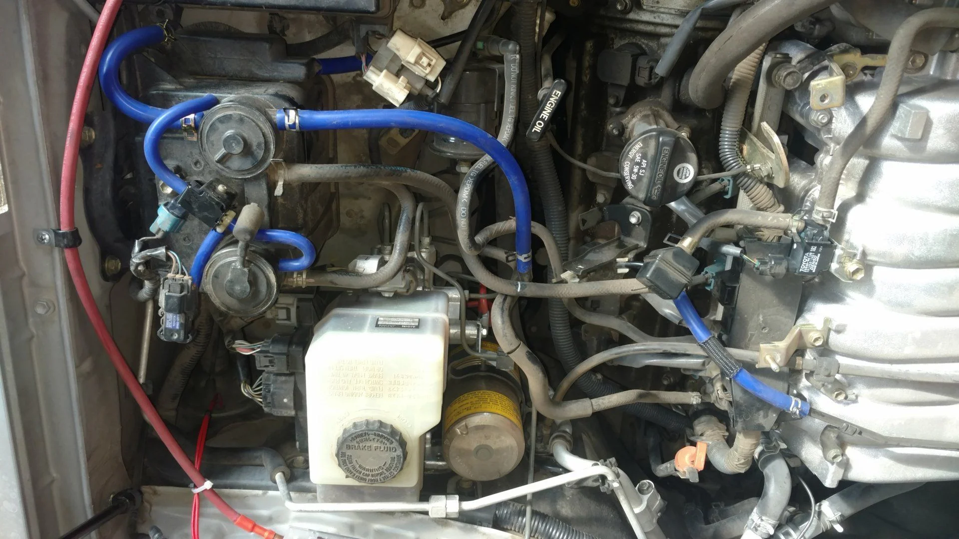

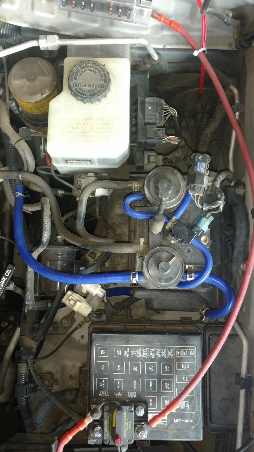

bluesquirrel: since I'm a 2004 guy w. interest in using under hood canister system, can you take a few shots of the engine bay. Want to see if I can accommodate that system.
Same here. 2004. Interested to see how this works out!

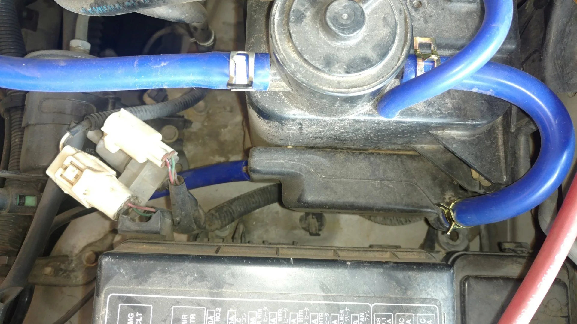

Sure. I'm not familiar with the tank mounted canisters, but I believe the FSM has part numbers for both types. I'm betting you have some different wiring too.
Blue silicone are the vacuum lines.
Many thanks.
Do you have the FSM sections that deal with the under hood cannister wiring?
I have the '04 manuals. I will compare to see what kind of mess the swap-ola might lead to (um, mechanical engineer who is electrically challenged.....read "know enough to be dangerous"...to myself:cheers:).
I do not have an FSM yet. I only know from the pictures I have seen while conversating with the parts guys at my local Toyota dealer.
