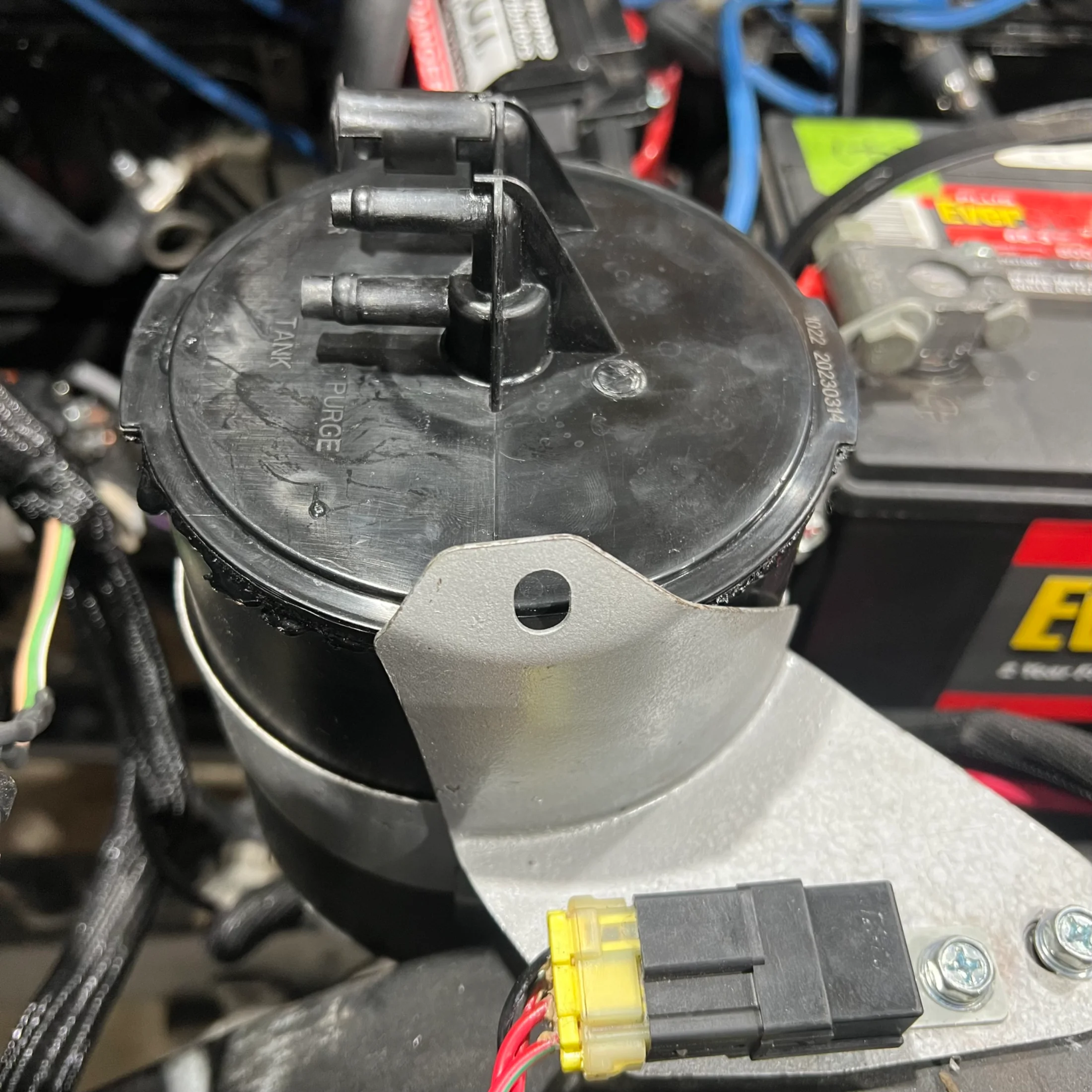

From Oreilly for the vapor cannister. Early 90s 3.1 Oldsmobile, maybe a Cutless? - Coincidentally fits into an overflow bracket for a mid to late 70s FJ40.

Stock is ideal- this rig didn’t have one in the pile of parts. It’s not a resto so this was a solid option.
I did the same thing and bought it from redline cruisers. I bought a new OEM fender from the guy in Germany. The fender didn’t have the provisions for the stock canister and didn’t want to drill into the fender.
