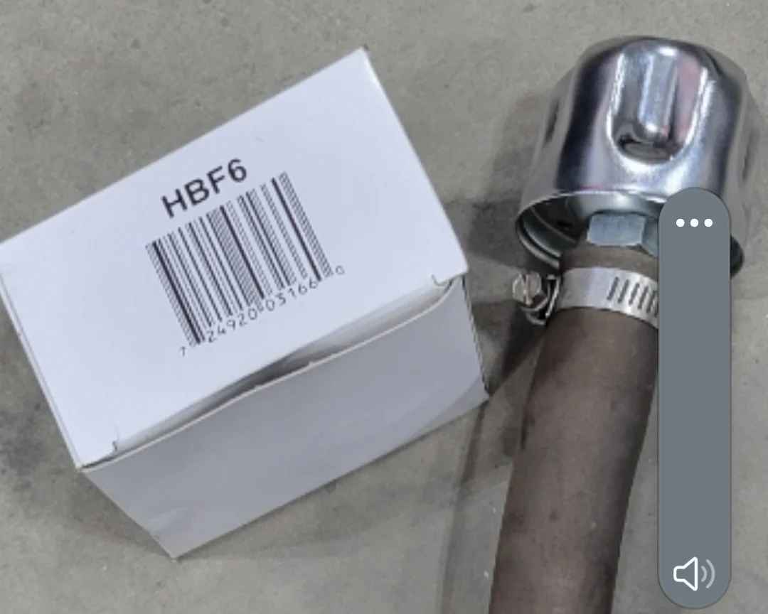

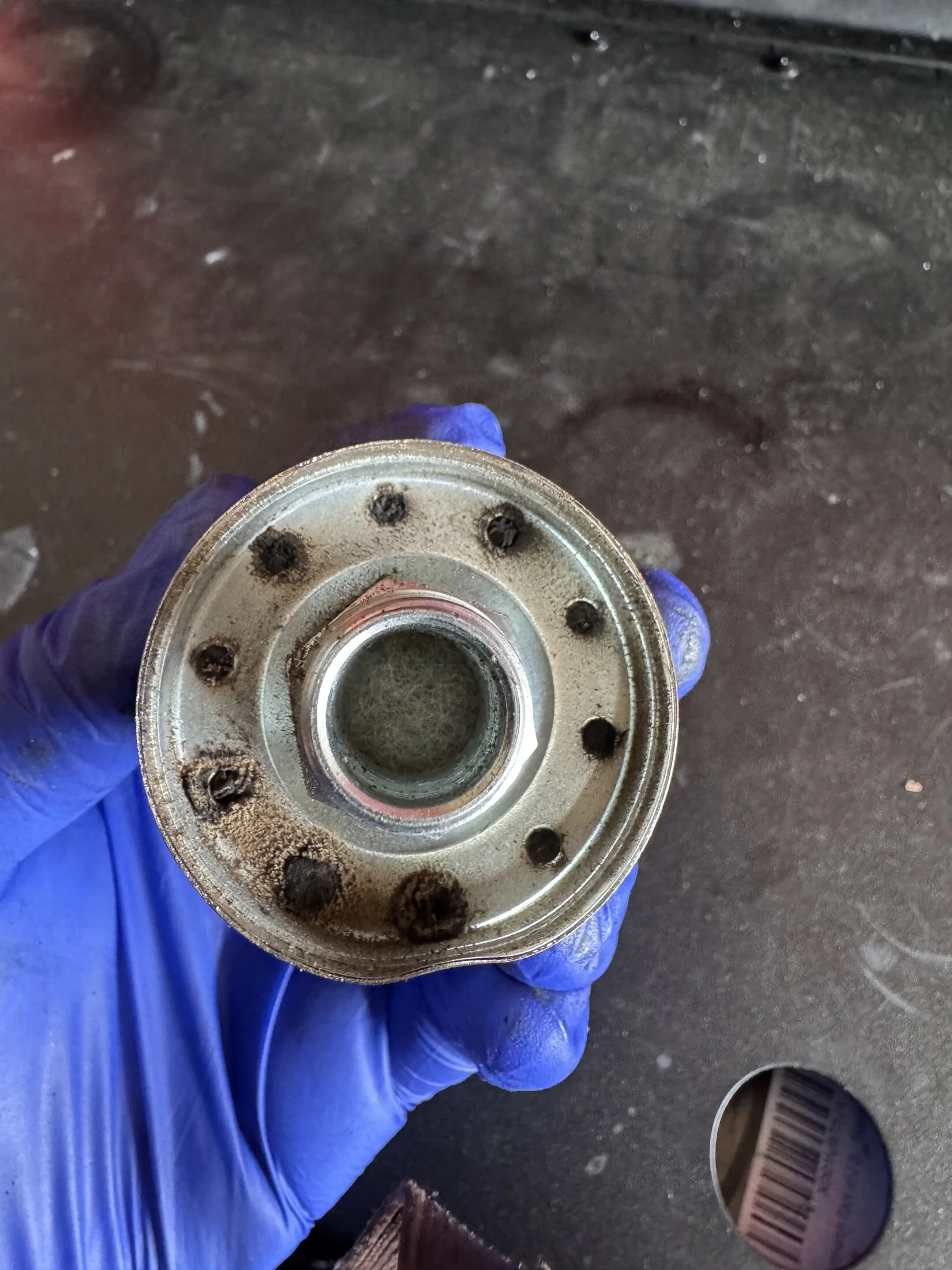

Just cleaned my breather and it fixed my slow fill issues. I noticed my installer used a different breather than those shown in this thread and he says they do well in all his installs. It’s from NAPA and was super easy to clean.
