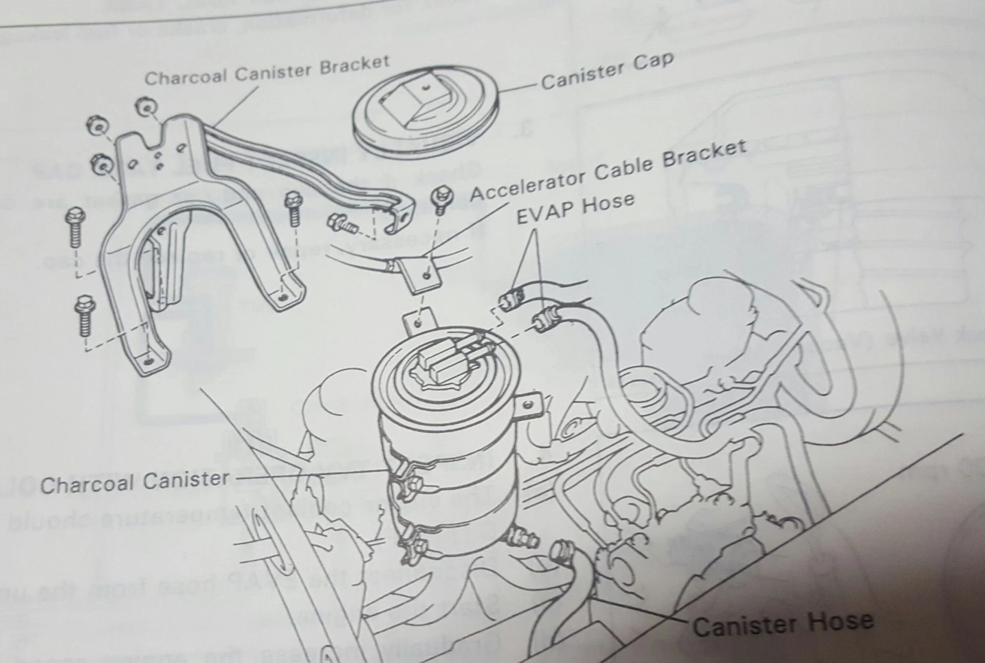

Here's the FSM page on the OEM Canister, showing the lines for Tank, Purge, and air.

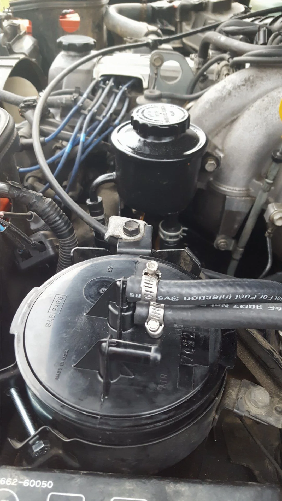

Here's the AC Delco setup. It comes capped from the factory, but I removed the cap from the air line and left it open to replicate the bottom hose of the original set up.
As others have said, I deleted the bottom bracket and used an extended bolt for the top. The bolt I used was an M6-1X50. It's just long enough to work. I also just left the air line open, as I don't see too much purpose in routing it down to the frame, but if someone convinces me otherwise, I'll add a hose there.
I also replaced the hoses, and hose clamps. I found the small section of old hose on the purge end was extremely loose, and may have been leaking.
