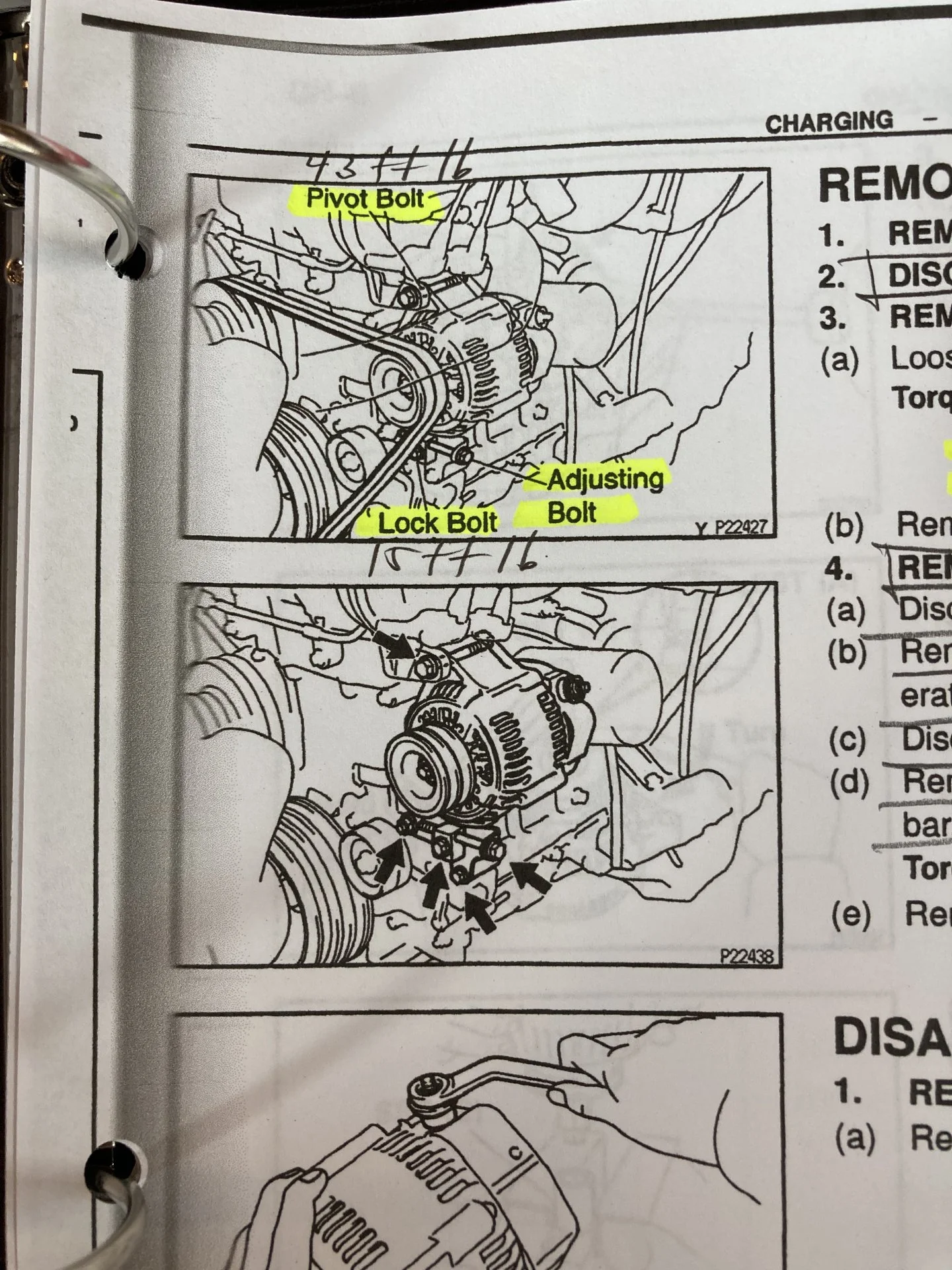

It's plainly visible in photo 18. I can see mine with the battery box in. I don't remove the box to change belts.
This picture literally already has them highlighted and clearly shown in yours and FSM. It won't take long to find or put a bolt on just get in there and you'll see

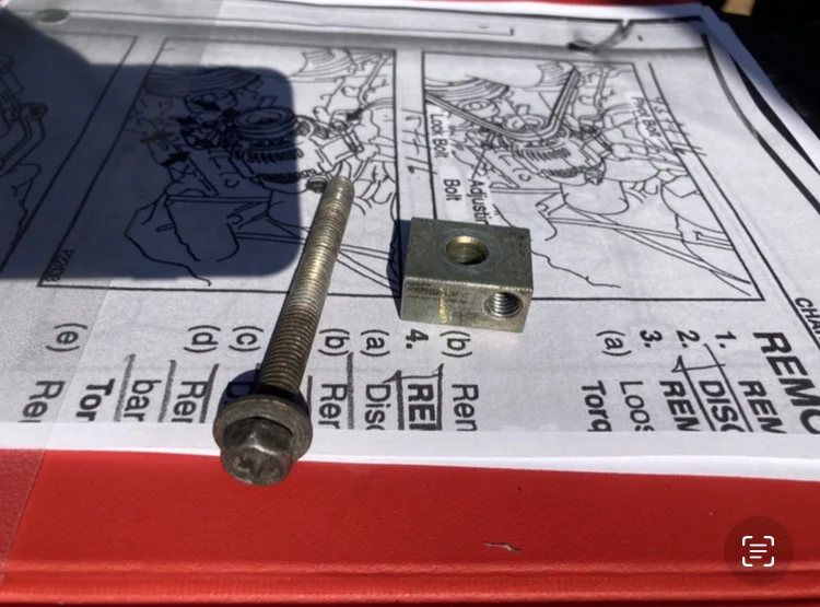

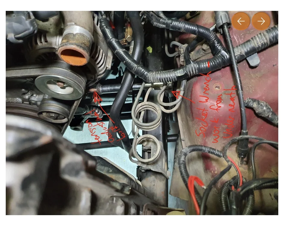

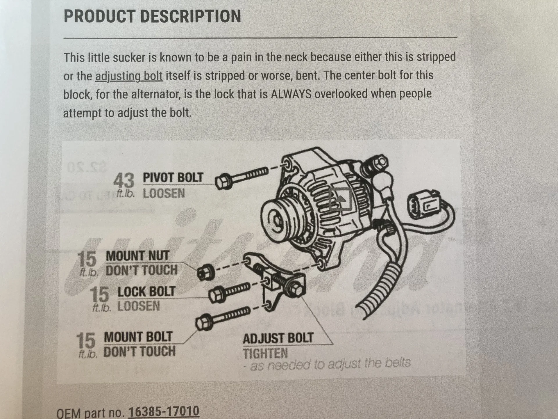

anyway here is the intel from joey. some of these you can't see when wrenching on the actual vehicle. this is why i am asking.
also not w equine oboes the names for them so it helps to list them and number them so you are not missing anything.
when it is laid out like this i can see i need to find the pivot bolt by feel and also the lock bolt by feel.
if anyone has photos of those without the radiator removed it would be good to see.

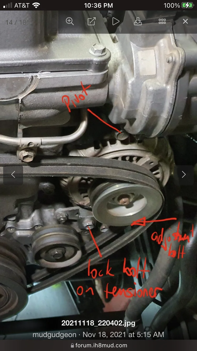

No, the one you wrote "18" on
here is what you have to love about romero. instead of having a mini stroke every time a new wrench can't find a part on his truck because he can't see it or isn't sure what he is supposed do or if he is supposed to turn it clockwise or counterclockwise to loosen - in part because he doesn't even know the name - not only does he supply the part to buy he tells you how to avoid bitching it.
thank man. i appreciate that.

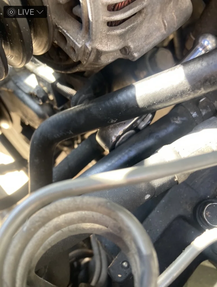

i still can't see it which is sort of what i was hoping to do before i am up under it or trying to find it going down from the top or from the side.
i mean i get that i can see it in the FSM but it is helpful to know where it is in a view like this.
i do see the belt tensioner here and i can get at that from where the battery box used to be. it's a straight shot to the tensioner from there.
but i can't really see that pivot bolt from this view and i can't see the lock bolt from this view.
also i am getting at those two from on top of the truck?
the pivot bolt especially. it needs 43 ft lb which is a bit of a heavy lean with 12"+ of extender on there? i mean i don't think you can get at it in a straight shot or see it even. you have to come down from the top and find it blind i think?

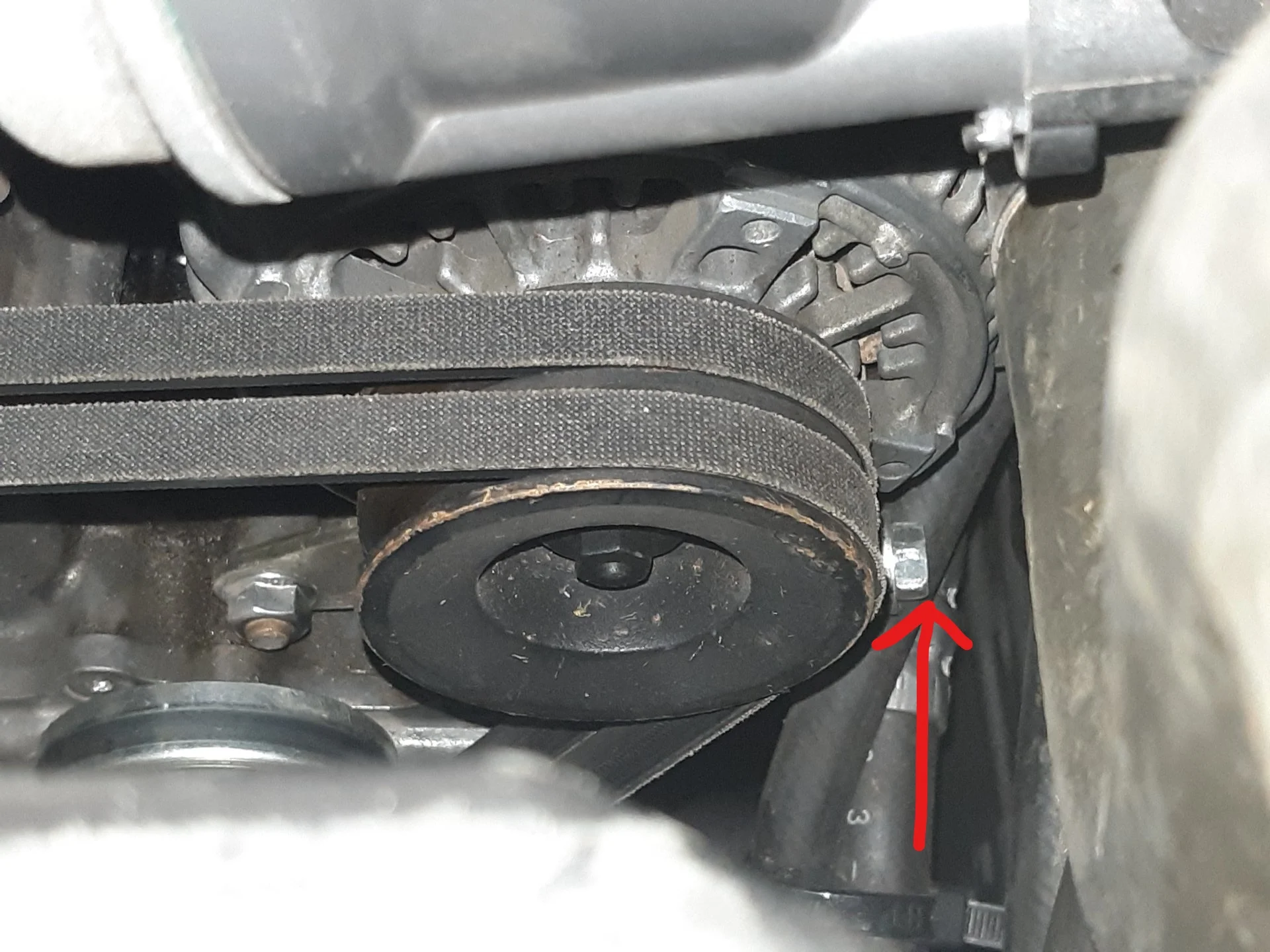

Here's the front of my truck. Both plainly visible.
No, you can't see the pivot bolt from that view because you're under the truck - the pivot bolt is on top. If 43 is hard on your torque wrench, get a bigger wrench.

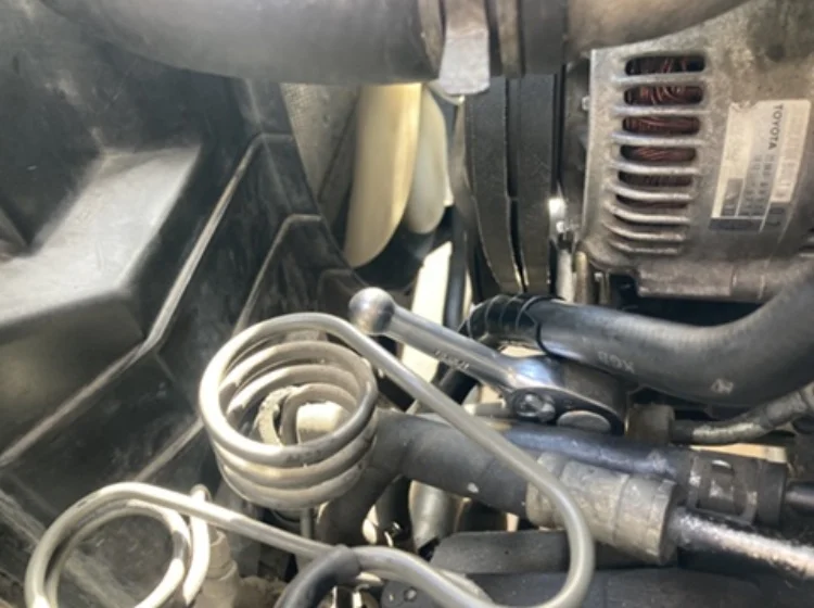

A mirror, or smart phone photo takes care of what you can't easily see.
I regularly use my smart phone to "look at" things I can't see directly.
There's no need to remove battery tray.
You don't need to see a bolt head to undo it.
You can see where they are enough to locate them, then feel to place a socket on the bolt. Then, rub your tummy, and pat your head.
Well, not really, but there's no more trick to it.

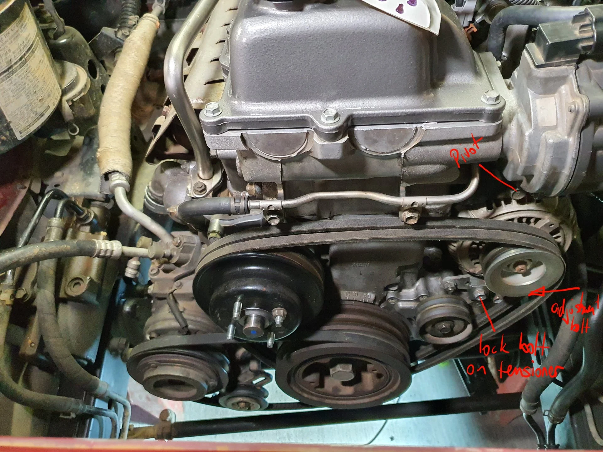

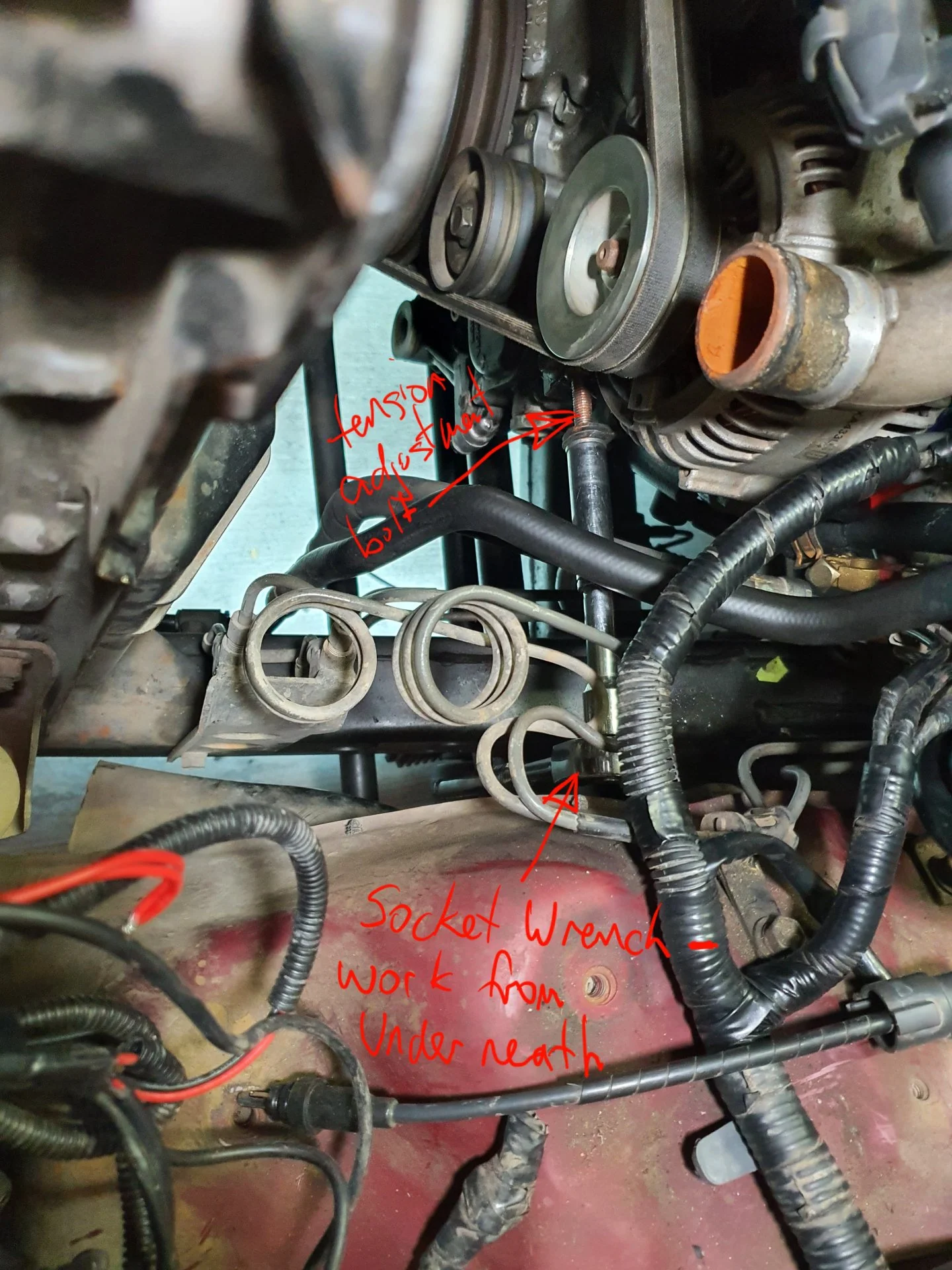

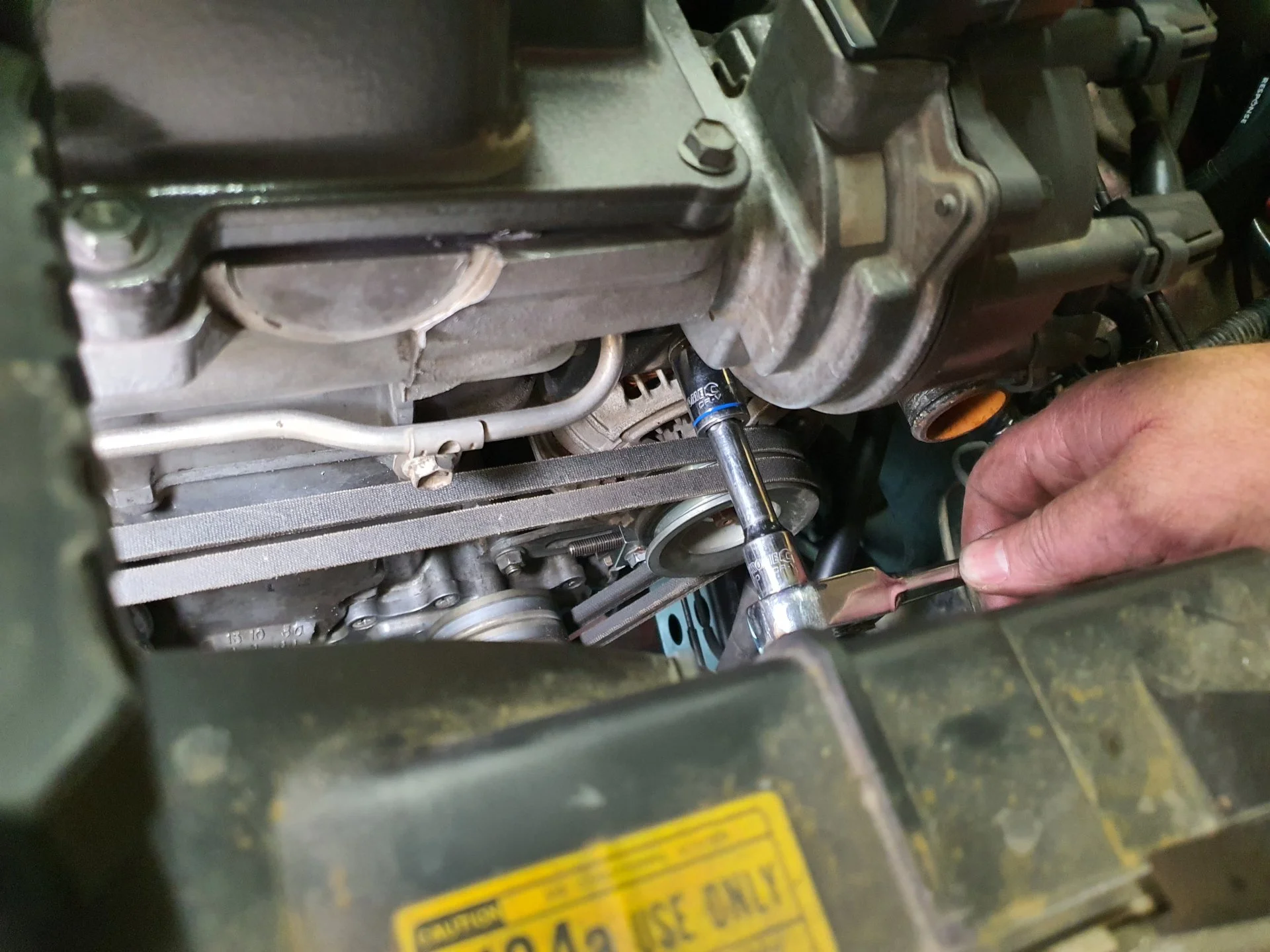

Loosen lock and pivot bolts ½ to ¾ turn. Just enough to take tension off the bolt

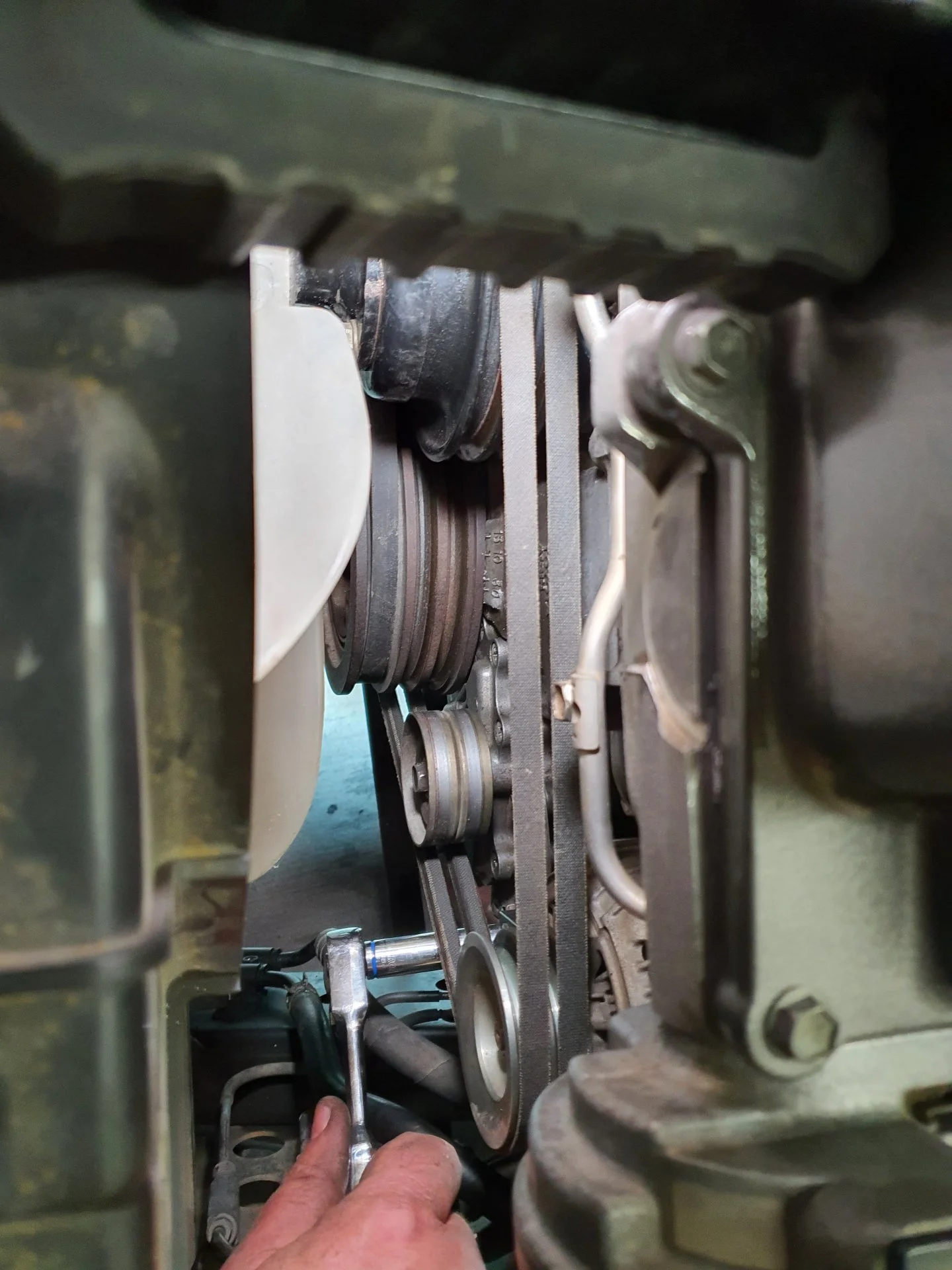

Alternator and AC tension adjustment bolts are accessible from underneath. The alternator adjustment bolt is more accessible if you push the rubber inner fender skirt out of the way.
Pics were taken while I was completing other work.
Normally, I would change belts with fan, shroud, battery box etc in place.
AC pulley is best accessed from underneath
great pics. thanks for posting them. i'm sure others doing the job for the first time will appreciate it.

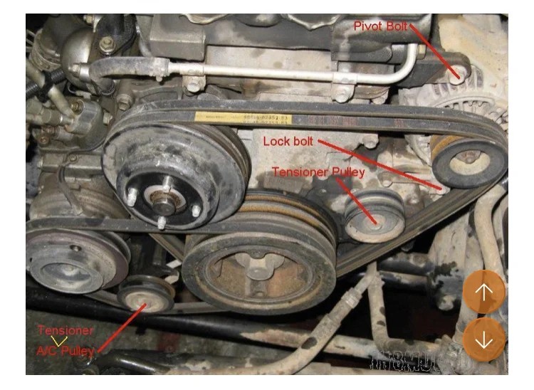

for the first time in i found the AC compressor tensioner to be a little hard to understand. somehow it is counterintuitive in a way. even after working on it i find it is sort of counterintuitive. until you work on one it can be tricky and i didn't see anything here that explains it well. so a term like "lock nut" is not easy to understand until you work on one.
also the alternator belt tensioner i couldn't see in the truck and the fiche doesn't have very good diagrams. so it wasn't until i saw joeys information and the two parts on his site that i knew what i was looking for or what was getting loosened. it's not the kind of assembly you would understand unless you had worked on cars before.
i actually did use a mirror from my motorcycle toolkit and realized the pivot bolt was right there but the tensioner assembly you still can't see very well. so it wasn't until i pulled it and cleaned it and made sure the bolt wasn't bent or cross threaded that i understood how it works (pic below) so also reading a term like "lock nut" or "block" for the alternator tensioner was confusing.
also i still don't quite understand why you loosen the pivot bolt on the compressor.

oh two more. for the AC compressor tensioner i just kind of pulled it downward and locked the lock nut with tension on the pulley. then adjusted the lock bolt. for the alternator belt tensioner i just threaded the tensioner bolt in until it bottomed out at the "base" of the tensioner block so it was fully inserted. then i think i put tension on the belts by pulling on it while i locked the block in place. then i adjusted the alternator tensioner bolt. HTH

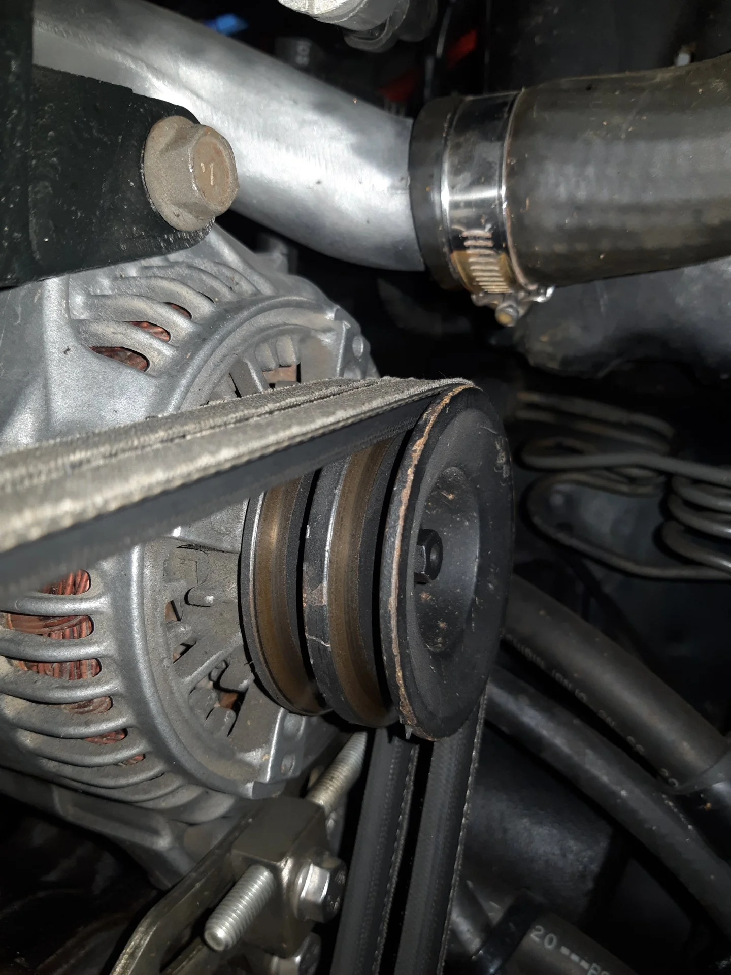

The compressor is fixed in place, doesn't pivot.
The alternator pivot bolt needs to be loosen because the clamping force of the bolt, and years of corrosion etc will stop the alternator from pivoting.
You'll potentially strip threads off the adjustment bolt if you force it

Reach in over the top of the radiator and push the belt downwards with your thumb.
The belt should not deflect more than about ⅜ or 10mm (use reasonable amount of pressure with your thumb, but don't go bruising your thumb)

hey mudgudgeon. thanks again for the pics. i think new wrenches that come along will find them useful. at a minimum they won't have to ask for them!
i rotated one because it originally looked a little bit like you were doing the alternator tensioner bolt from below which i found confusing at first.
also just to be clear you have the radiator pulled to get these shots. you can't see this with the front end still fully assembled.
i mean this is why folks earlier have had trouble with the tensioner bolts and blocks...
