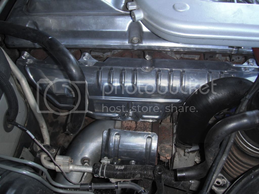

Ceramic coated my exhaust manifolds
Looks good. Been wanting to do the same thing but haven't found a local shop and also wanted to have the exhaust gas temp probe ordered and installed in the manifold prior to refinish.

So far really happy with this mod. Its noticeable how much warmer the engine bay is on my friend's LC vs mine now. More of the heat is going out the exhaust instead of heat soaking into the engine bay. I need to get one of those laser temp guns and quantify the results. :P

I had the dump pipe on my 1hd-ft ceramic coated some 2 years ago.
& recently had some new heat shields ceramic coated aswell.
But as you can see it does fade over time.
However i can run my fingers over the dump pipe after about 5 mins of shutting the motor down with out burning my finger's.
The heat shields where done to protect the intercooler hose.
& in time ill have the exhuast manifolds as well as the turbo done.
Apparently it all aids in the spool up of the turbo.
Hamo
