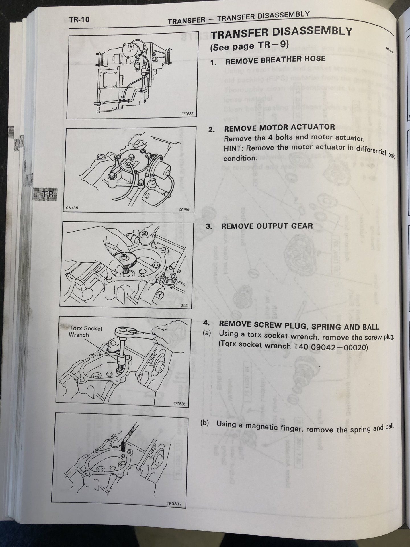

Actuator out, stupid easy, 30 mins work!
Anyways, zero corrosion, motor gear turns when xfer shifted. I can reach in and spin the driven gear by finger, not stuck in either way.
Gear rotated about 180 degrees.
I pulled the actuator off with lever in H. When I was removing it I heard a spring lightly go twang? 🤔
So I am going to remove both driveshafts and try and spin the outputs to see if I can get it to engage by hand.
I think this actuator has been off before and maybe it was installed incorrectly?
Can I just jack one rear tire and spin that to try and engage instead of removing the driveshafts? Thought I read that somewhere?
I once removed the actuator without putting it in the locked position and problems ensued. However, I was disassembling the unit for low range gears and spool install, you are not. I was unable to remove the driven gears so this may not apply to you, not yet anyway.... 😁
Thanks, I have the FSM, why anybody would not one is beyond me!
Anyways.....success :clap: !!
Sure enough, whoever was in there before did something incorrectly. I suspect fork not locked but CDL motor in locked position!
I jacked rh rear, spun driven gear by hand while moving tire with foot. I could put my pinky down the hole for the front locked switch and sure enough the ramp on the shaft was now up where it was supposed to be. I then screwed in the switch and verified continuity. Plugged in switch and had lights!
