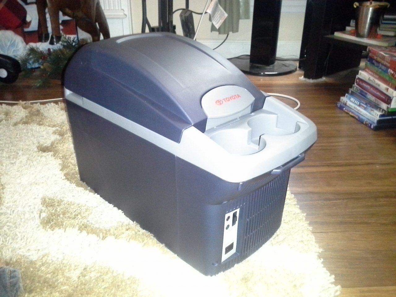

Or you could be cool and get one from Mr. T!
Mine heats and cools.:D
FWIW, it came from Singapore, but is OEM.
See.
Seeing that it heats and cools would lead me to believe it's a thermoelectric cooler and doesn't get as cold as a regular fridge like the Dometic. Just a guess though.
