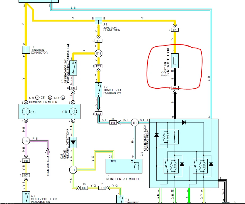

I'm not finding the wiring diagram or pin outs for the CDL switch on the dash in my EWD. If you know which page it resides, lmk please.
I'm trying to figure out why the CDL relay controller (left side of kick panel) isn't getting power from the CDL switch. I do have the pin 7 mod and the whole thing has been working flawlessly for years until last week when I was at the Dollhouse and heading out of the park.

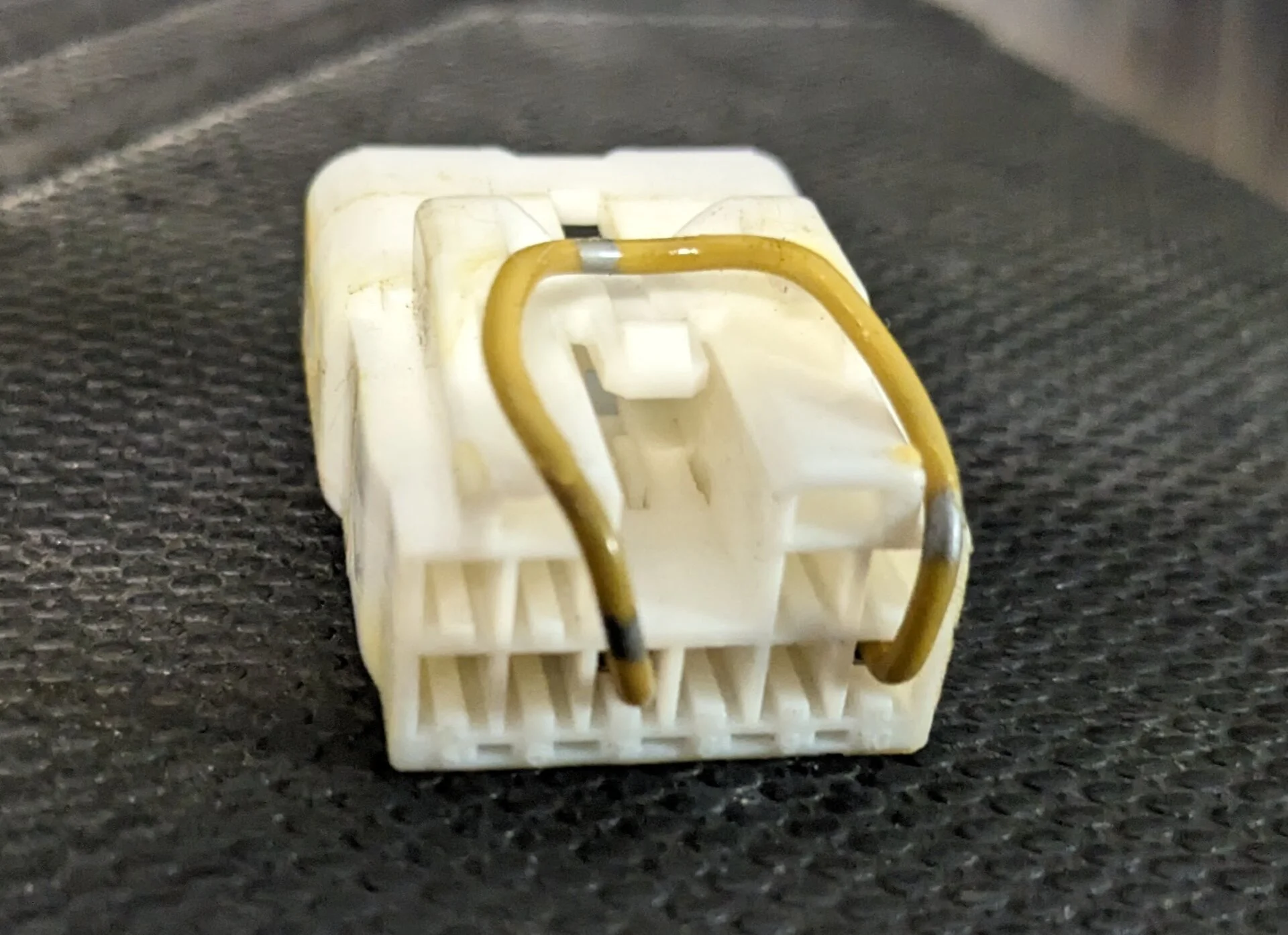

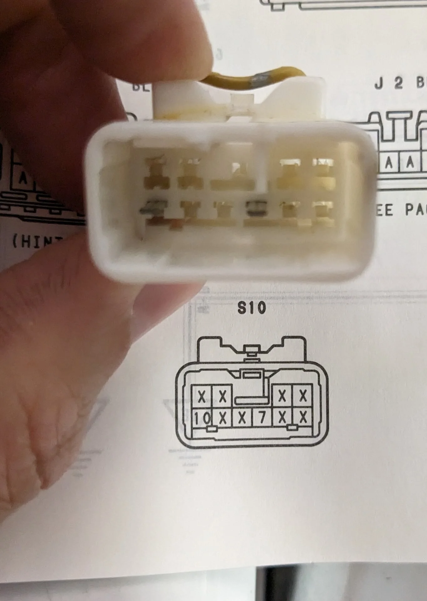

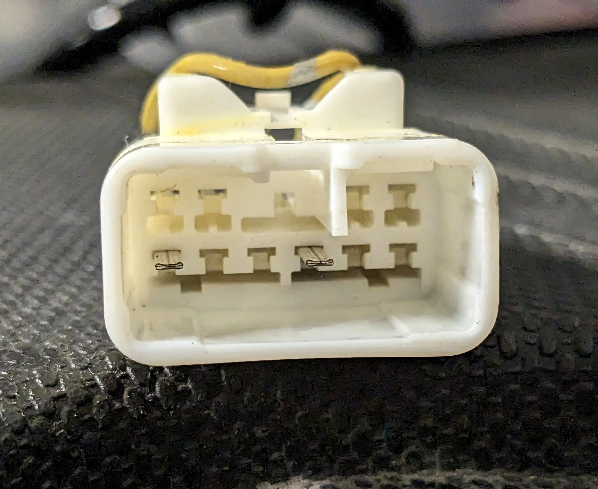

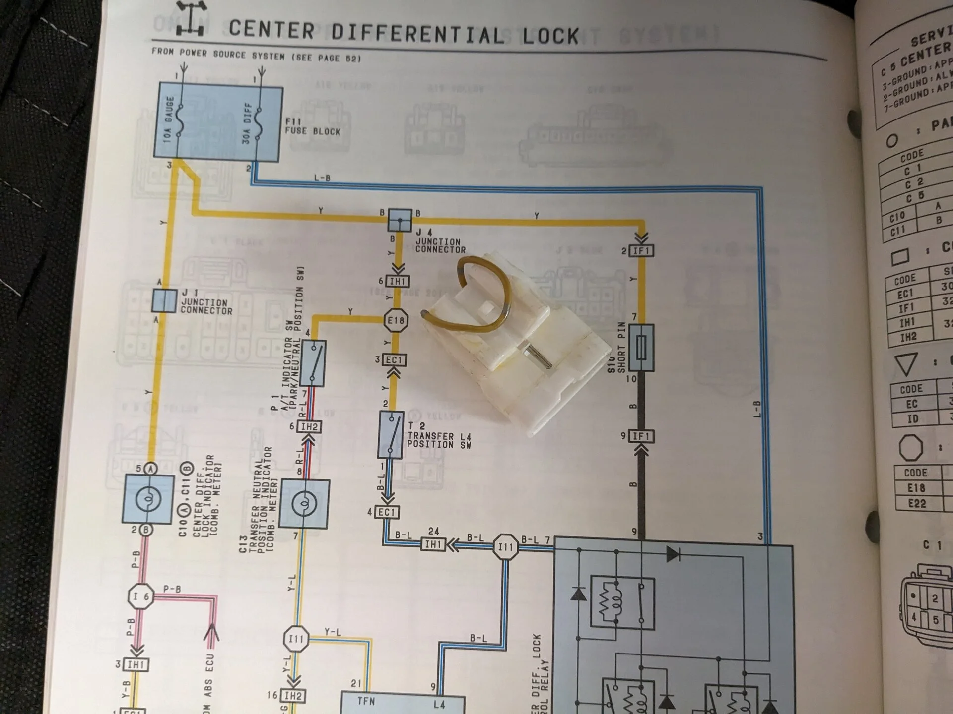

Wait, I think I figured it out but please check me. Pin 7 and 10 on the "SHORT PIN CENTER DIFF" is where the CDL switch does the switching. It's been so long since I removed this shorting pin jumper thing and plugged the harness into the CDL switch, I forgot this little gem.

oh crap, THAT'S what it looks like? Man, that's going back a ways!!
Thanks for the pics.
