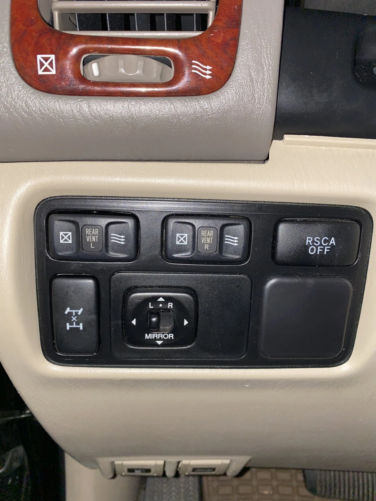

I finally got this in. That’s currently my left panel. I disconnected the TPMS switch to make space for the CDL switch. My right knee can now safely rest on the right panel when driving!
I still need to wire it into the dimmer switch, I just needed a couple more crimp connectors.
@Ayune i found that my 2006 had a different connector for the CDL switch/hazard/antenna, but I was able to figure out what pins were the NC, COM, & NO for the CDL and wire those up to the relay. Lesson learned: don’t cut all three wires at once before labeling them. That added some time to this project haha.
My plan is to go back to my notes and post those up so others in my situation will know what wires to where. As well as the harness for the GX470 switch.
