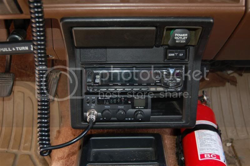

I put mine under the radio in my 86. I cut the pocket down and remounted it for cell phone, pens, stuff like that. No interference from the radio.
Where I put mine. It's mounted to the bottom of the pocket. I like the little Uniden radios, in this case a 520.

Usually you have to trim a little bit of the plastic to get a radio to fit in the change tray portion of the dash.
Just get the right tool and cut away.
