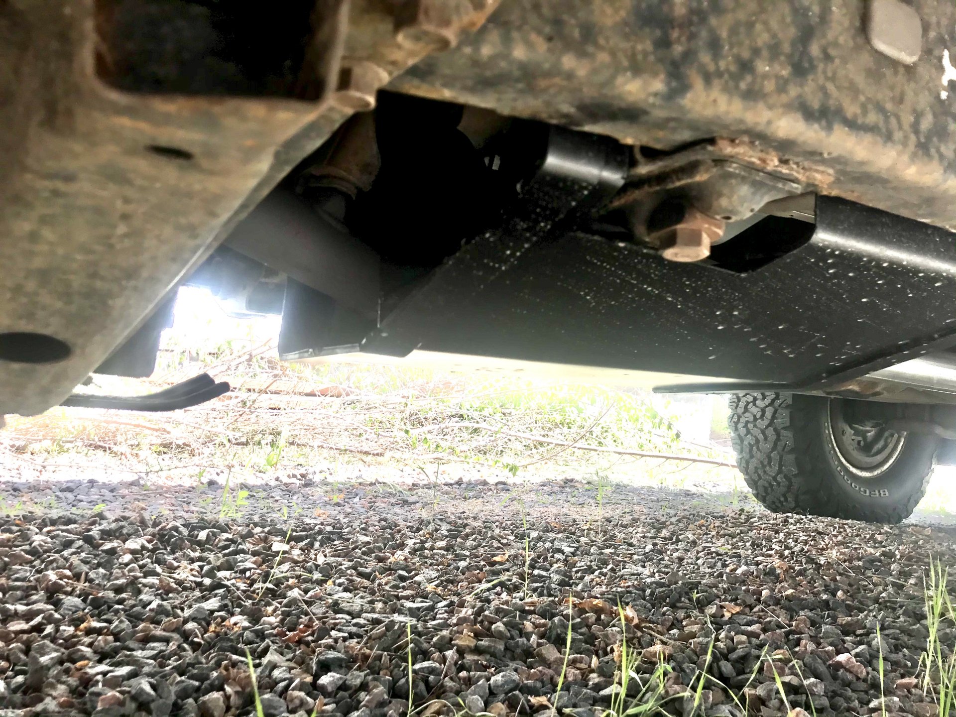

@Just Diddly , after the first oxygen sensor, the pipes got bumped to 2.5 inches, into a single, generic, 3-Way catalytic converter. Next, the second oxygen sensor, then into a Dynomax 17615 turbo muffler, custom tail piping out the back to a small resonator. It is a touch louder than I would like, but overall pretty good, and I’m happy with it.
I did NOT go over the frame, but with the cat horizontal, and tucked closer to the frame, I still picked up about 2.5” of clearance.
Awesome, thank you!
