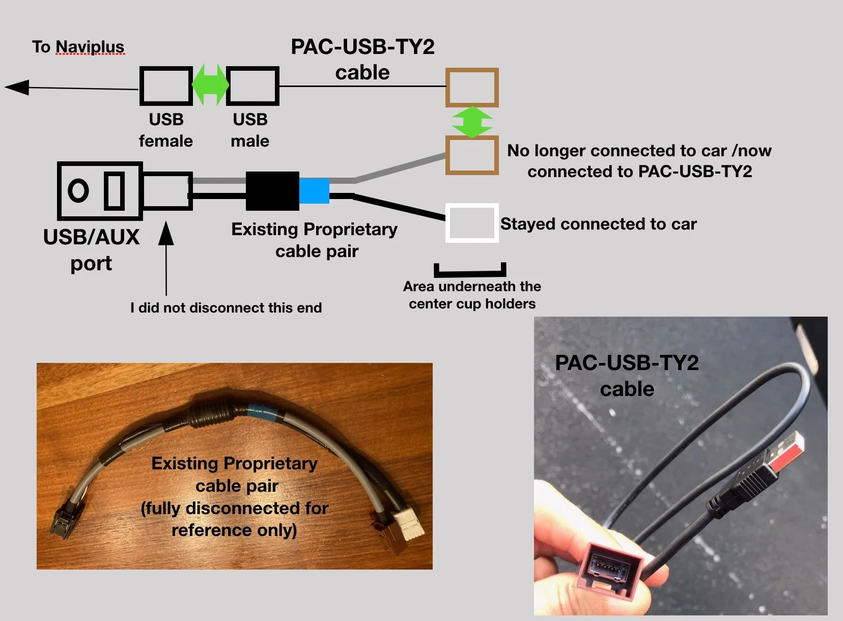

@FLGT from what I could see, the PAC USB-TY2 is only a USB converter that plugs into the cable coming from the stock headunit, and only the USB portion of that cable. It does not plug into the stock USB/AUX module. The stock USB insert (the module that plus into the center console) has several pins. I can't believe I didn't take a picture of it, but there seems to be more pins than needed for USB and stereo AUX. I'm guessing those extra pins are connected to some sort of resistor or something in the module that tells the stock head unit that the module exists/is working. I tried unplugging the module so that I could pull the NP-included female USB up through the hole. When it was out, I confirmed that the PAC USB-TY2 wouldn't plug into it. With the module out, the AUX input disappeared from the AUDIO options list on the headunit. I'm not sure if this is something that's on 2016+ MY vehicles, or maybe 2018+? I do not have the rear entertainment system. I hope that helps. Let me know if you have any other questions.

There may be some confusion about how the PAC-USB-TY2 cable was utilized, at least in my application. Firstly, as joltman described - it is USB only. Secondly, I could not connect it to the black USB/AUX port (socket) on the center console - because it has a different connector.
Below is a diagram of how I used the PAC-USB-TY2 cable for my particular set-up.
Hence, I did not unplug the existing black connector (on one end of the existing proprietary cable pair) from the USB/AUX port, I simply left that end untouched. I found that the other end of this existing proprietary cable pair ran toward the center cup holder area - one terminating to a brown connector and the other to a white connector. These connectors are situated directly underneath the center console cup holders (first picture in my original post) protected by a light gray plastic cover. I removed the gray plastic cover and disconnected only the brown connector from my LC and connected this directly to the PAC-USB-TY2 cable. Then I connected the other end of the PAC-USB-TY2 cable (which is a male USB plug) to the female end of the Naviplus USB cable.
The result was I sacrificed the USB connection to Entune for a direct wired connection to Carplay using the original USB socket.
VERY VERY HELPFUL. Thanks!
