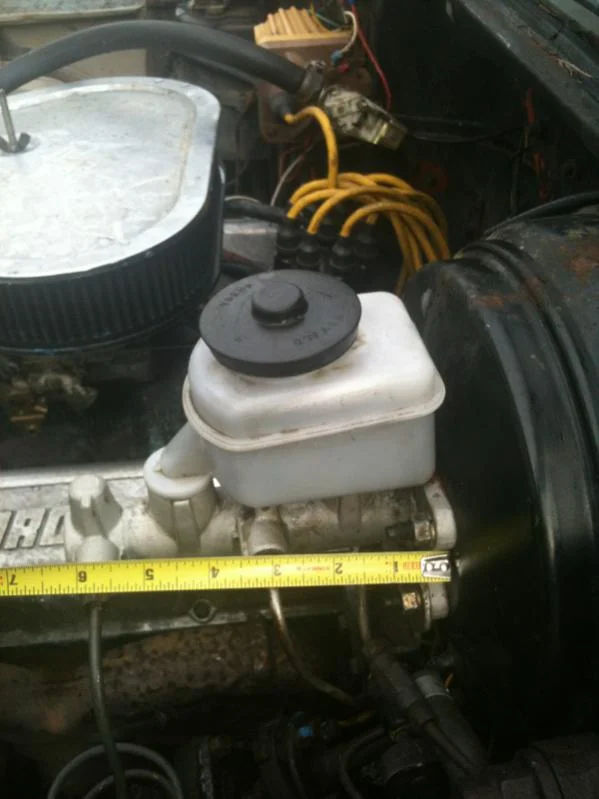

I know this has been answered, but I cannot find it. A 69 cruiser has a 4 wheel disc brake upgrade with a booster and master cylinder. The booster is extended beyond the support on the firewall. The new carb has a secondary that competes for the same space as the end of the master. The answer for the seller was to remove the secondary! I don't want to cripple the carb. I can't find a carb that will work with the booster/master combo, which I also don't want to do without. Considering other carb options. Longer term, I was going to go with a TBI, Holley or Howell or ?. I'm not trying to turn the '74 F.5 tractor motor with a 2F head into a hot rod, just get the best out of the engine rebuild without sacrificing braking. Thoughts, anyone? TIA.

An 80 series master is shorter…
Don’t know if it’s enough shorter, but my $.02
