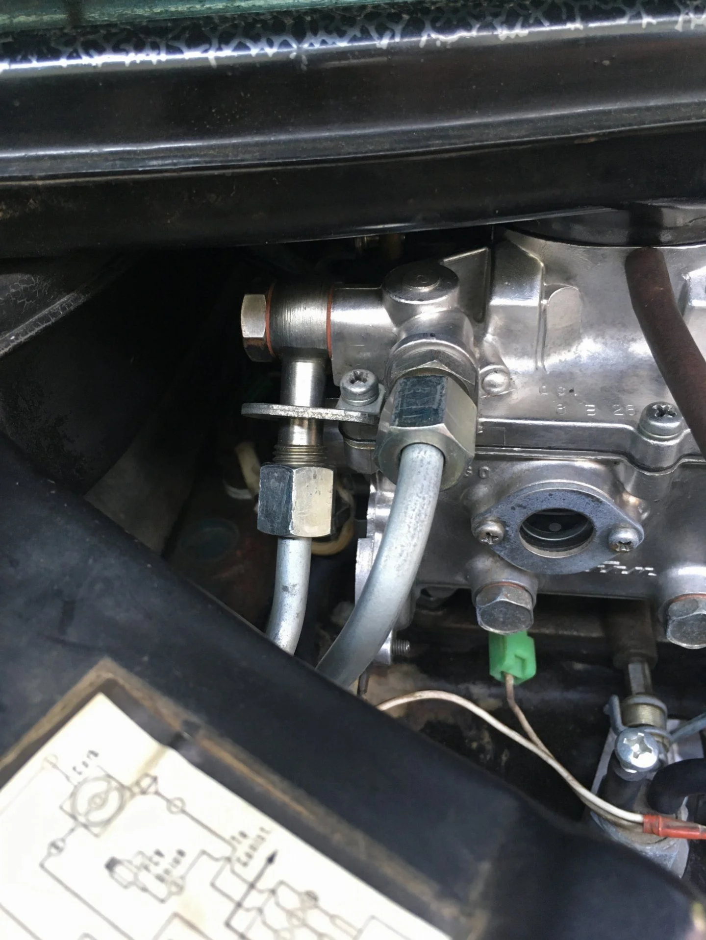

Another random thought, did you double check that your fuel supply and return line got hooked up correctly?

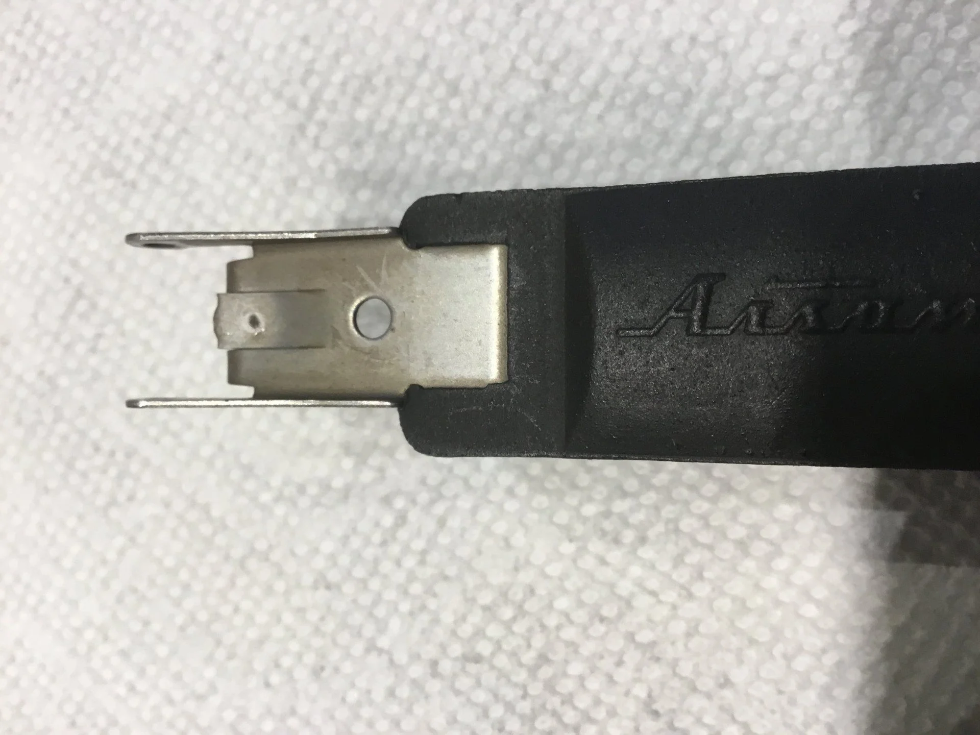

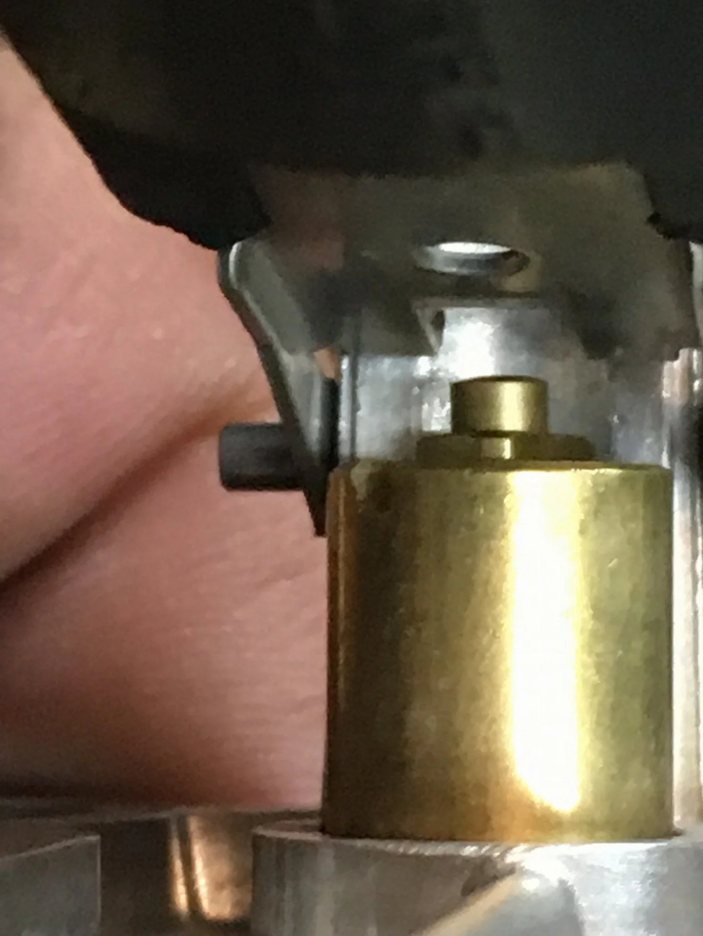

It's 1.1mm. Gently lift the float and it's the gap between the top of the needle and float tab...probably saying something you already know but there it is.
Not busticated. Just adjusted up.I don't see the tab. It seems to be busticated off.
OMG. Could someone tell me which port on the Aisin carb is inlet and which is outlet. If this is the problem I'm gonna scream.
Just returned from test drive on highway. Running like a champ. Eating a ton of gas, but I guess that's a 40. Thanks again for all your help. And a huge thanks to the community.That would definitely explain it. You have to work hard to get them mixed up, so you don't run into this very often
That was it. Thanks for that.Another random thought, did you double check that your fuel supply and return line got hooked up correctly?
