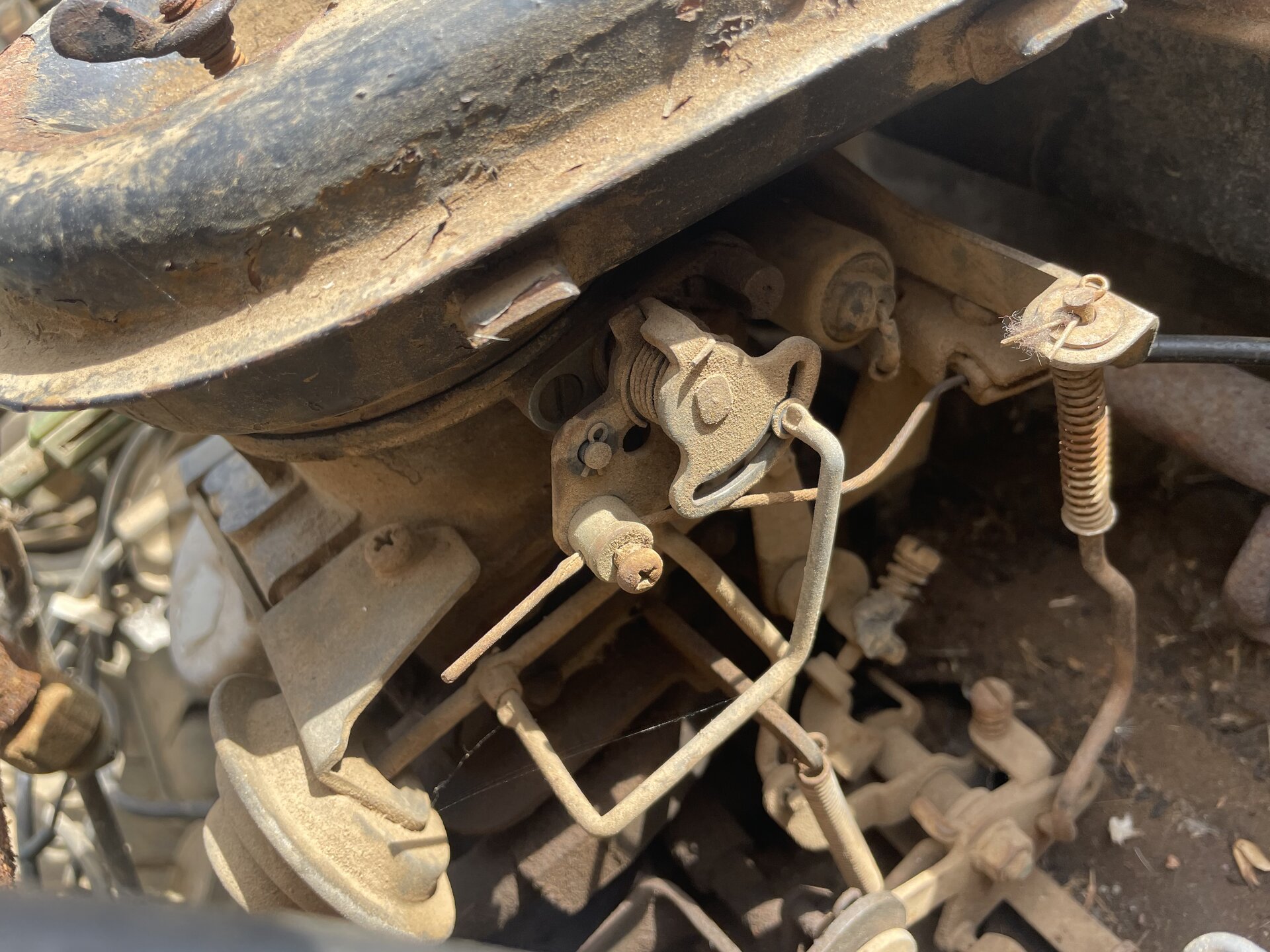

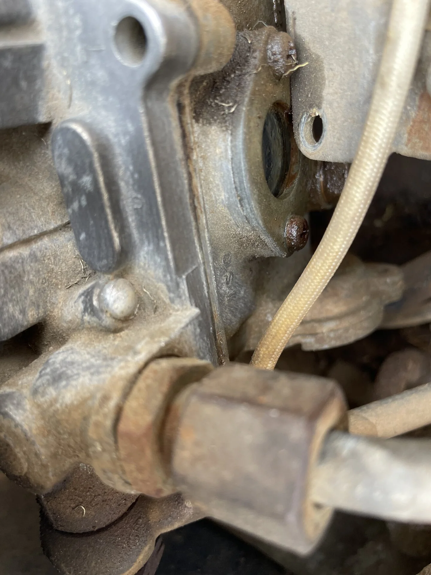

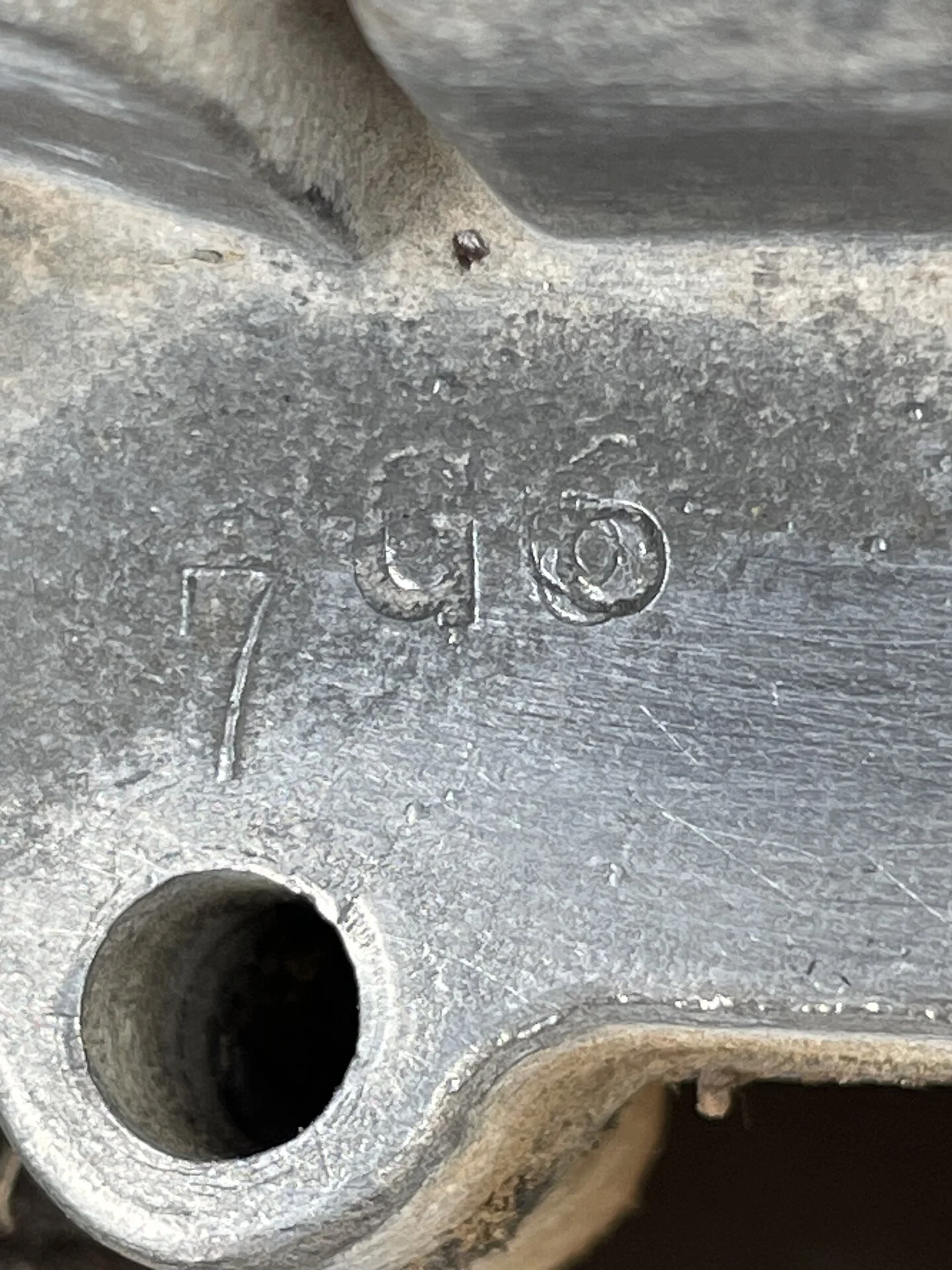

My 1977 fj40 (July 1977 build ) needs a carb rebuild. Does anyone know the kit I need? Can’t find the tag and sticker is worn off. Found a 7G6 on top? Thanks in advance

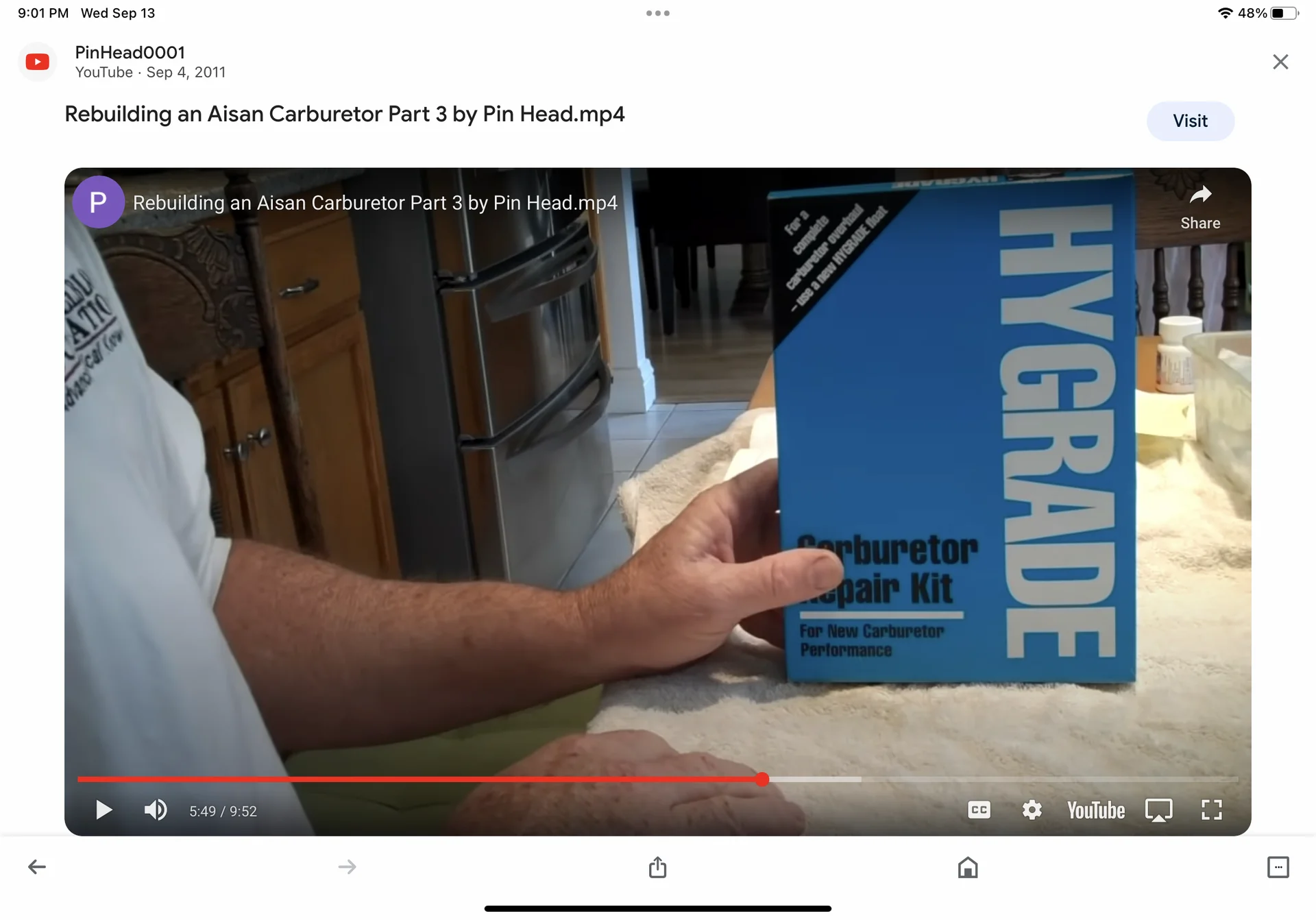

Thanks I followed his videos on my fj60 carb rebuild. I need a carb kit for my 1977. Does he have a shop and sell kits?
He does not have a shop, and he does not sell parts. He makes great carb rebuild videos though. Contact CruiserOutfitters for the proper rebuild kit for your year carb.

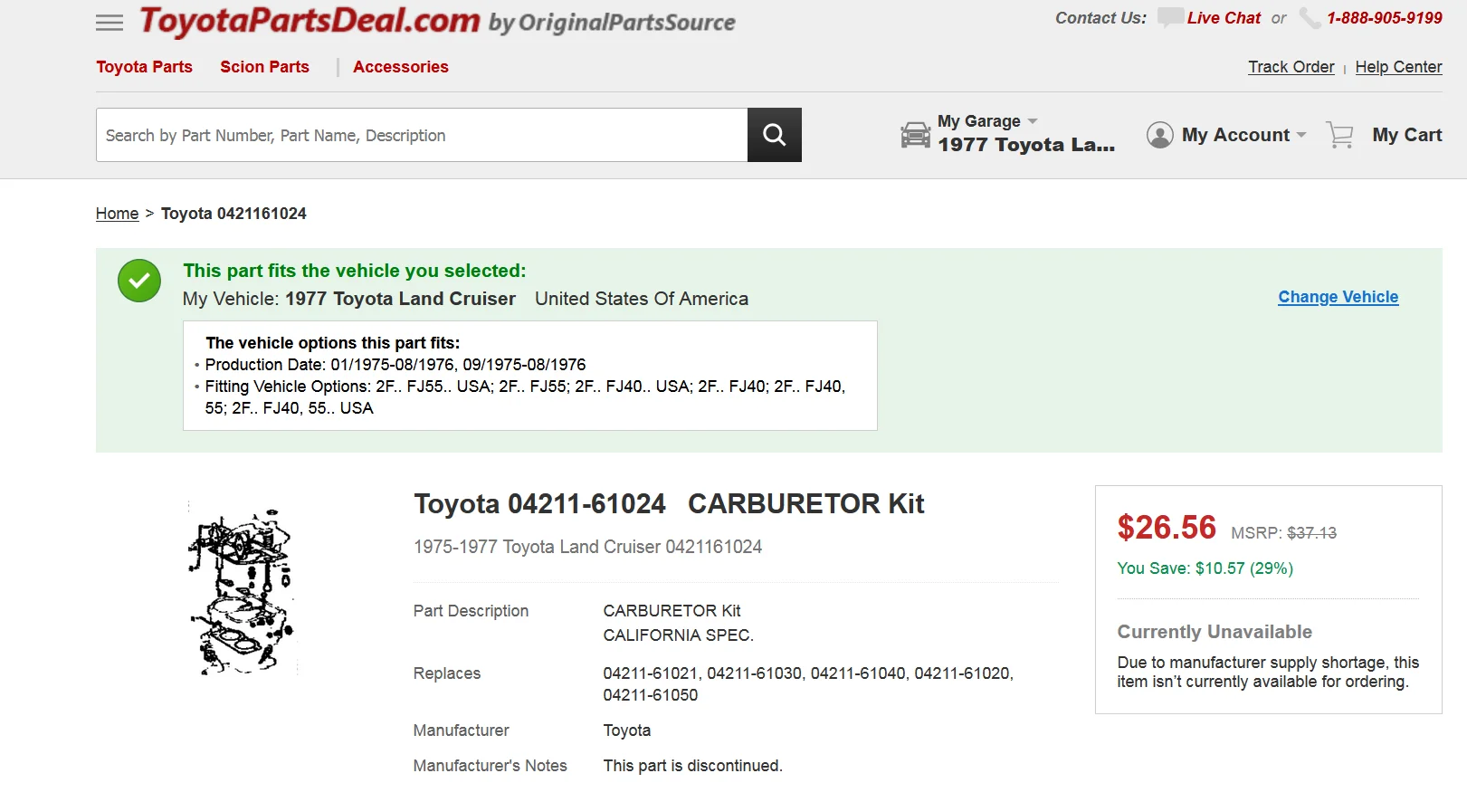

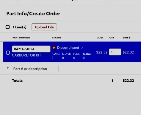

04211-61030 (which is the kit for 1977) shows superseded by -61024

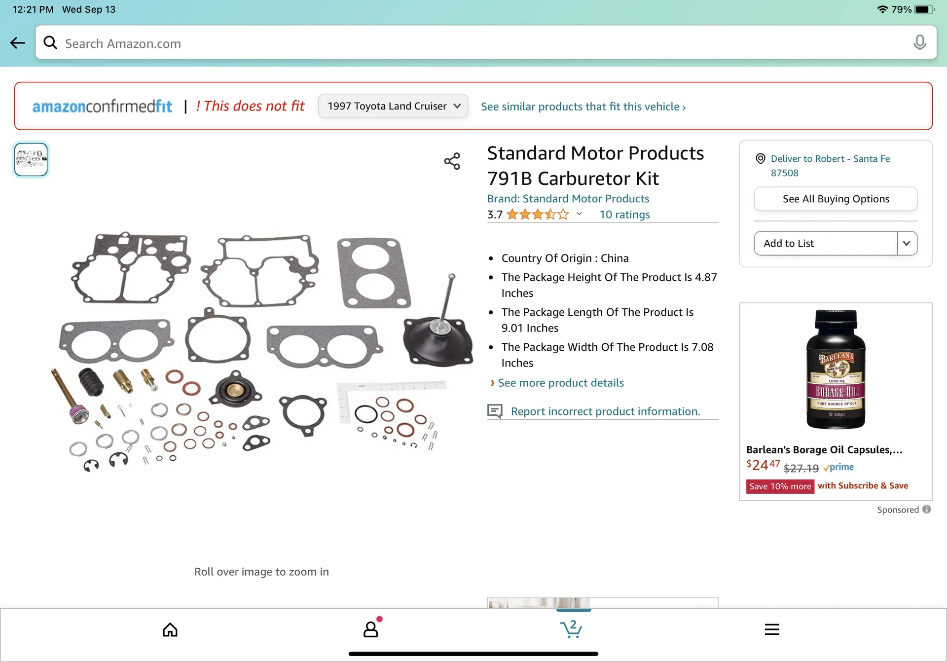

The carb kit is not available from Toyota in the US.

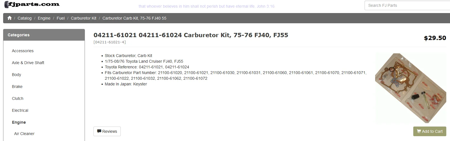

The only carb kit still available is for the 21100-61012 non-US general market carburetor. And that kit is only available from abroad.
I‘d recommend contacting Cruiser Outfitters for the Kyster Japanese aftermarket kit.
The Gold Standard on carb rebuilds are videos @Pin_Head produced. Here is his go to kit…..
It’s not like I made an informed decision or exercised discretion. I needed a kit and this was the only one my local parts store had in stock. I was just happy that they had one and I didn’t have to order it and wait for delivery.
