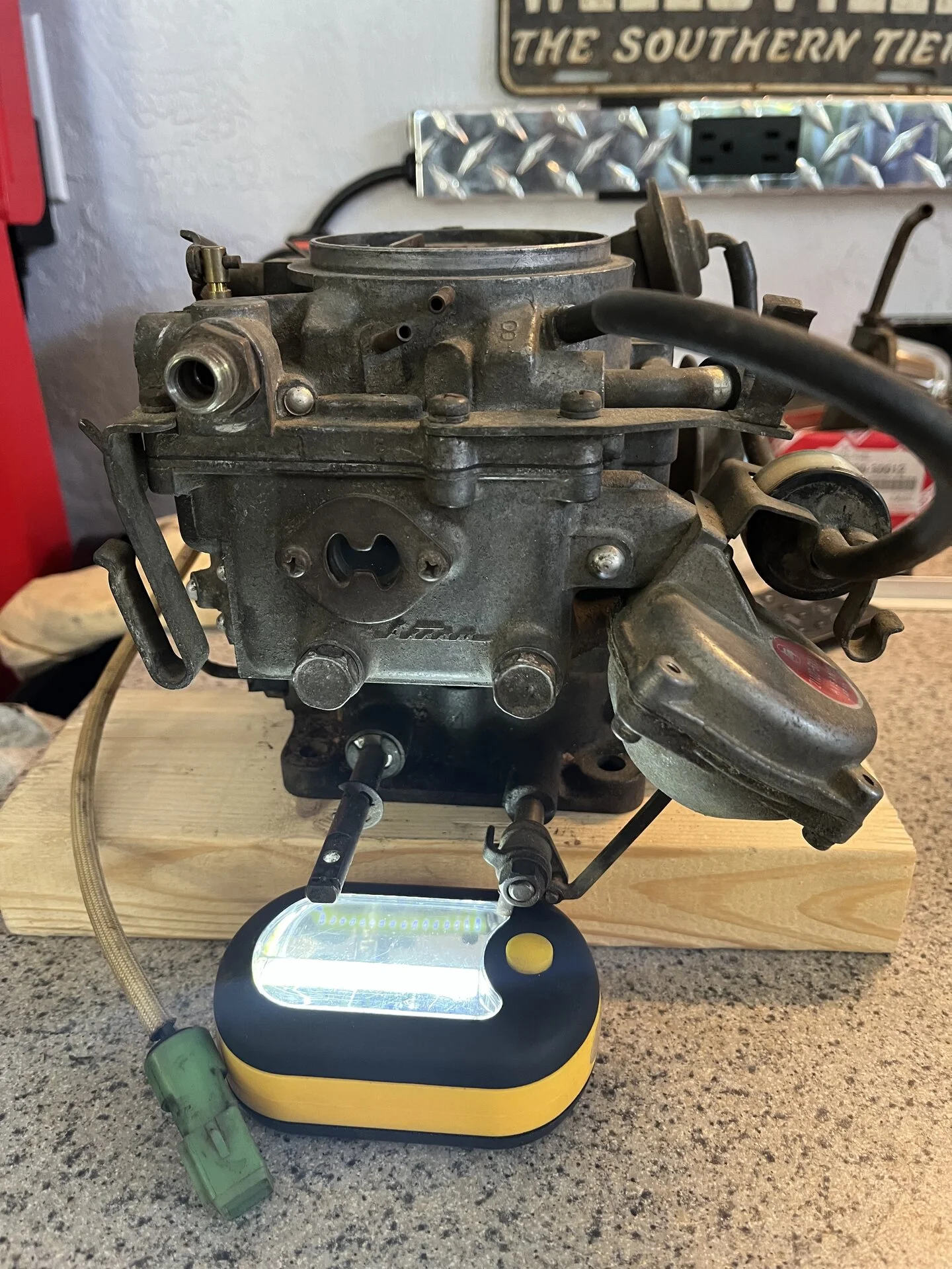

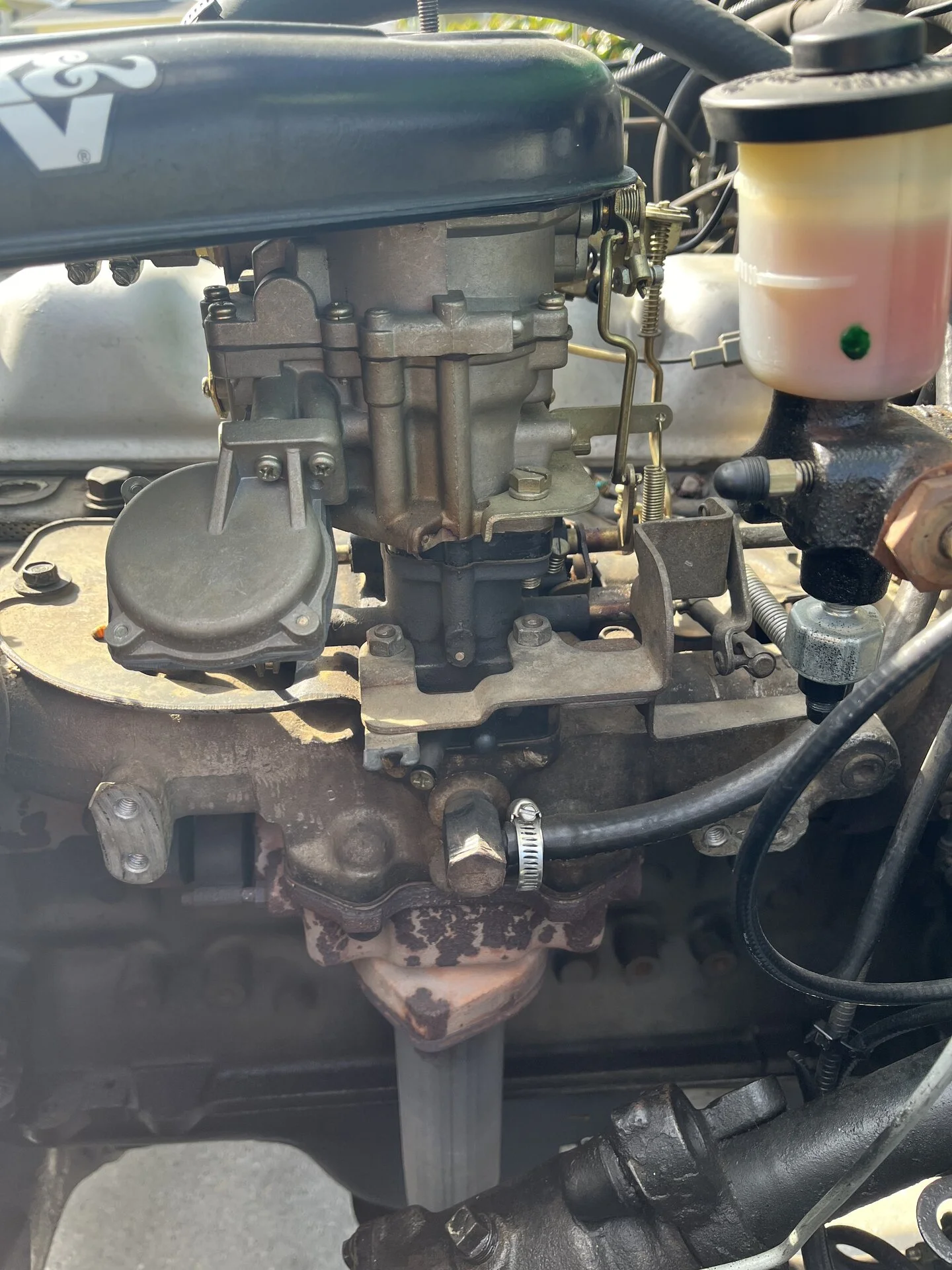

Carb jet size
Your OEM carb is 147 primary and 200 main. Slow Jets are 65 primary and 90 main.
Trollhole would be 138 primary and 200 main. Slow jets I've never checked but should be in the same range of 65 and 90.
Thanks Nate! I appreciate your response. Do you know where I can buy new jets?
Thanks
Mike
Mikuni spare jets I've seen folks use, but never personally. Toyota discontinued recently unfortunately.
Depending on the sizes you want/need I have a number of spares.
