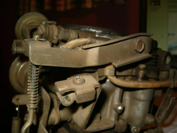

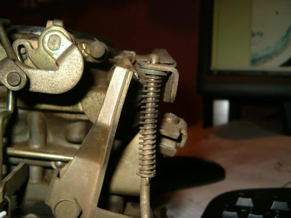

My truck has been running very poorly lately. It will stall out unless I have the choke pulled. I opened the hood and found a spring laying under the carb. Where should this spring be?
Here is where I found the spring:
the spring:
I think that the spring belongs on this shaft:

Check out these cab pics from a spare FJ60 carb-the function of that spring is the same, and it's attached to the mechanism that controls the power valve, so no surprise your truck runs poorly.
If needed, I can get some pics of a 78 carb I have, which will be closer to your 77, but even this one is almost identical.

Edit: not the power valve, doh, the accellerator pump.
