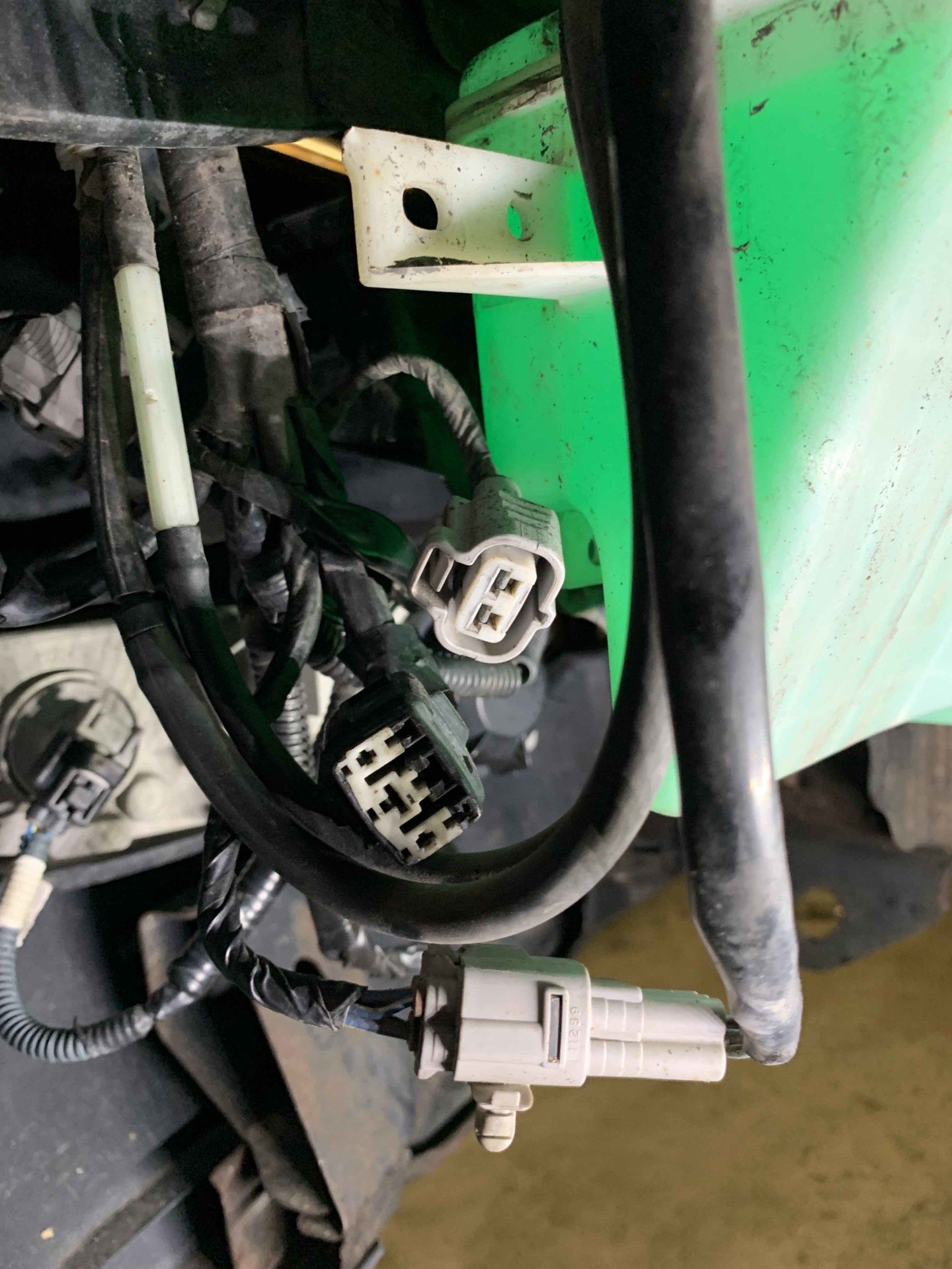

There is an unused connector in a wire loom under the battery by the drivers for light. It is super corroded. No idea if that has anything to do with this, butt seems like water and/or battery acid caused this.
Still testing stuff.
What is this crusty unused connector for? Can I remove/replace?
Large blade-type inputs make me think it's for a connector like headlights, foglights, ???
Maybe the unused connector is for a headlight washer?
Maybe?
My fogs are plugged in and work. They use a smaller connector.
No similar wire bundle or connector on the passenger side, only the crusty ones on the driver side.

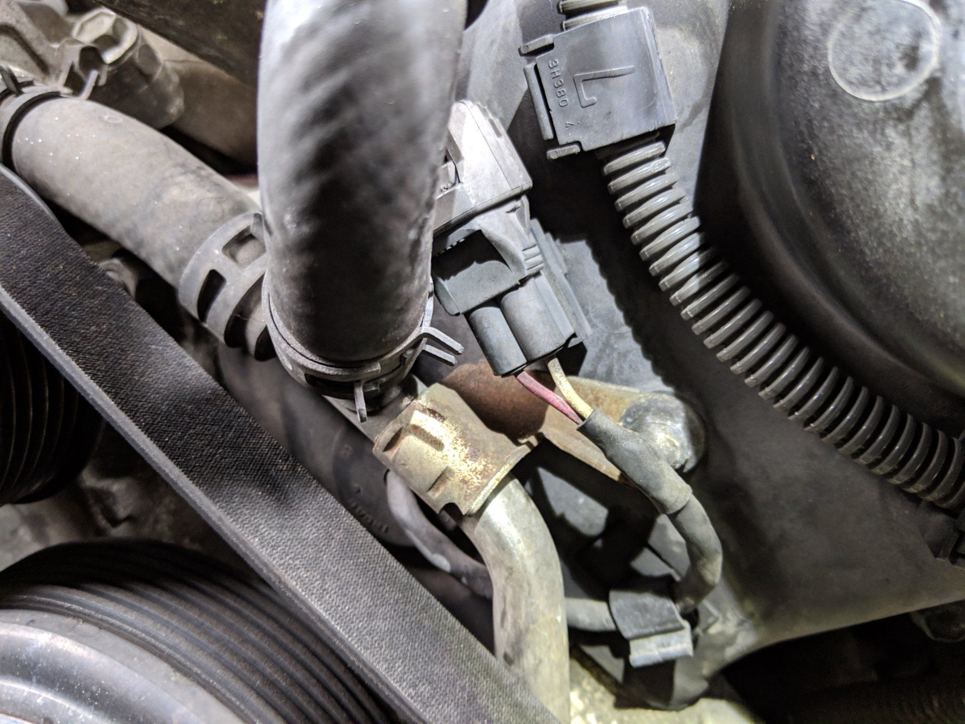

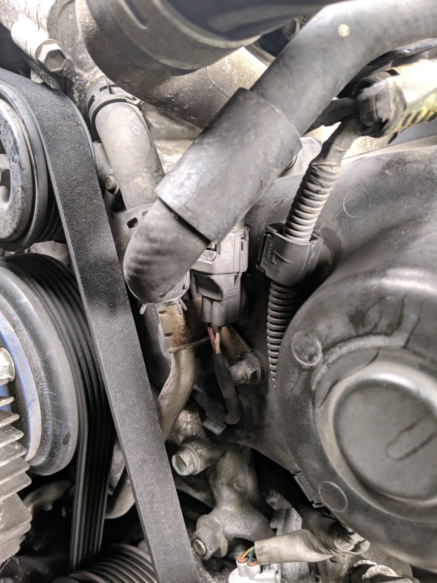

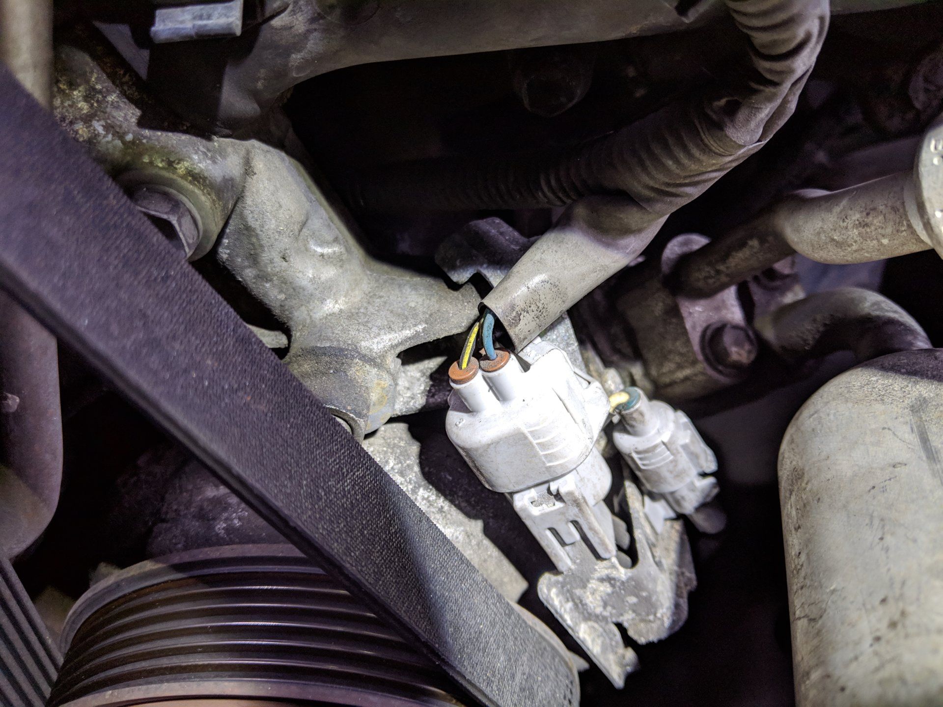

Are these the wires / connectors everyone is talking about by the belts? Mine seem fine and nowhere near the belts. Not sure how to pull them all the way out to check.
If I am not wrong this black connector could be the one which plugs into AC condenser relay. I believe 98-99 had condenser fans. Bottom picture is what mine looks like, I just bought a relay and will try to plug that in to fix my condenser fan problem. It stays on even if I turn off the engine.
1968264
If I am not wrong this black connector could be the one which plugs into AC condenser relay. I believe 98-99 had condenser fans. Bottom picture is what mine looks like, I just bought a relay and will try to plug that in to fix my condenser fan problem. It stays on even if I turn off the engine. View attachment 1968264
View attachment 1968152View attachment 1968153View attachment 1968155
That's the one, and that looks fine.
