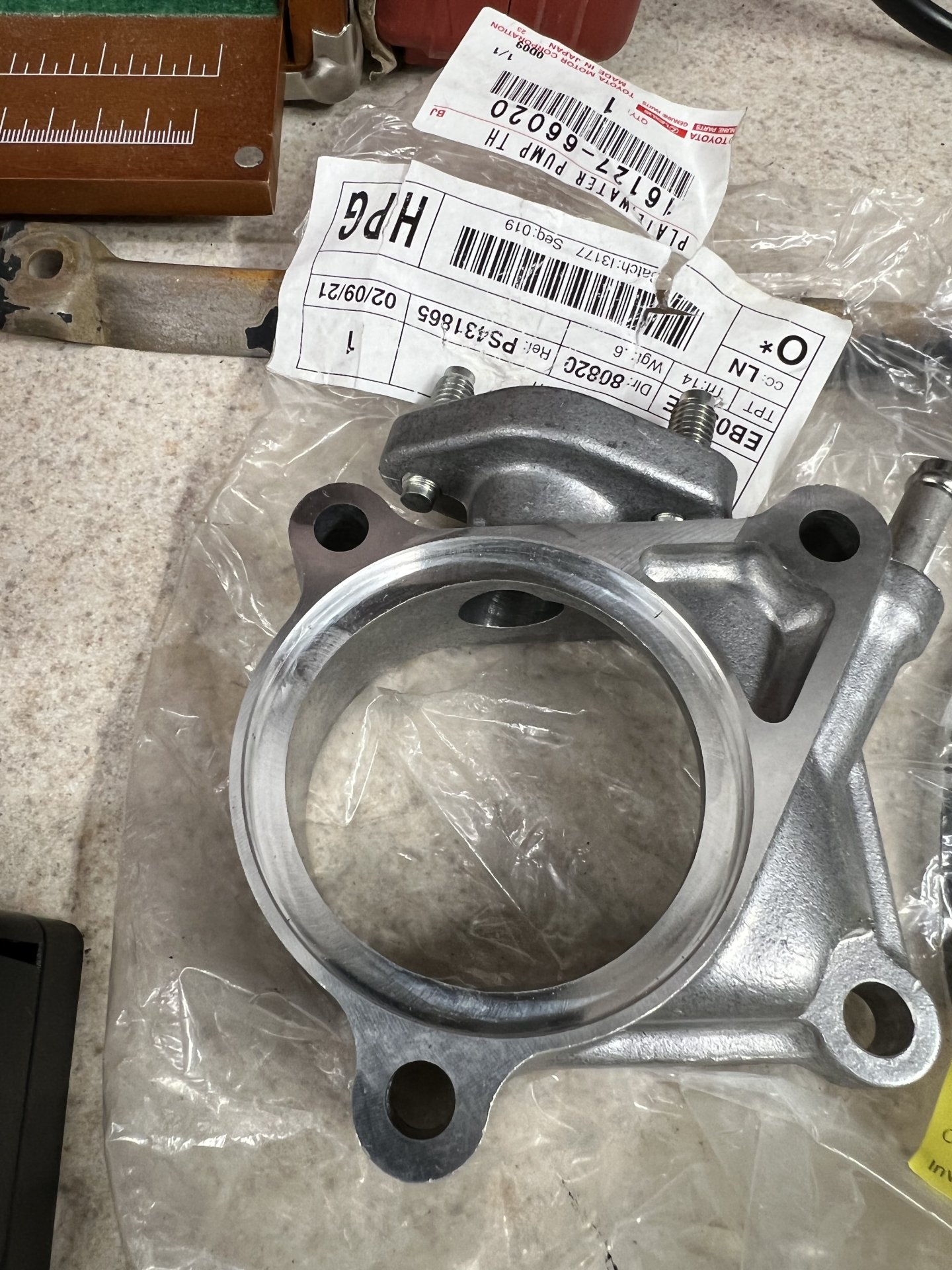

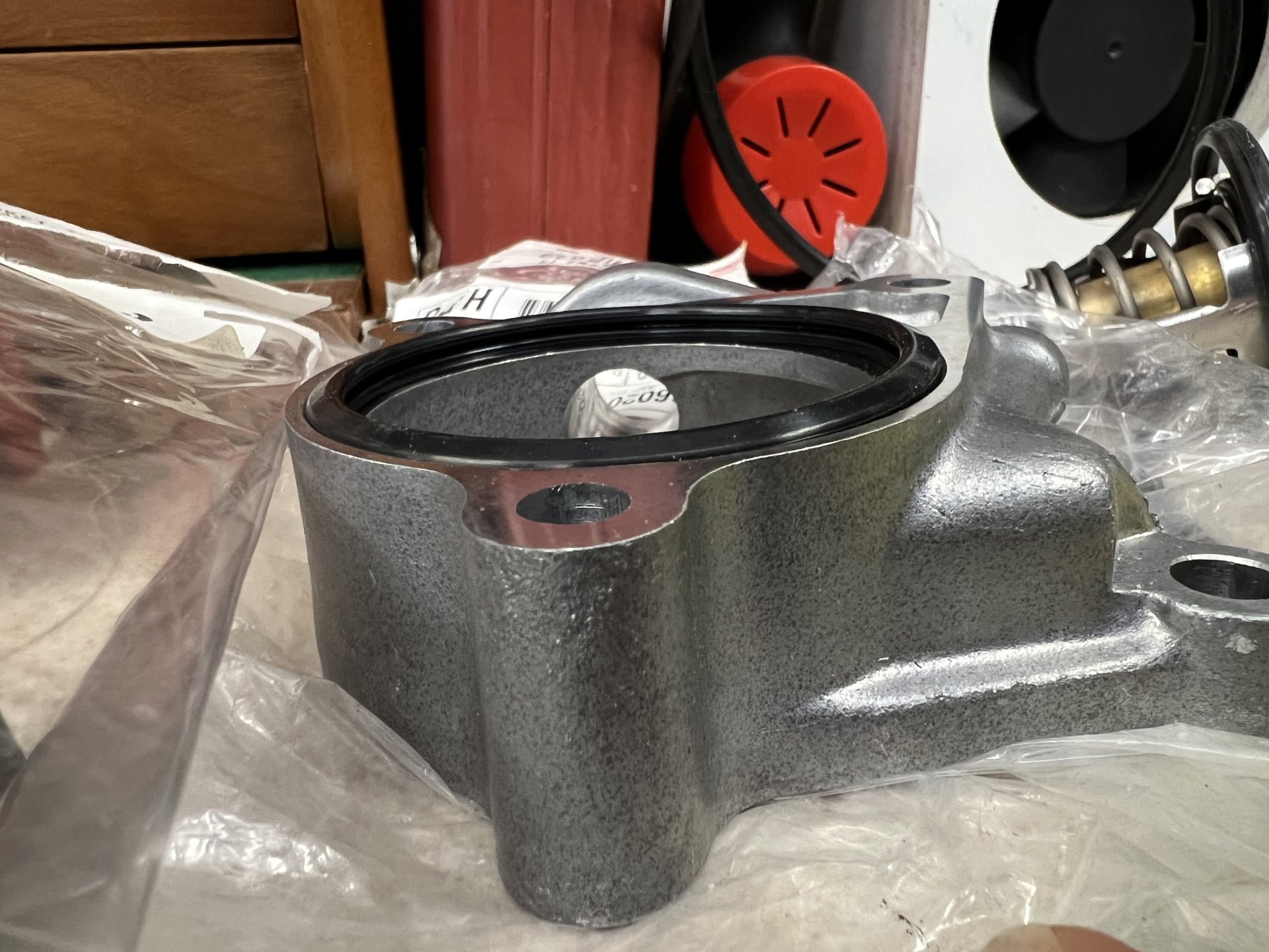

Can’t get thermostat back in housing without leaking. Edit: got tstat in, bit running at <180f
My guess is there’s a bunch of rtv blocking you from seating the oring.

So it turned out the old seal was stuck in the housing so I took it out and the new tstat fit in fine. This is the second time I've missed something like this and turned a half-hour job into a half-day ordeal. Oh well, that's how it is when you're inexperienced I guess.
After starting it up, the temps got right up to 220f, so I shut it off and after letting it cool, added some more coolant (murt've bled itself a little).
Now it's running at 177.8f, when it was 190-205f before. Is this normal?
