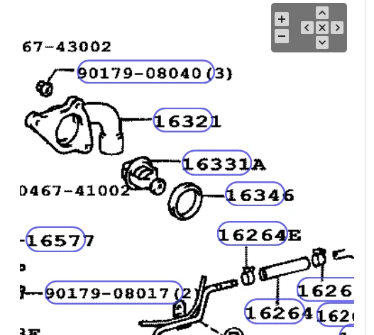

The o-ring has a groove around the inside surface and it fits around the flange of the t-stat.
If that's what you are doing, and it still doesn't fit, are you sure you have the correct part number?
I've had mine off about a million times flushing the system to get rid of the rust. Is your pic how you're inserting it? Each time I've placed the thermostat into the block side and then slid on the input piece. Make sure it doesn't get unseated and slide down where it'll pinch/leak when tightening. Also make sure the jiggle pin is oriented correctly.

Also in the pic it looks like part of rev gasket is visible on the top of the housing: is this incorrect?
OEM thermostat and gasket insert into the circular cutout on the block/output piece perfectly. Not supposed to see the thermostat gasket when it's buttoned up.

The T-stat with gasket should plug into its hole on the block, its a snug fit. Then the cover compresses the gasket. You shouldn't see any gasket, its all contained in the counter bore under the cover.
