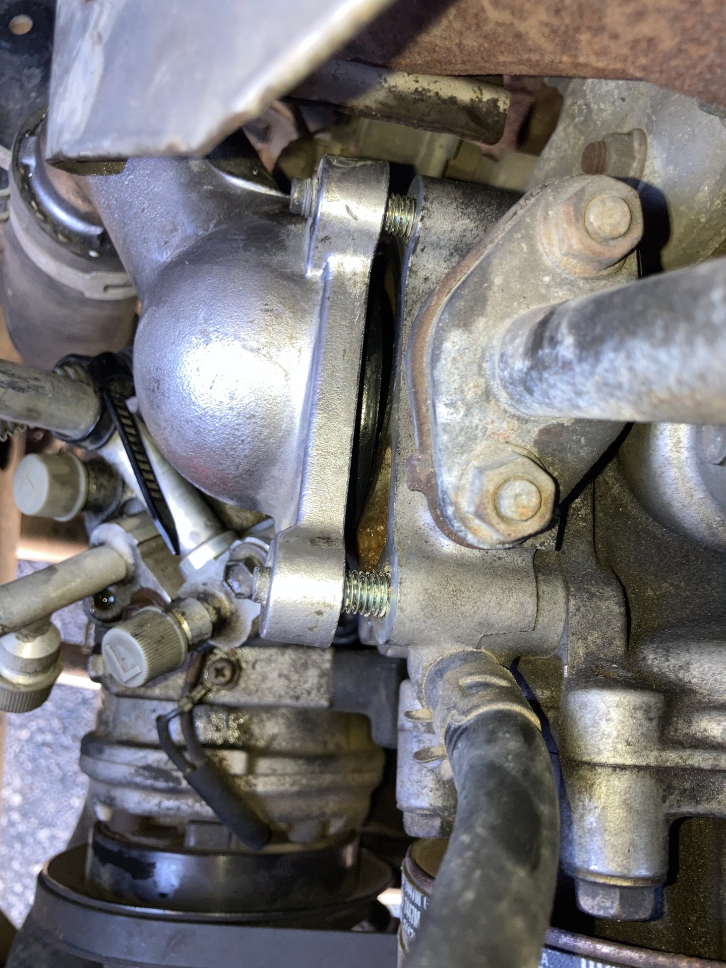

Can’t get thermostat back in housing without leaking. Edit: got tstat in, bit running at <180f

The oring I had might be damaged beyond repair at this point. Maybe I can just reuse the RTV stuff that was in there? The OEM oring seems surprisingly hard to get ahold of for such a simple part.
Get right OEM stuff at the dealership. They still sell it. Should eliminate whether you have the right parts or not. Share your vin # with them.

I did order a new o-ring from the dealer. I was able to confirm AISIN THT-015 was the right thermostat in the thread above, so I think I'm ok there; it might just need a little more encouragement to get in the housing.

I put the or O-ring around the disc part of the tstat but couldn’t fit it snug back in the housing this way. When I started to refill it started leaking out the bottom of the housing, where part of the oring was sticking out.
Is the oring supposed to be installed this way, and/or is it really necessary at all? The old tstat didn’t have one I don’t think.
I’d appreciate any help getting this to seal.

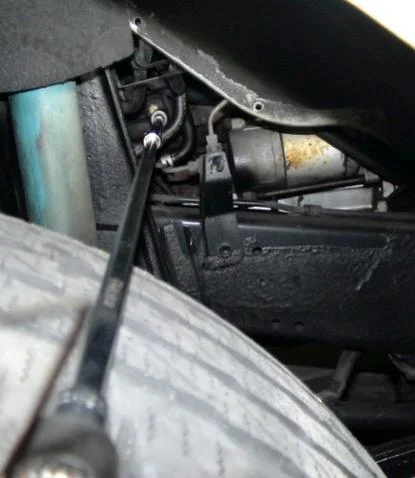

i personally would use the BLOCK drain for this particular situation , it lower then the thermostat housing too
attach the 5/16 clear hose to spout on block drain into bucket NO ZERO coolant loss on the ground or on you either
I did drain the block earlier. It seemed hard to get a hose up in there though. I don’t have any 5/16 hose if that’s the right size for the petcoxk and/or block drain though, only 5/8. Might have to add that to the list.
