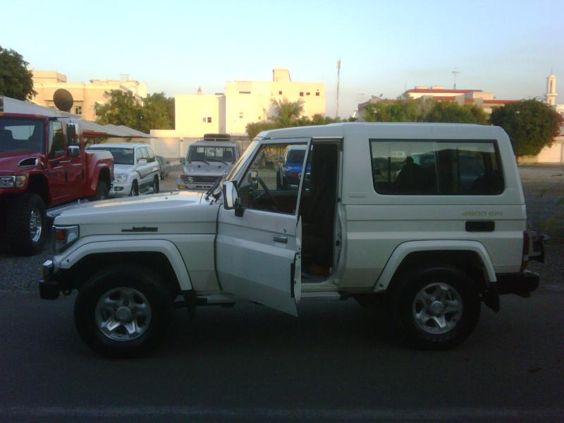

Hello All,
I was after a short wheel base 70, they are excellent of road and popular over here.
Then I came across the truck pictured below, it belongs to a friend who takes excellent care of his trucks but its a medium wheel base model (MWB).
Ive been trying to do some research on it but there is little information out there. so, does anybody know what it is and how well it performs off road? any info would be appreciated especially if one of you has actually wheeled one of these.
the engine is a 4500 EFI, gasoline.
It is a FZJ73...
73 because of the leaf springs front and rear (74 has coil springs up front)
and FZ because of the 4500efi on the side... :)

It is a FZJ73...
No, I don't agree, it is an FZJ74.
Should read...
'74 because of the coil springs front and leaf springs rear (73 has leaf springs up front)'
I see radius arms under the front of the doors, and no leaf springs sticking out in front of the tyres, therefore coil springs.

the 5 wheel nuts lets you know it has coil front and is there for a fzj74
fzj because it has a 1fz-fe motor
these motors absolut hammer offroad, compared to the diesels and early 3f petrol motors, i have one in my 79 series it gos well ,so a MWB should go even harder
