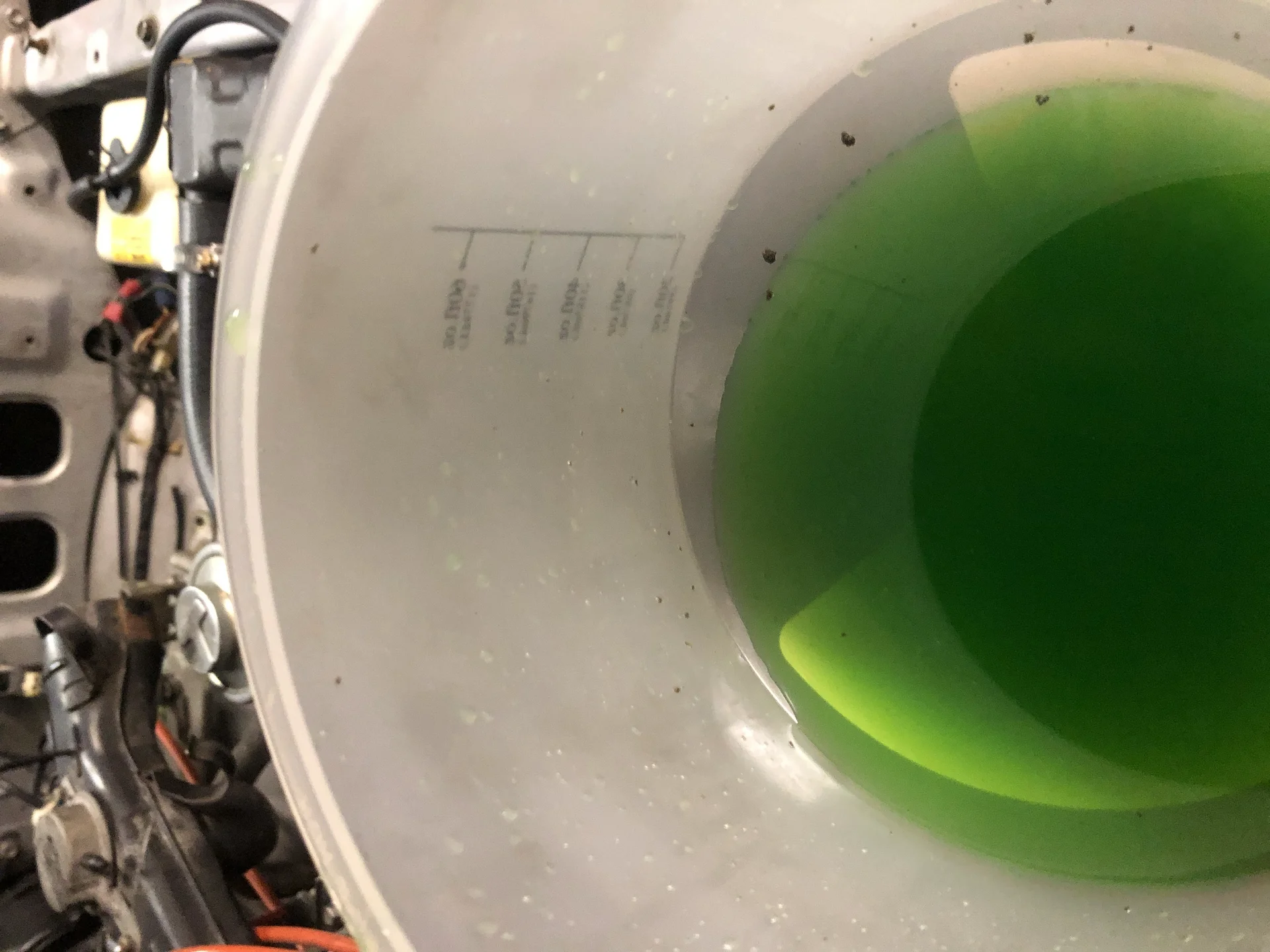

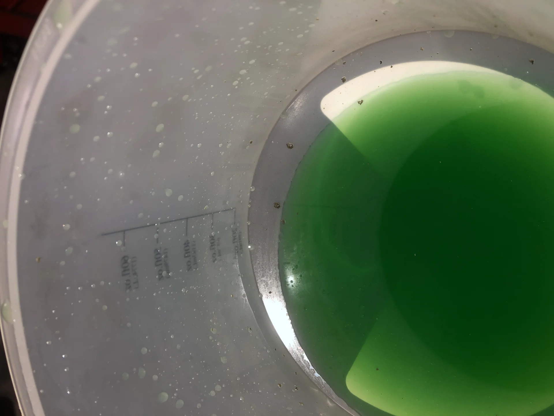

on the subject of flushing the system, i just had an engine rebuild, but am noticing these weird specs in my coolant (this is a photo of a funnel attatched to my radiator). im wondering if this is from my radiator or what?? are these specs consequnetially or indicaive of something?
Maybe some debris got into the coolant passages during the rebuild? Could be some loose iron flakes from within the block.
Possible, I assume they flushed the block? the truck sat for a year and could have gotten debris in the lines I suppose.
