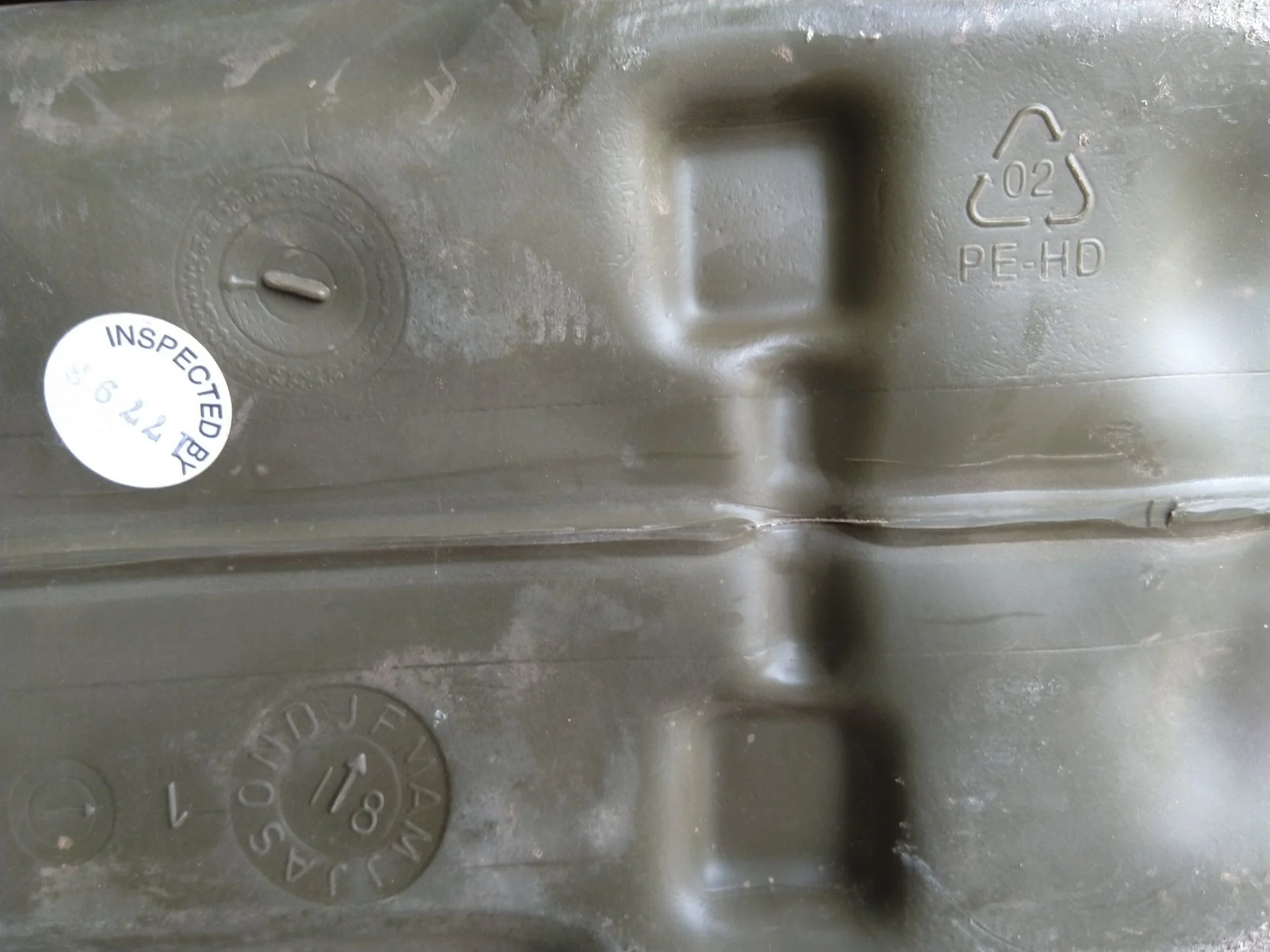

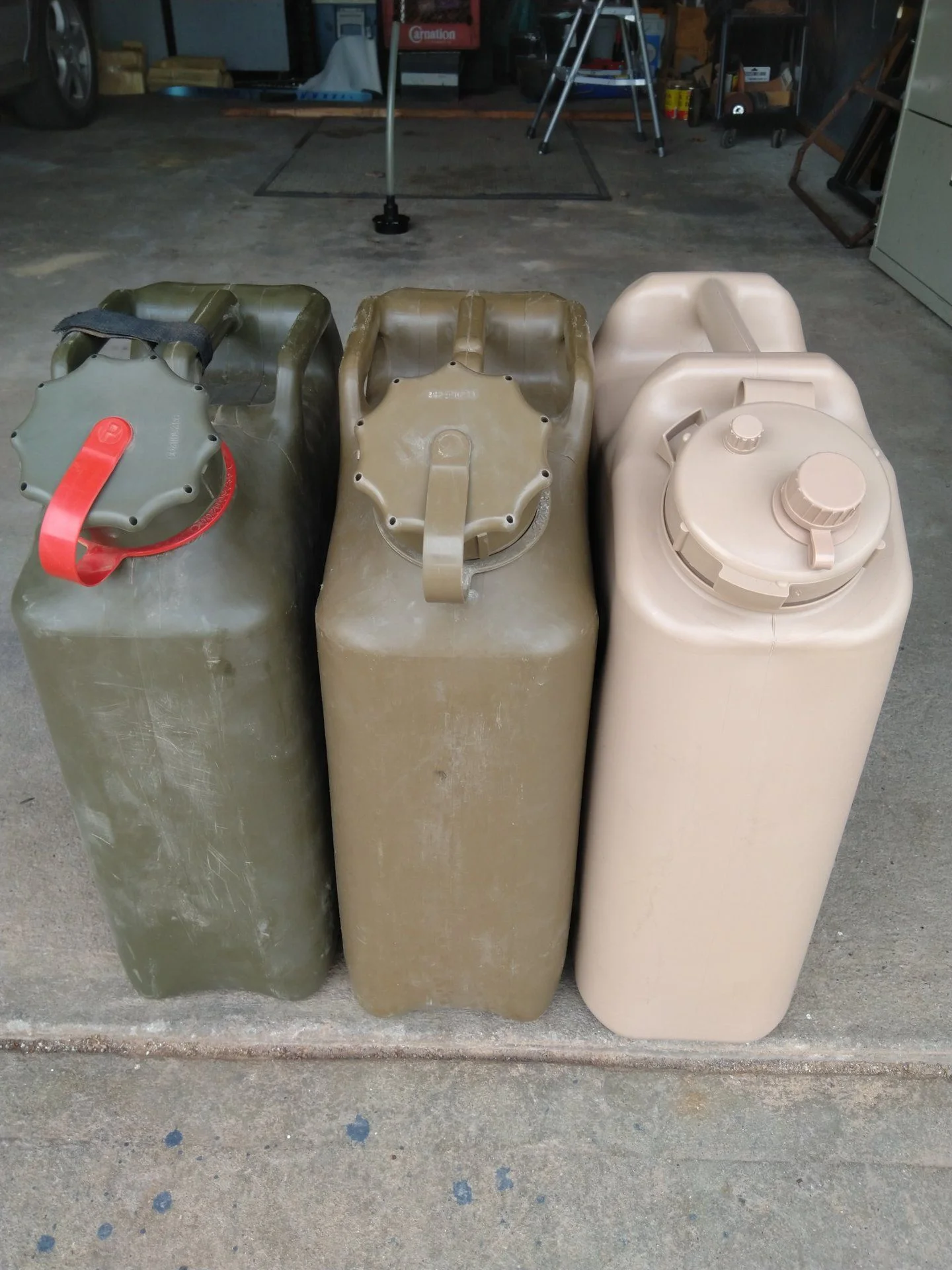

I rounded up what I have. Petrol sceptors are PE-HD (polyethylene- high density) triangle 2, diesel sceptors are HDPE triangle 2 (high density polyethylene) and the water sceptor is unlabelled but from the website is low-density polyethylene.
HDPEs have higher chemical resistance and higher melting temps than LDPE, therefore LDPE is not suitable for more caustic chemicals like fuels.

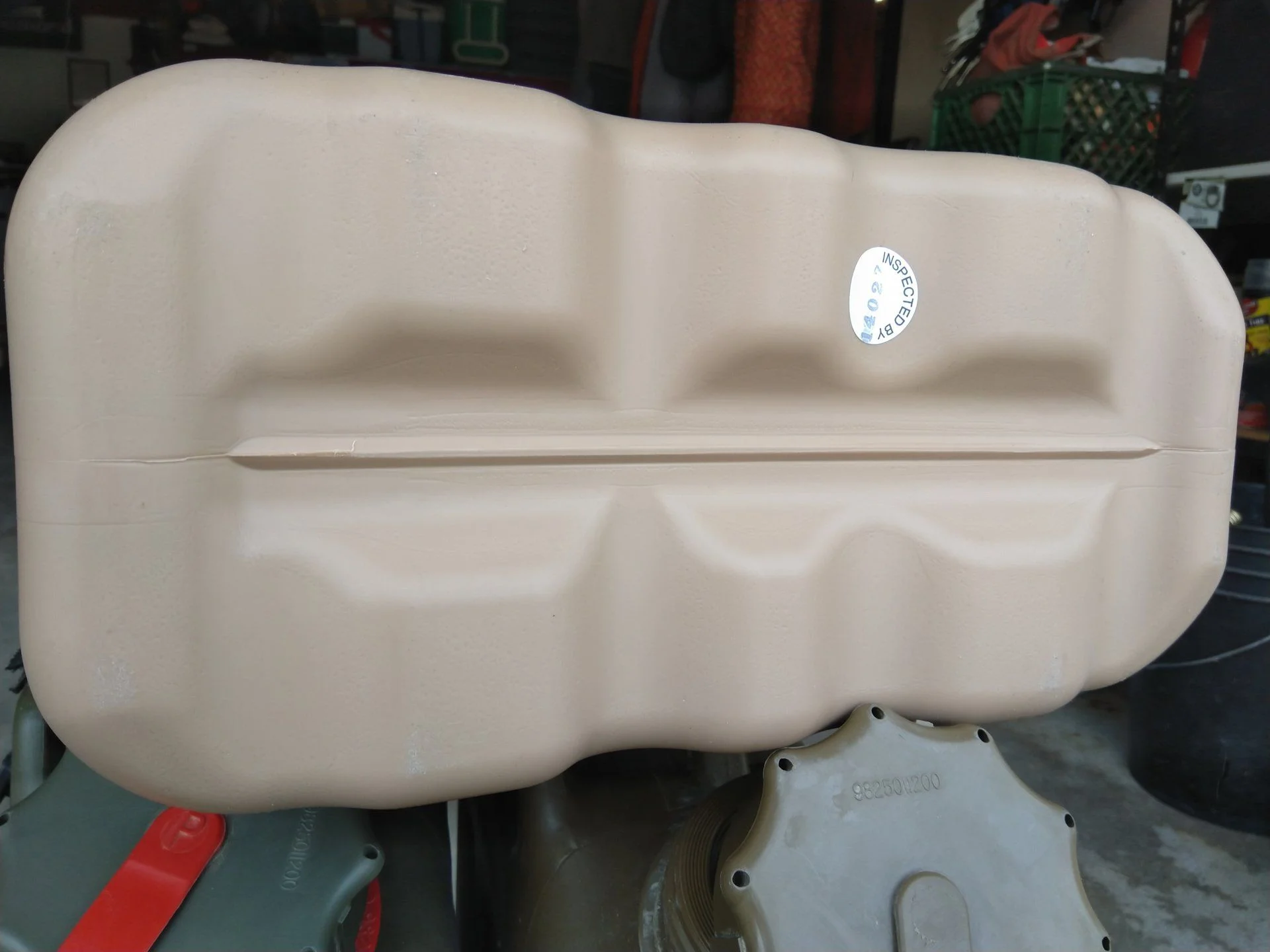

Water, no identifyiong markings RE: materials (The Scepter side designates it as LDPE)

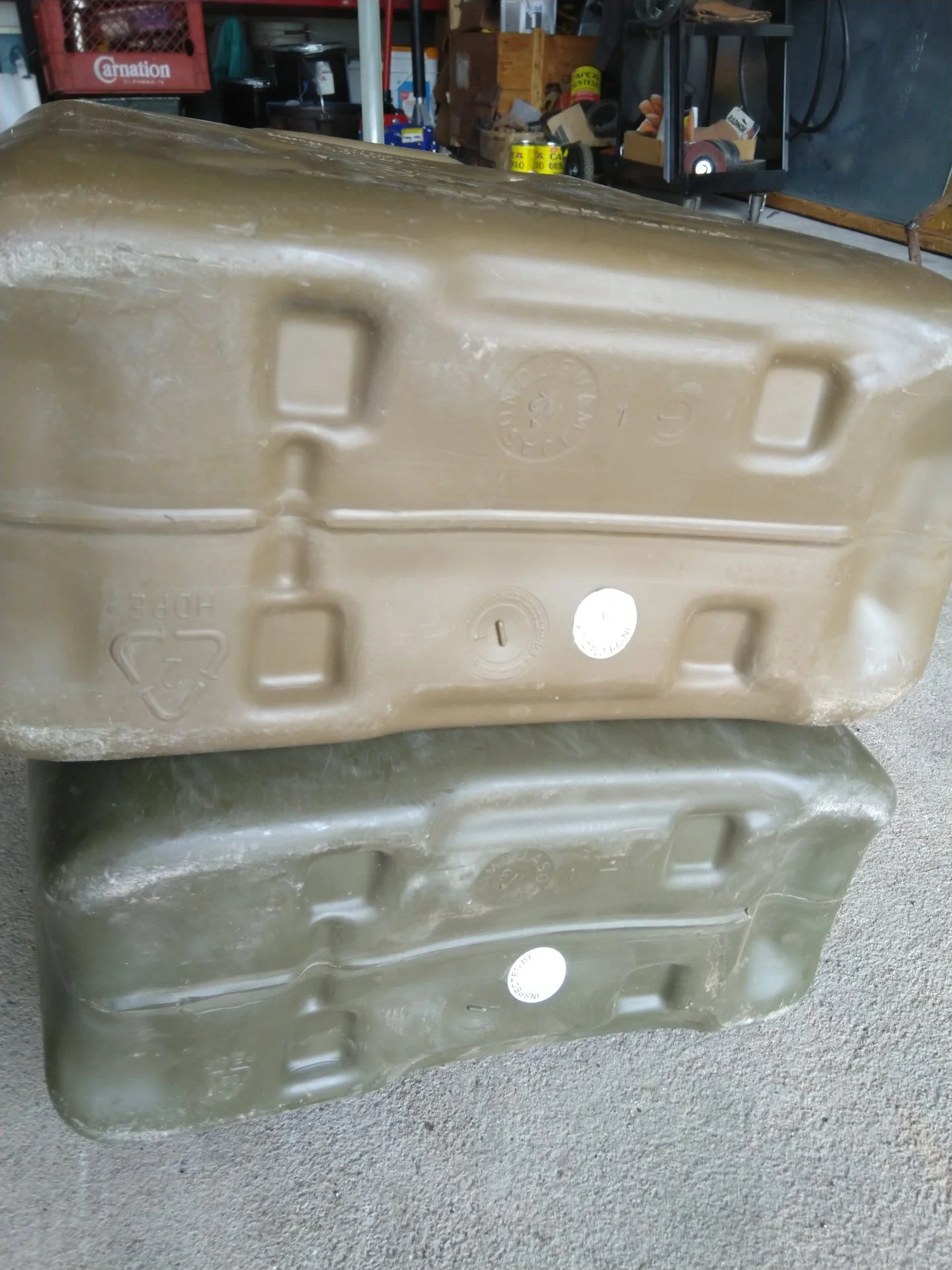

Diesel MFC top petrol MFC bottom

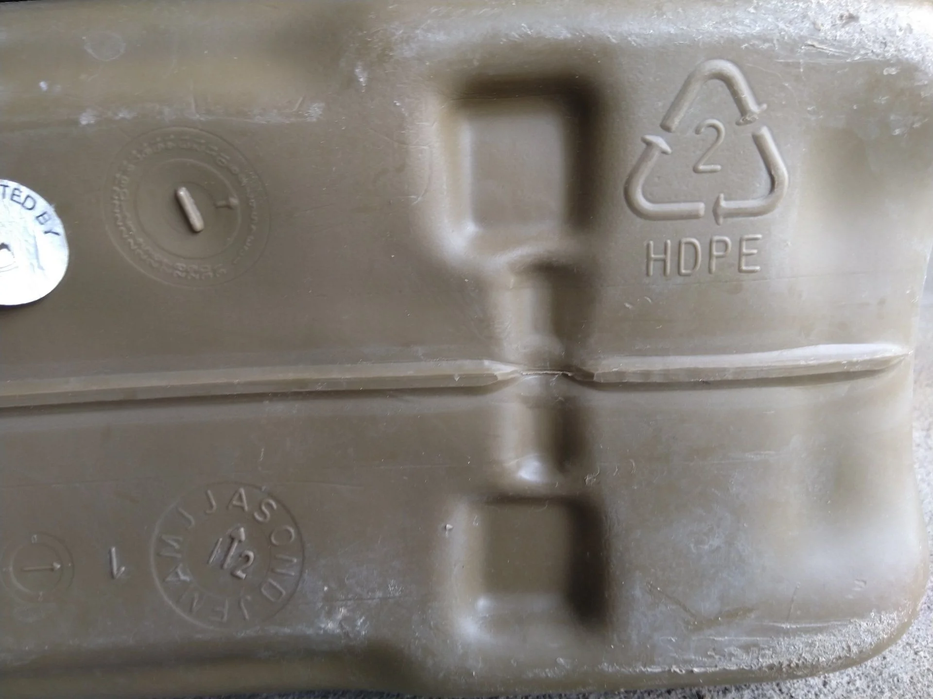

Petrol (gasoline) Polyethylene, high density (HDPE)
Diesel HDPE
