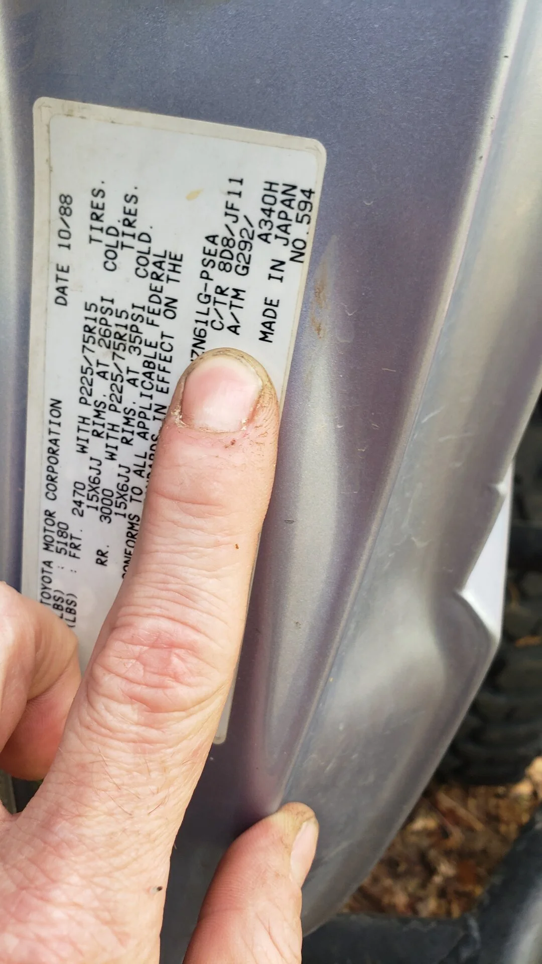

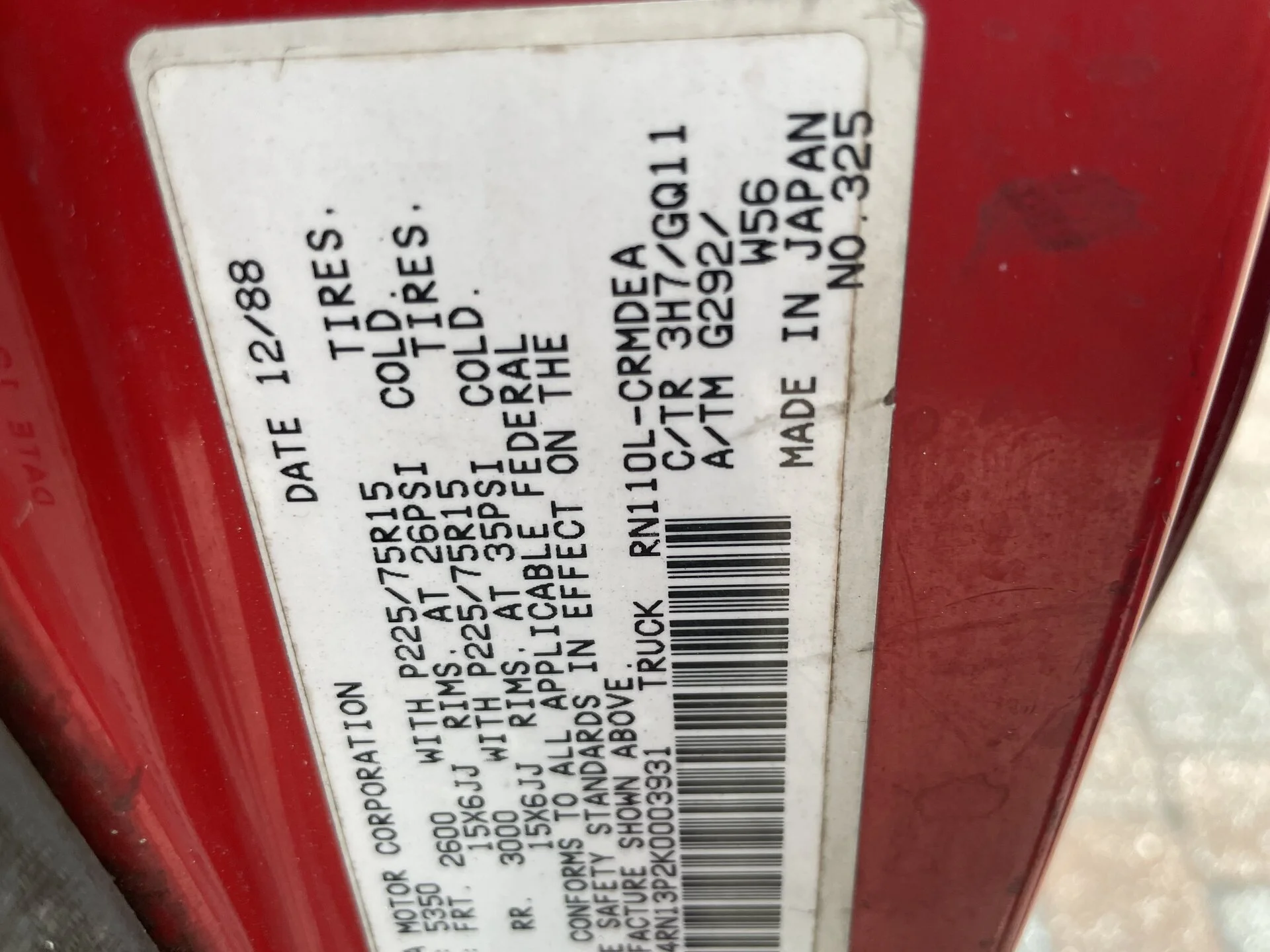

should show on the door tag as G292, G282 or i can't remember the other two.
autos typically are 4.30 or lower.
jack up one rear wheel, turn it twice and count ds rotations.
the door tag should also tell trans. r150 or A340
